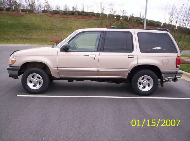

Swapping leafs packs from side to side will not accomplish anything but make it lean the other way or make it sag real bad. An add a Leaf will help some but you will still have the worn out leafs. One of the best mods/repairs I've done has been replacing the leaf packs with ones from an F150. I couldn't stand the rear sagging look, this mod gave it a forward tilt and looks much better.
http://www.explorerforum.com/forums/showthread.php?t=101035&highlight=F150+Leaf+Spring
It's a very cheap way to go ($40 total) plus it gives you much more load capacity and a few inches lift.
Here's a before and after pic.
Here's one with plenty of room for the new 31's
