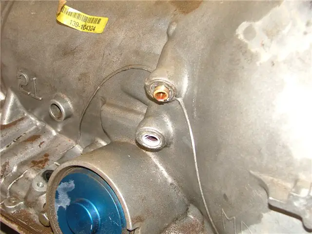

Transmission line broke off where it mounts near the top, with the threads stuck in the tranny. Broke because it was too close to the transmission hump and seemed to be rubbing for awhile. It will now have 45 degree mounting hardware which will keep it out of the way.
Transmission
