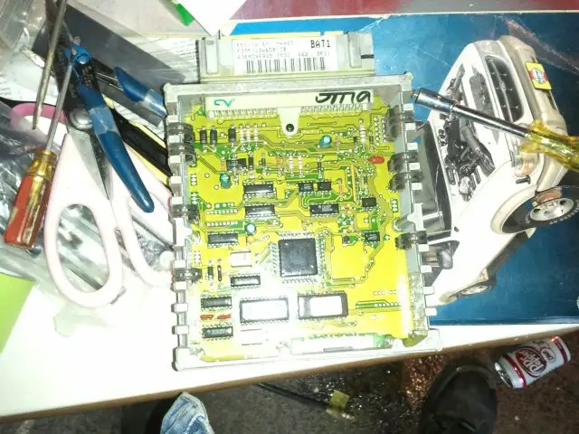

okie dokie here is one of the things yall suggested.
@Turdle, i kept the two links up, i yanked ecm out today, just now. took off cover and its all good, no corrosion, broken spots etc.
ever wanted to know inside of your ecm, here you go..

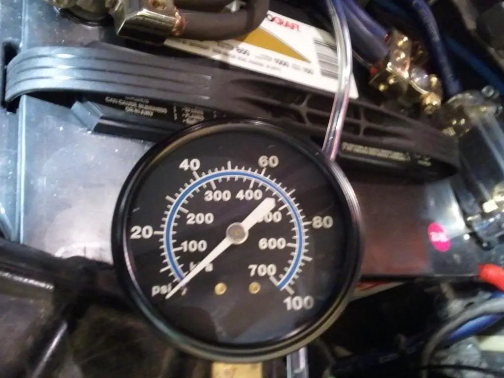

going out now to do pressure check w/ new pressure test kit
Ok, forgive my concern. This is not the first " raw fuel out of driver side exhaust manifold" issue. Dannyboy fought this issue, might look into his thread about it.
Also, when I had our 93 I had to go through several engine harnesses to find a good one. One of the bad ones had bare wires in the fuel injector wiring, it looked like an area where the harness rubs as it goes under the alternator--if this makes any sense.

Well here is the pressure update.
Car Off Key Off 0 PSI
Key on Engine Off at Prime stage 34 PSI
Engine Running 30 PSI
When Goosing it, it goes to 40-45 PSI

thats a good thing at least. i read Dannyboys "Fuel Pressure- Low key off, okay at idle" if my pressure was/is fine, then low pressure wouldnt be a problem
another question... if my test are ok, what all does that eliminate?
The smell of gas would could indicate a fuel leak. I didn't see a leak down test described in your fuel pressure test. Does the fuel system hold pressure when the pump is shut off? If the system holds pressure, that suggests that there are no leaks between the fuel rail and the pump on the supply side. This can't tell us if there is a leak in the return line.

It held at the shut of psi until i pressed the relief button. It held for at least 10 mins, I finished up and smoked, it held the whole 10 min cig (i know safe to smoke while messing with gas :D)
It held at the shut of psi until i pressed the relief button. It held for at least 10 mins, I finished up and smoked, it held the whole 10 min cig (i know safe to smoke while messing with gas )
That right there is a leak down test. So, if there is a leak in the fuel lines, it doesn't appear to be in the supply line from the pump to the fuel rail.
