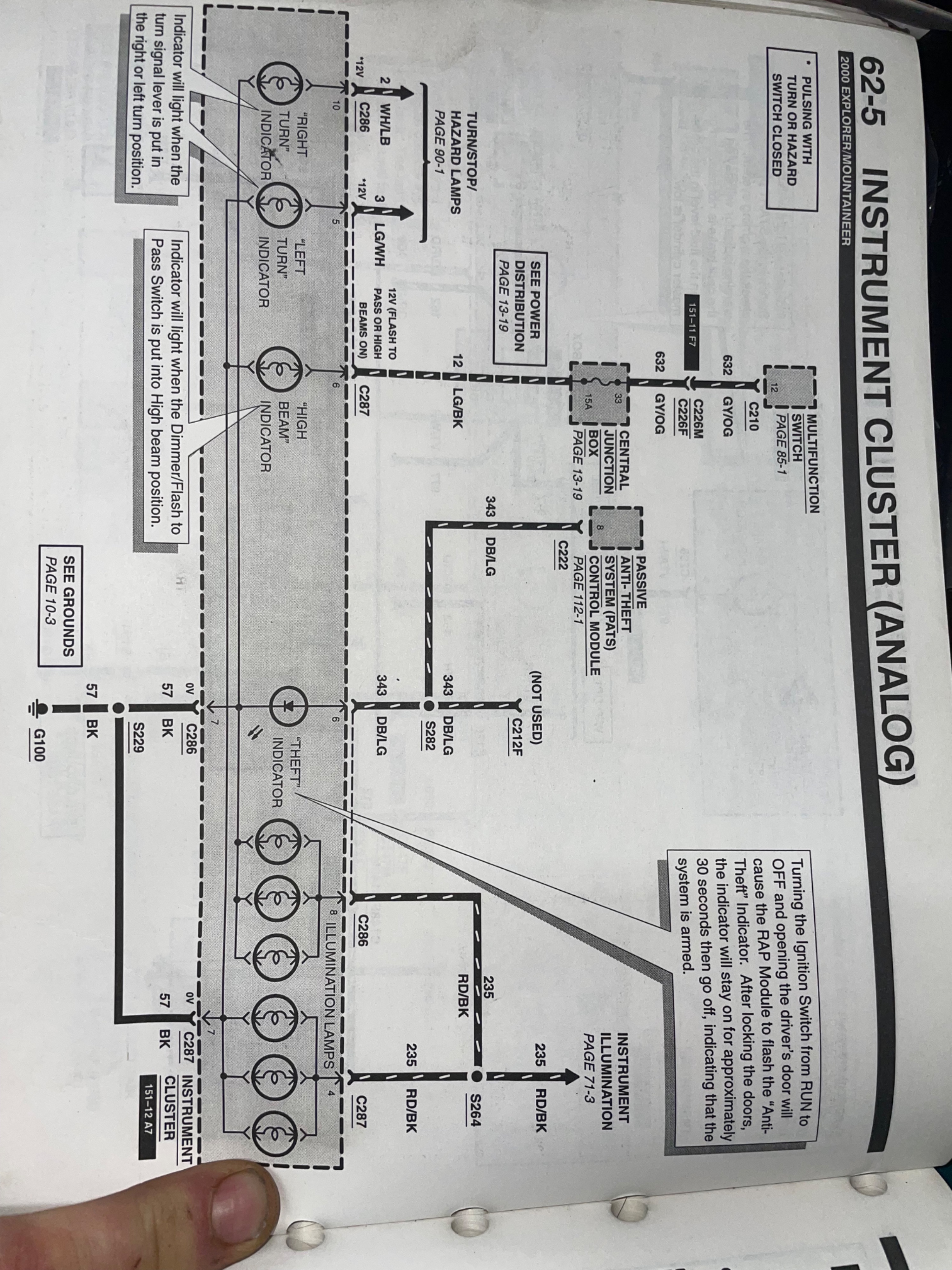

The theft light is controlled directly from the pats module in 98-01 explorers there is one wire directly from the module to the instrument cluster

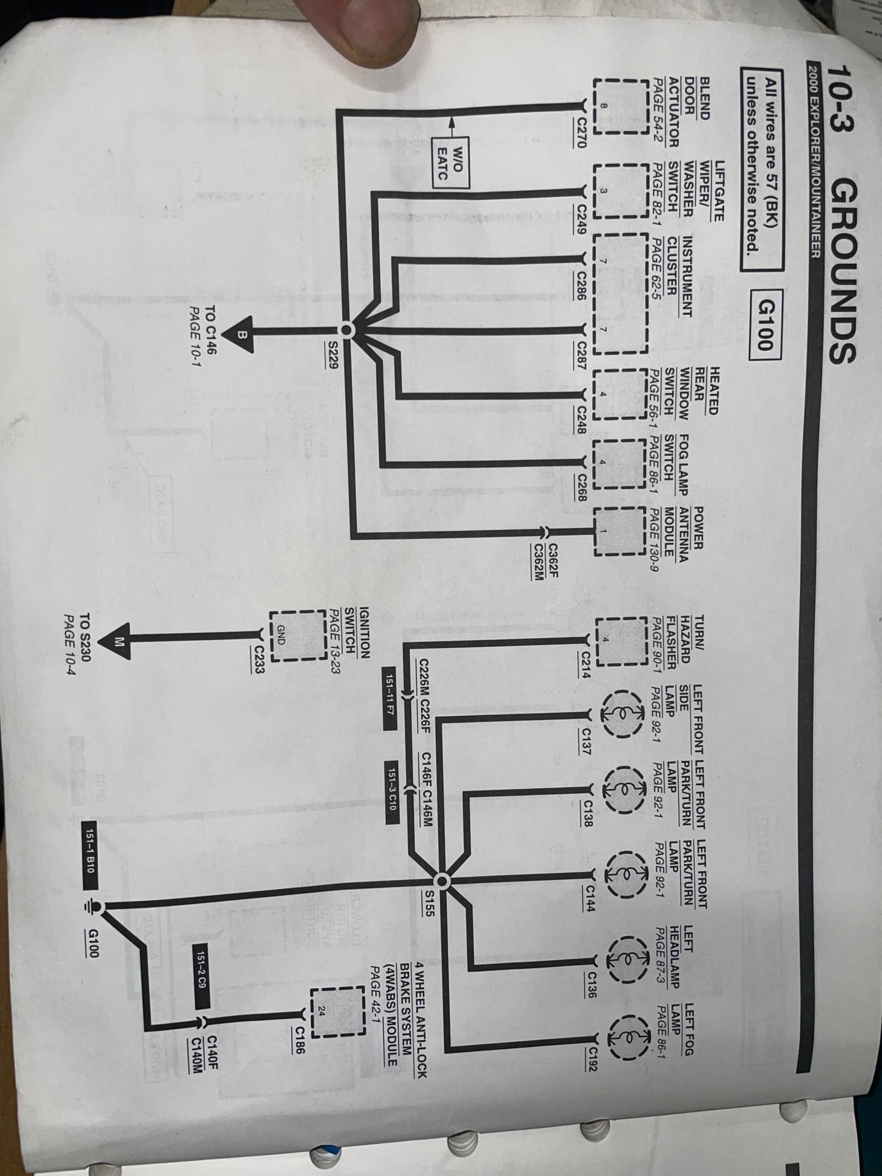

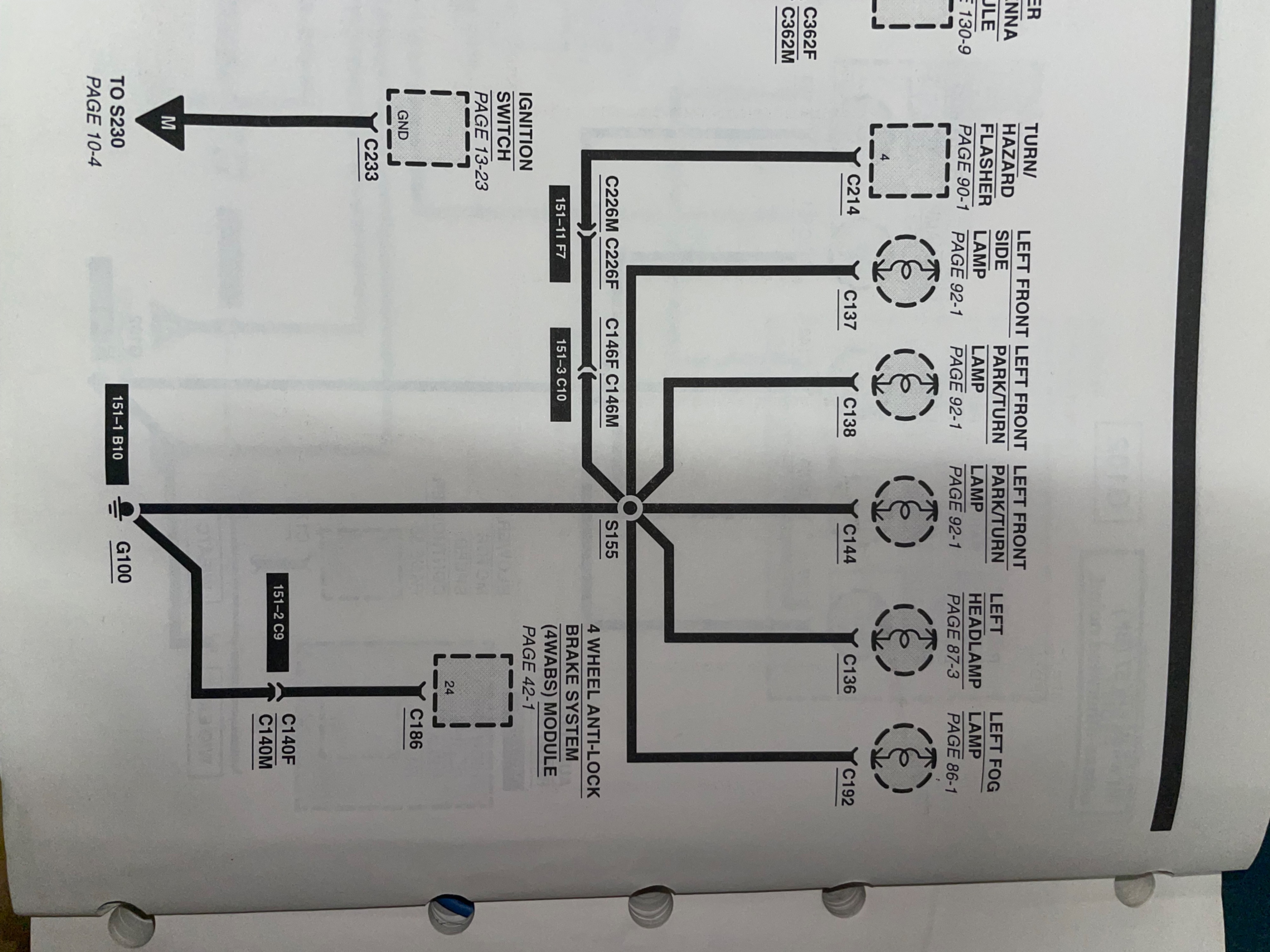

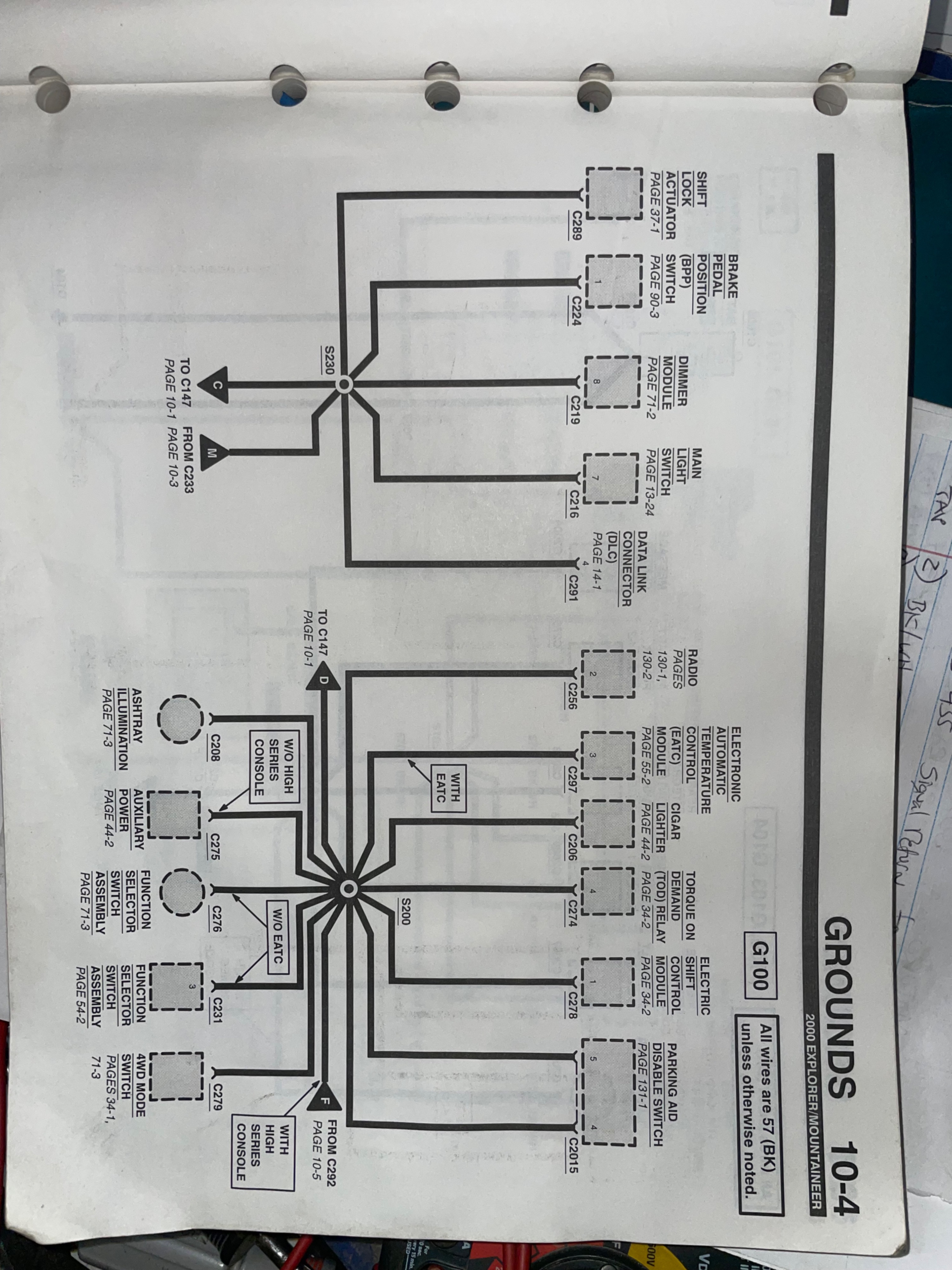

G100 is a main ground many many things ground here
G100 is 3 pages in the wiring
Book
The theft light in the instrument cluster is activated by one source, one wire. as far as I have ever known? Pretty familiar with the 98-2002 pats system with the module behind the passenger airbag

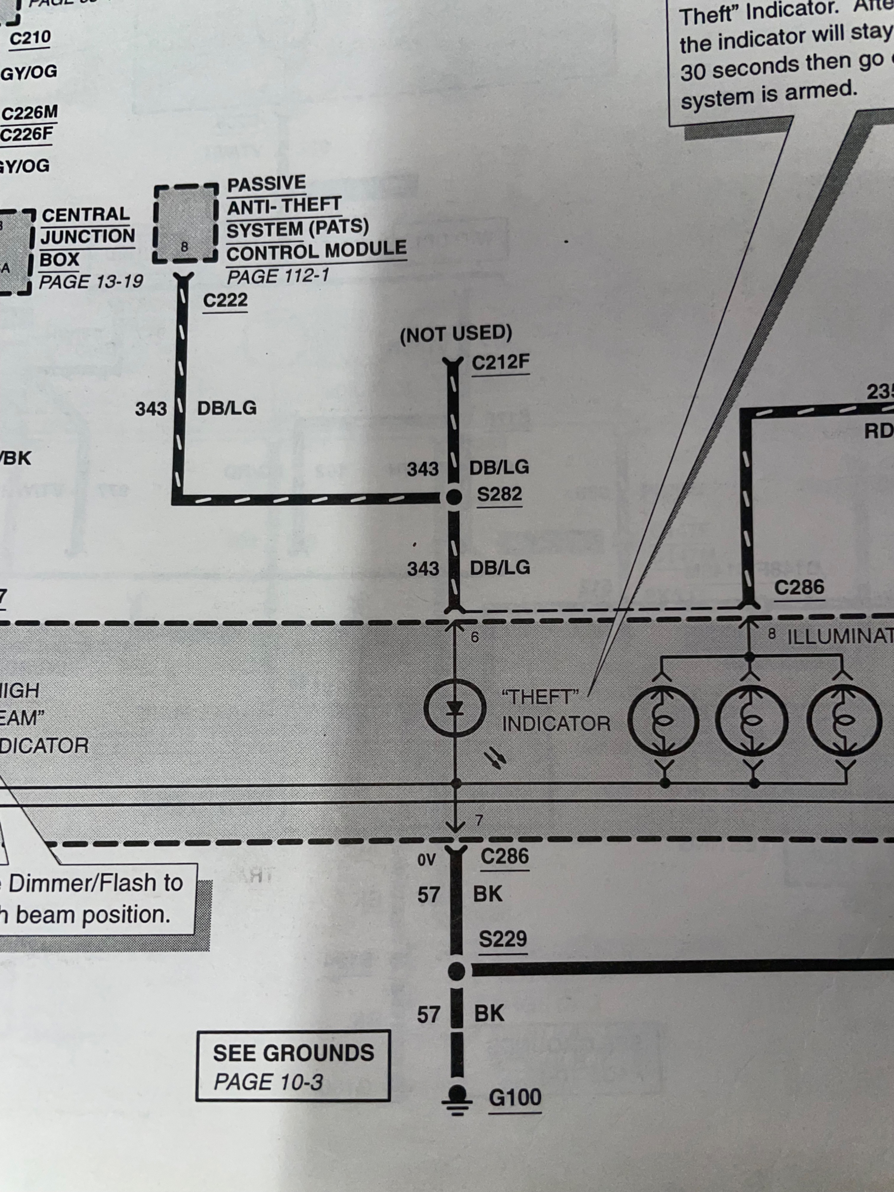

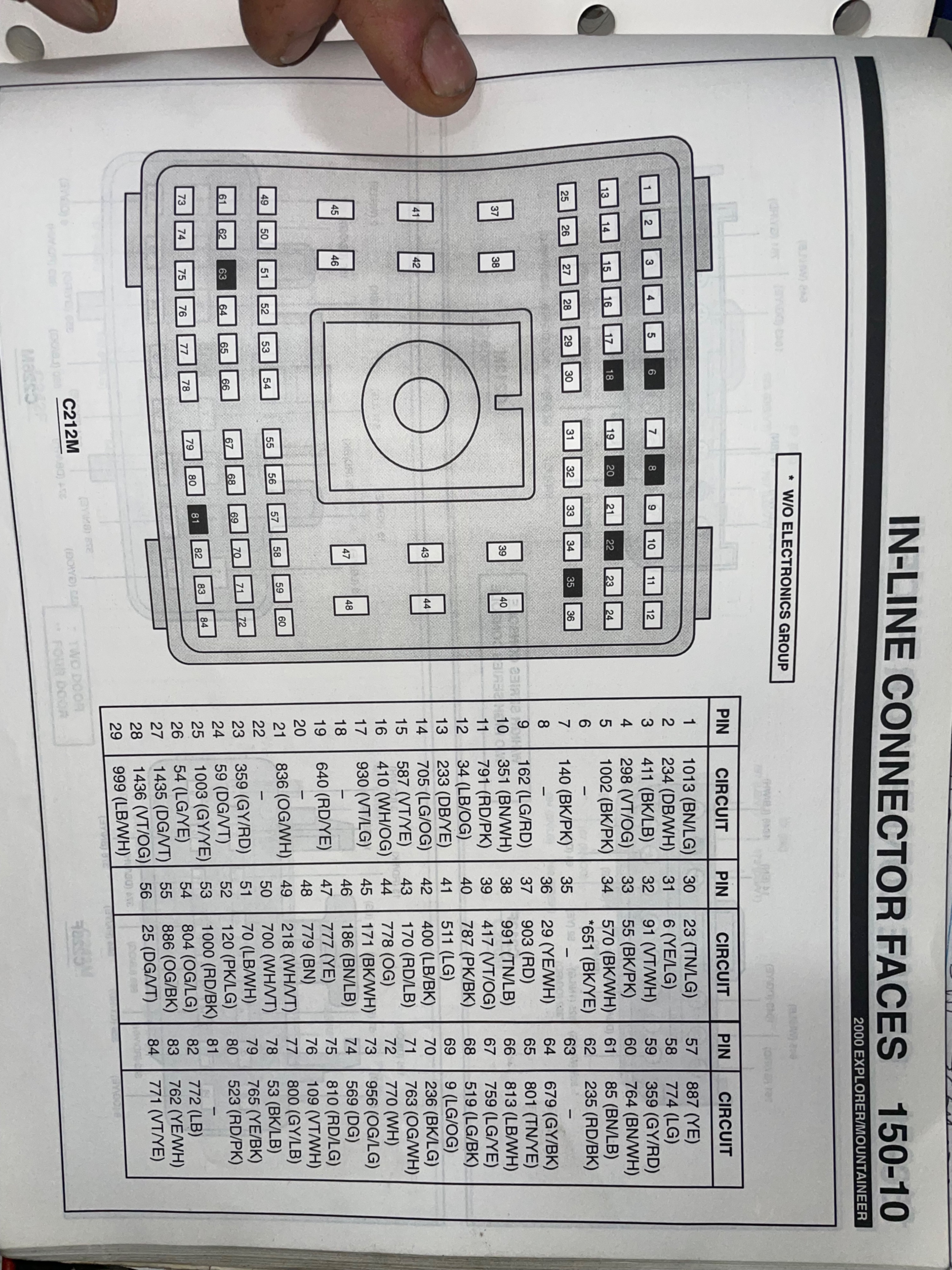

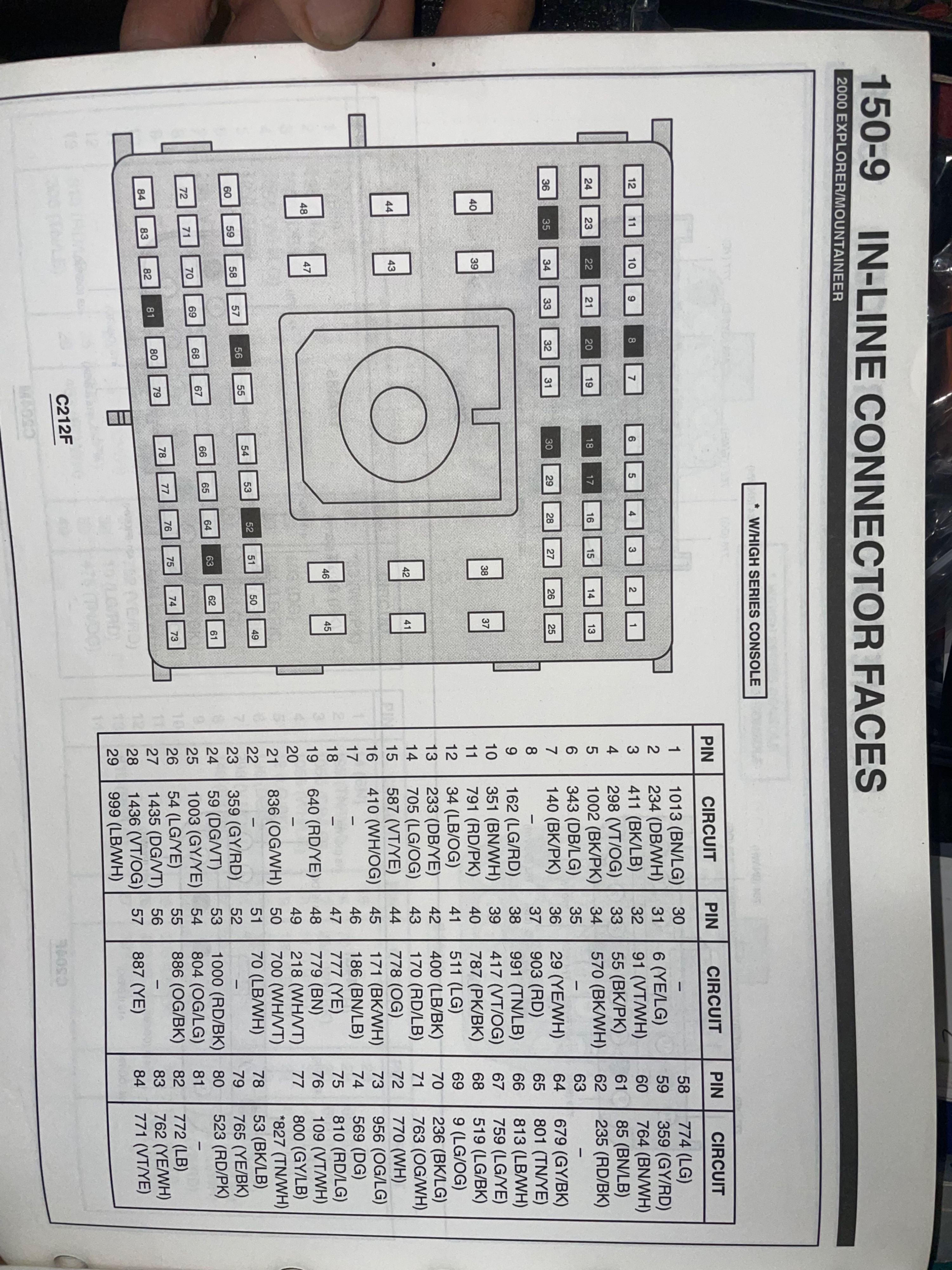

Connector c212 m and f pictured
You can see circuit 343 dark
Blue with light green pin 6, dead ends?
Likely done in preparation for the next generation of pats (pats e I believe) where the theft light is activated by the pcm and there is no module behind the passenger airbag
C212 is a bulkhead connector from dash to truck buried up inside the dash
