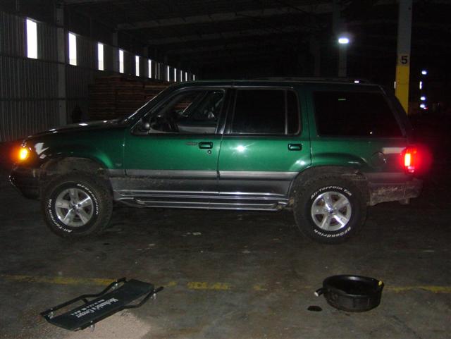

First thing this morning, no rear lift-
Done with rear lift
Front Shot (notice the nice flat cv's)
Rear Pas Side-

Nice! Turned out waaay better than i thought it would. Now have you drove around and slammed on the brakes to see if anything breaks? Also, did you use locktite on the bolts? (i know these are elemantary questions, but that is a really nice mounty)

I haven't driven it much because I don't have shocks yet. I drove it some around in the lot at work. Inside the building I bounced everything around, slammed on the brakes, hit the gas etc. Nothing seems like it is going to give me any problems. Everything seems ok as far as I can tell. I used nylon lock nuts on every bolt I put on, and locktite in places I wanted to make double sure.

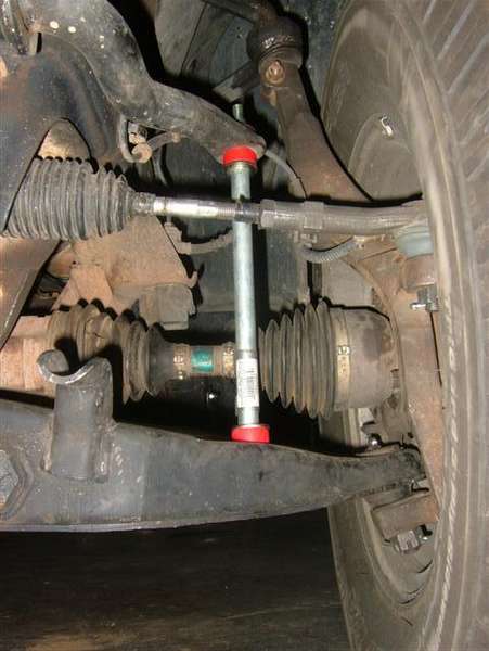

I made the sway bar links myself for about $25. I used 3/8" all thread and an energy suspension bushing kit from auto zone. The middles are made of 3/8 galvanized pipe cut down to 9". It works as far as I can tell, if the all tread gives, I will find some grade 8 bolts to replace them.
The rear sway bar works as is, but limits travel. For the time being, I will run it stock. I have an idea to relocate the bushings that attach to the axle upward to fix the problem. I may start making the brackets fairly soon, they will be simple and straightforward.
