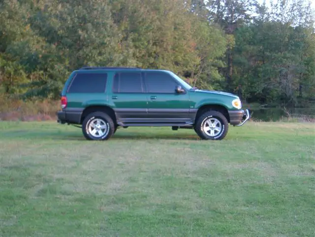

Here it is, all done-
Front fenders measure out 37 1/2" tall at the center of the wheel
