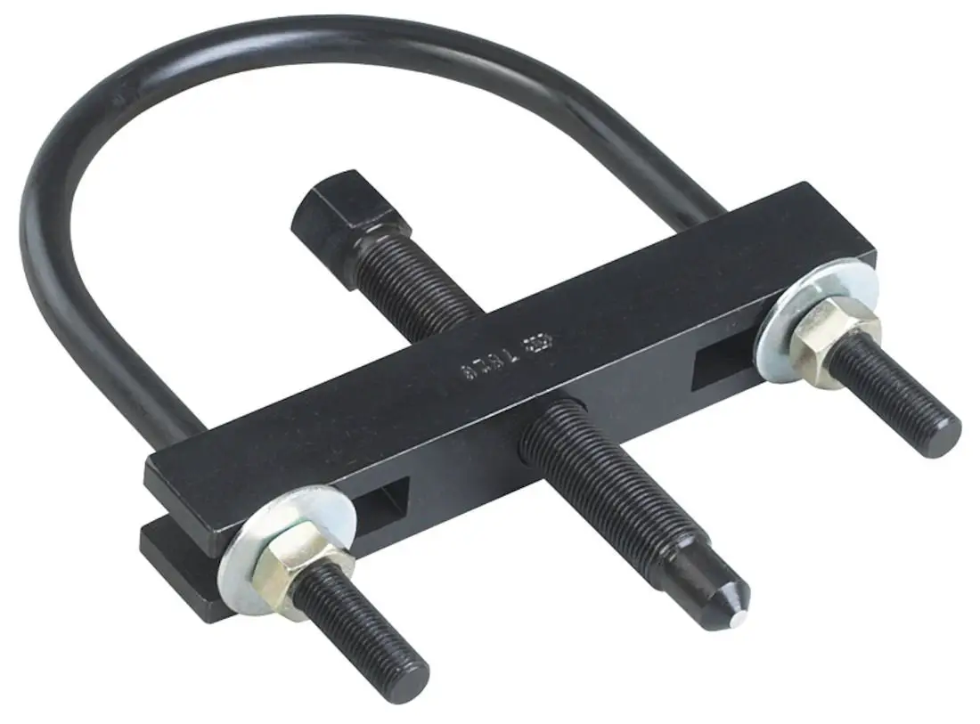

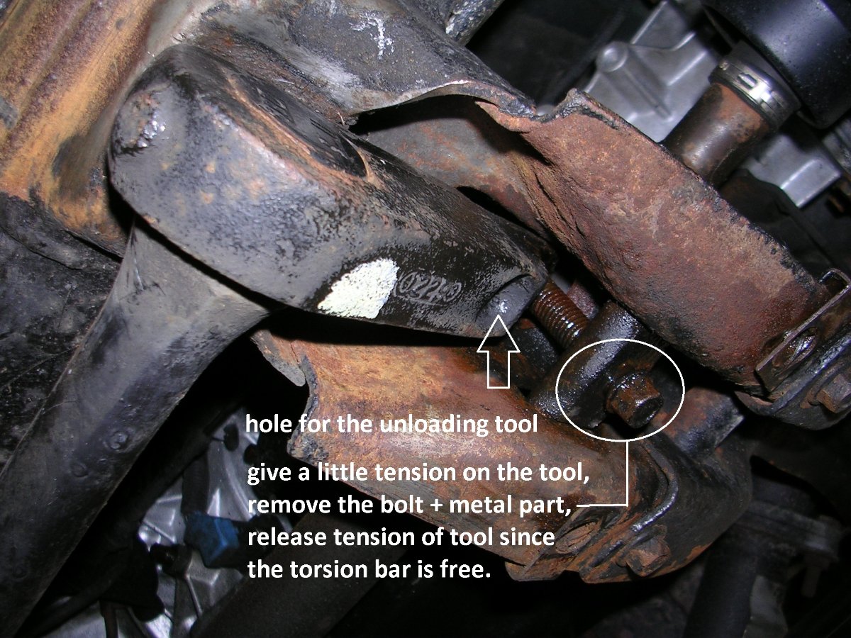

If you decide to change the lower control arms, the torsion bars must be removed. The rear end of the bars has tension bolts. Before you loose these bolts you must use the unloading tool to release the tension.
After that you have to push the torsion bars out of the lower control arm, from the front to the rear.
Sometimes the bars are so rusty that you have to use WD40 to have a little chance to get them out.
Good and save unloading tool.
