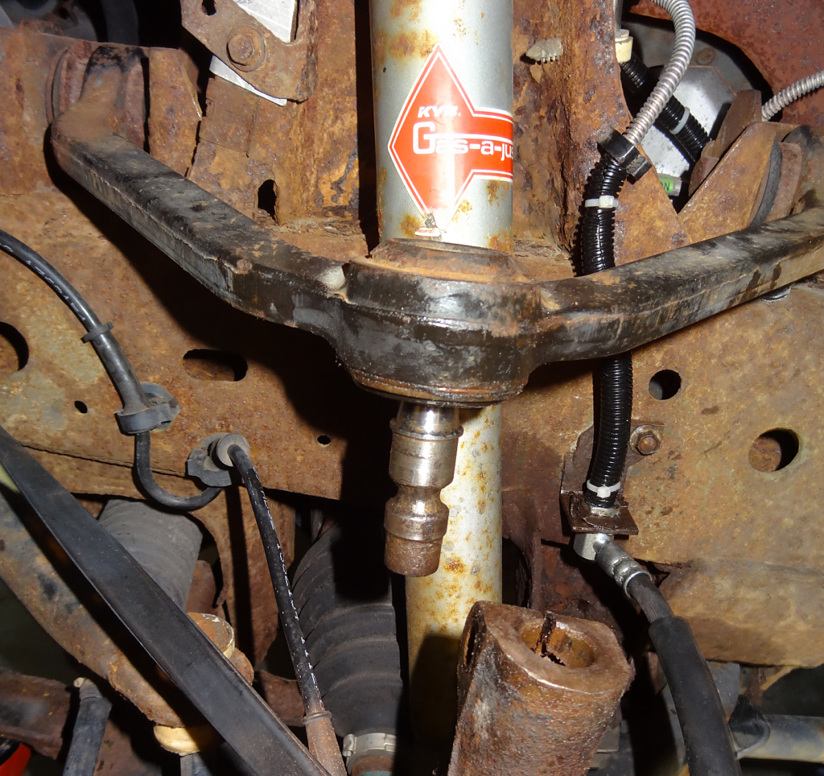

I should clarify, that I'm interested in a boot for the Motorcraft upper control arm BJ, not Moog. The boot on mine disintegrated, but when that started happening, I packed it well with grease and there is minimal play in the BJ so I'm just going to reboot it.
I'm gonna have to measure mine... attempted to cancel the amazon order I just made but then I went out and took a look at it.
The original boot is far too disintegrated to measure, so just removed the chunks of it.
After getting the BJ loose from the knuckle and straightening it, boot length needed is about 21mm compressed, which is consistent with the boot height on the right (passenger) side upper control arm that I'd already replaced.
Upper based diameter 45.5mm, lower pin (stud) diameter 19.5mm, also consistent with the one in the right/passenger upper control arm. This is with rust/crud/grease removed, remeasured after I took the pics. Using Energy Suspension terminology it is (choose the next smaller size from):
Pin Opening Diameter 19.5mm
Base Opening Diameter 45.5mm
Height 21mm compressed
Again this is for the Motorcraft OE Upper Driver's Side BJ, not Moog.
I was a little surprised how easy it was to get this BJ out of the knuckle, prybar for the win! It might have also helped that months ago, I'd added the grease to the deteriorating boot, probably a little oil came out of the grease and ran down into the joint.
