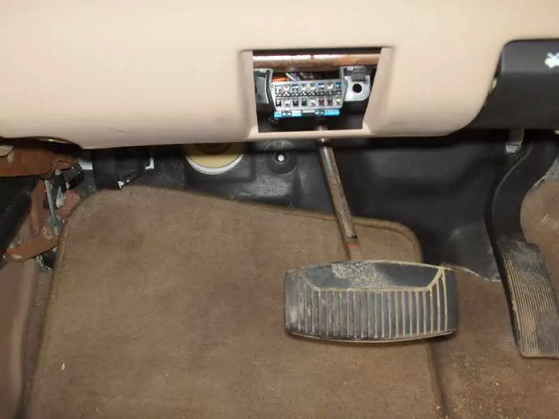

This may or may not be a really silly question, I'm completely stupid when it comes to cars....and especially when it comes to electrical stuff for cars. I bought my 2000 ford explorer limited a year ago with plans to use it for towing. I know it has the two package, but I'm curious as to what this plug is that I found under my steering wheel next to my hood release.
I'm thinking it's probably the diagnostic system hook up, but thought it couldn't hurt to ask.
Here are the pictures of the plug:
Thats your OBD2 plug, used to read diagnostics, "check engine" light
Your plug for the tow package would be in the bottem rear of your truck, if you have the package the wiring will be there, if not you should find a "female" plug that you can attach a towing harness to.

Thanks, I was pretty sure it was the OBD2 plug, but thought it couldn't hurt to ask.
