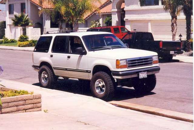

Here is my first one with 4" Trail Master and 33s
