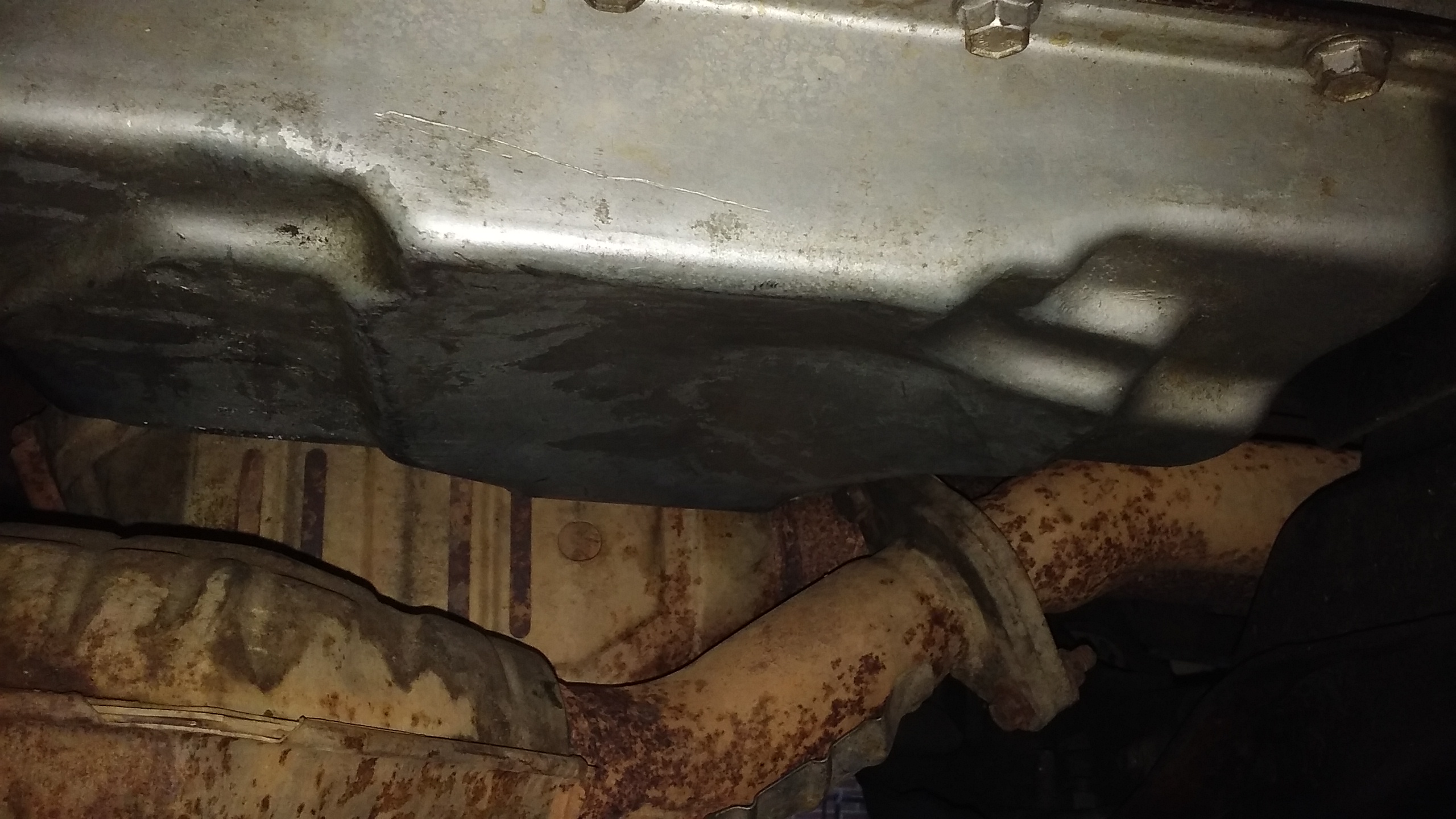

So I got it fixed
That converter pretty much fell off

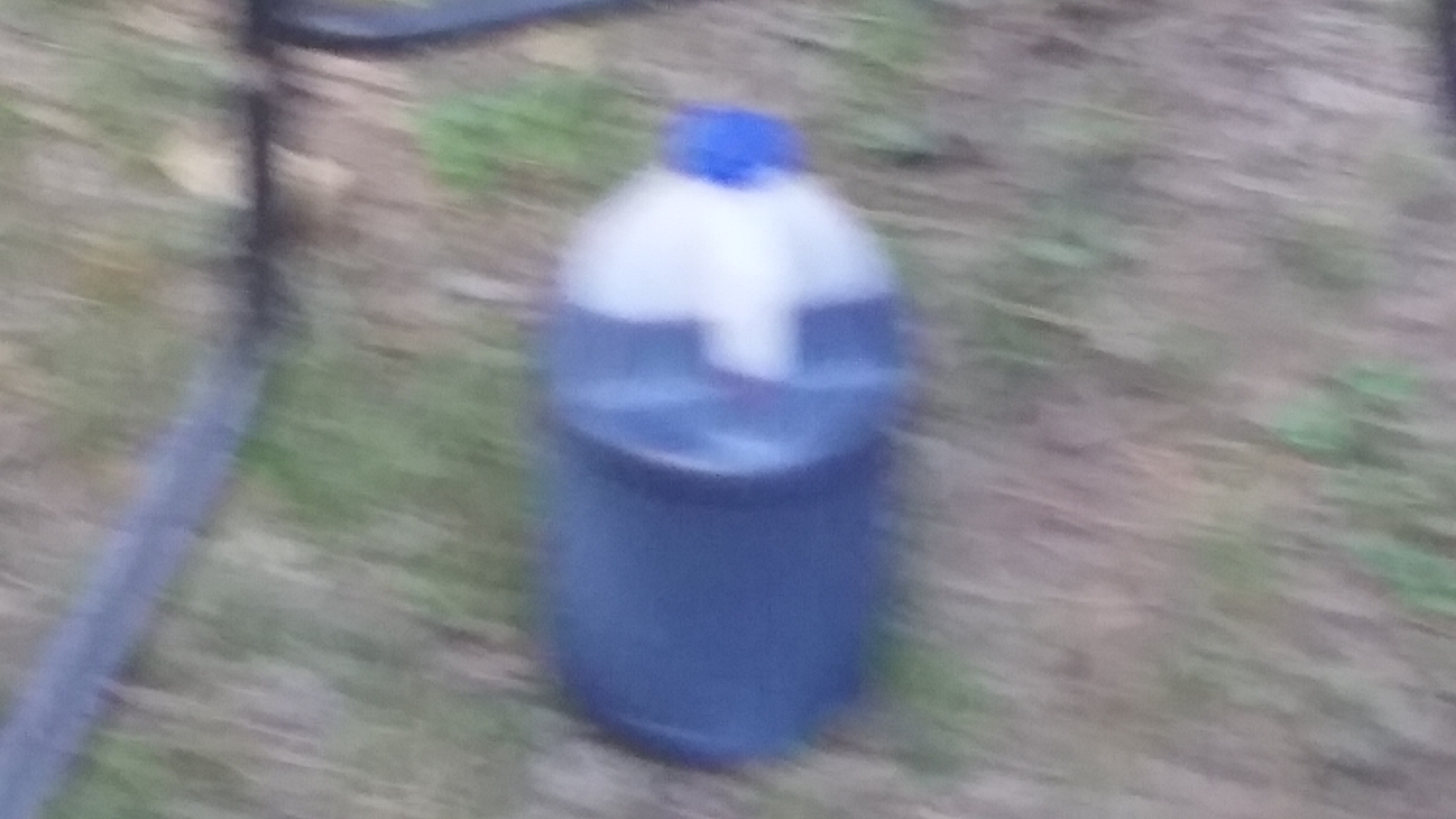

I pumped the fluid out it was EXACTLY 1gal
The fluid looks dark but it's not looks like it did when it went in
Remember only 7500 miles on the trans all Together

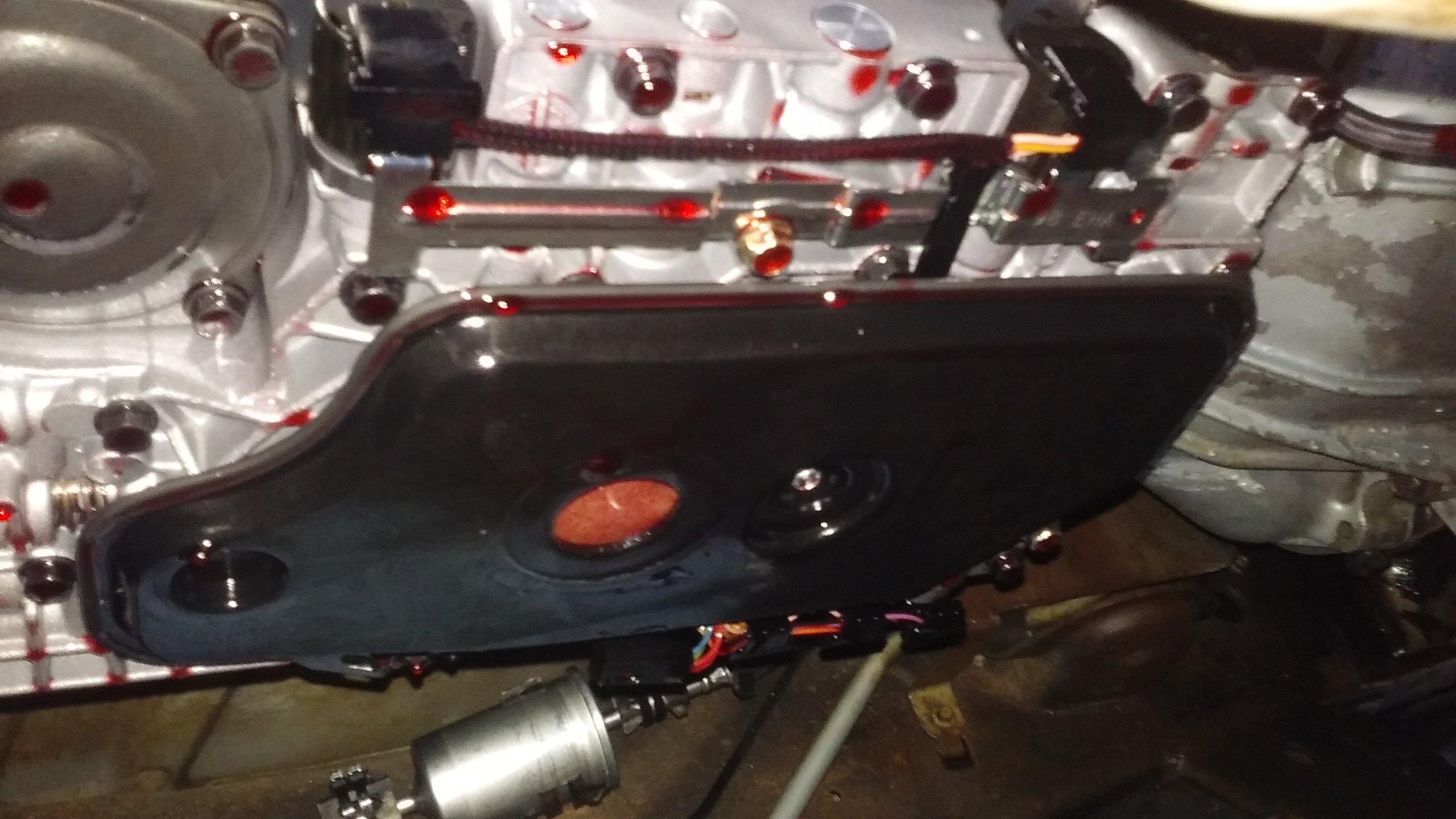

I took the pan off and I found the filter was fine
This is what it looked like
I didn't spill a drop not a drop
Because I pumped it out nice

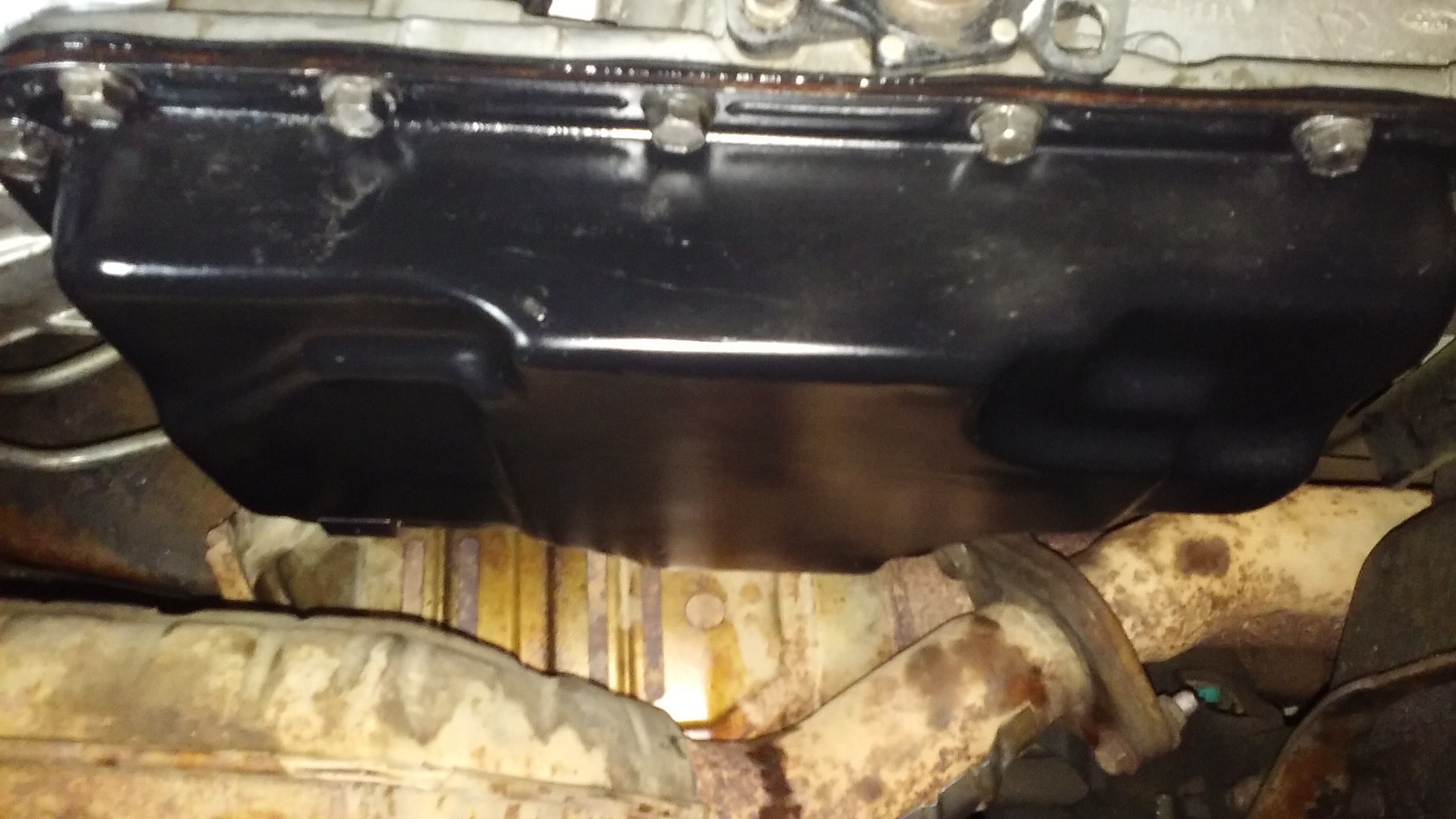

So I pounded out the dent with a piece of 2x4 and a hammer painted it black

The gasket was like new so I reused it installed the pan and torqued to 120 inch pounds in a crosshairs pattern

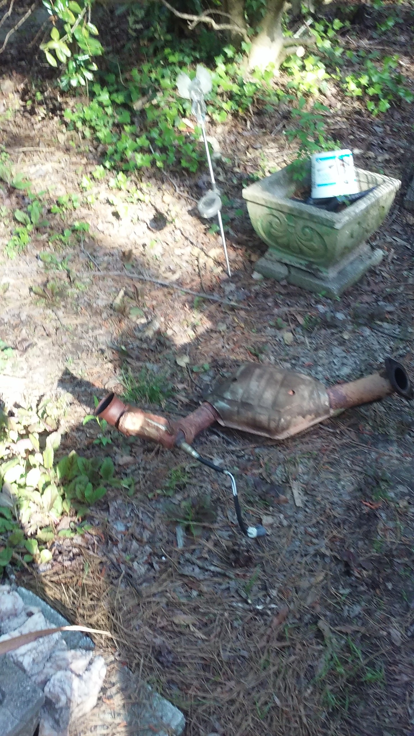

Installed cat I put a little antaisize on the header bolts and the crossover bolts
Before and after
