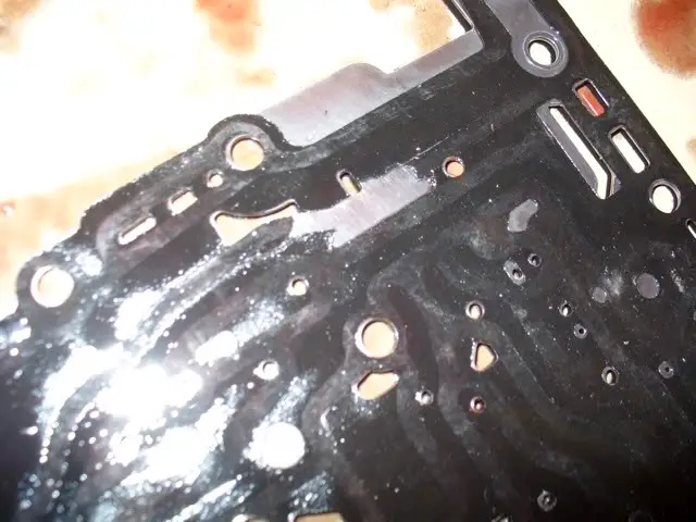

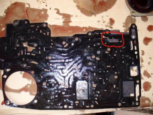

Ok, so I finally got a chance to work on it and pulled out the valve body, on my way thinking that the servo was possibly dried up and not engaging. I found this tear in the top gasket on the plate above the valve body. My truck (98 ranger 2wd, 3.0l I think 4r44e) had lost OD and reverse after towing some a trailer with some dirt bikes and a quad. If I adjust the front band in all the way I get them back but with OD not engaged 1-3 feel like the parking break is on. Could this tear in the gasket cause the servo not to engage and explain my problem? Thanks for any advice guys!
-Travis
here are the pix
