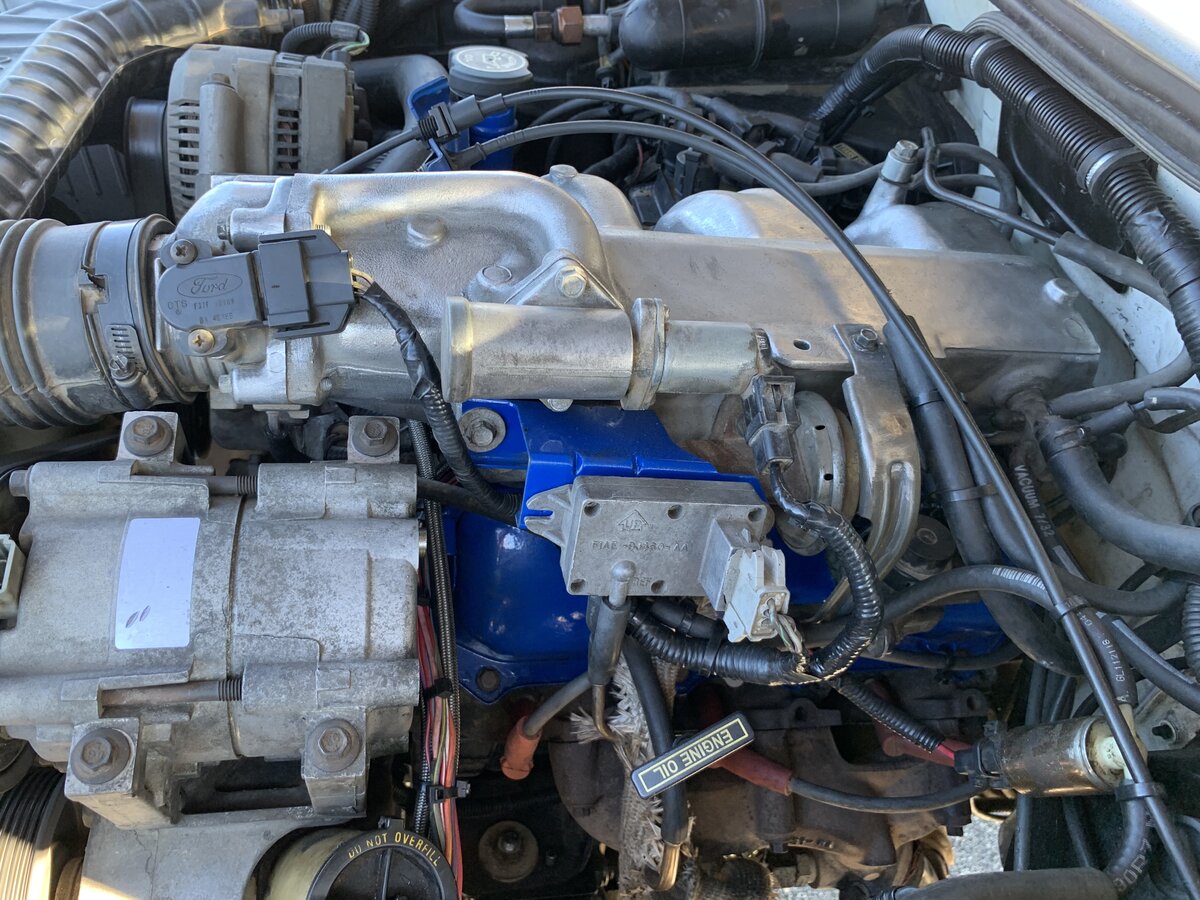

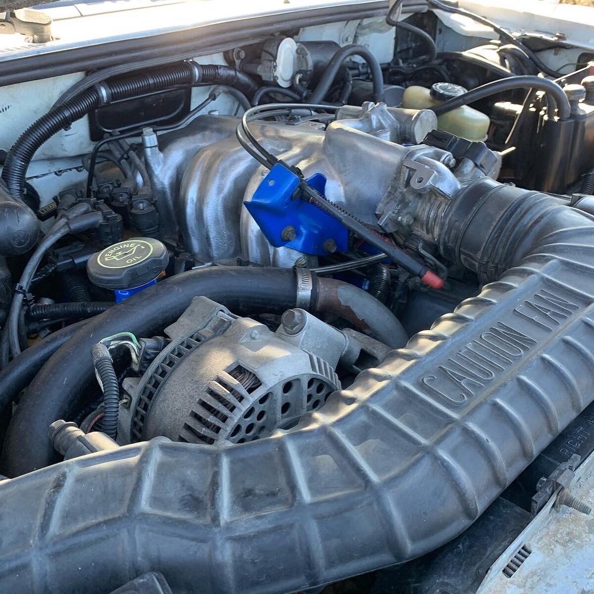

Making progress. Putting a non egr motor in an egr truck has been a little bit of a challenge. The engine wiring harness is different, and today I am going to learn how to install a cam synchro.

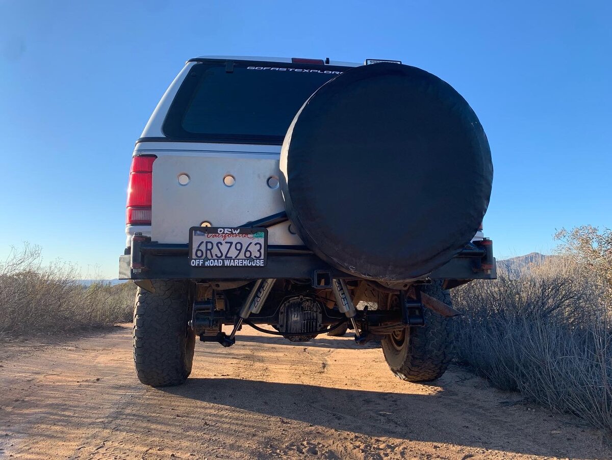

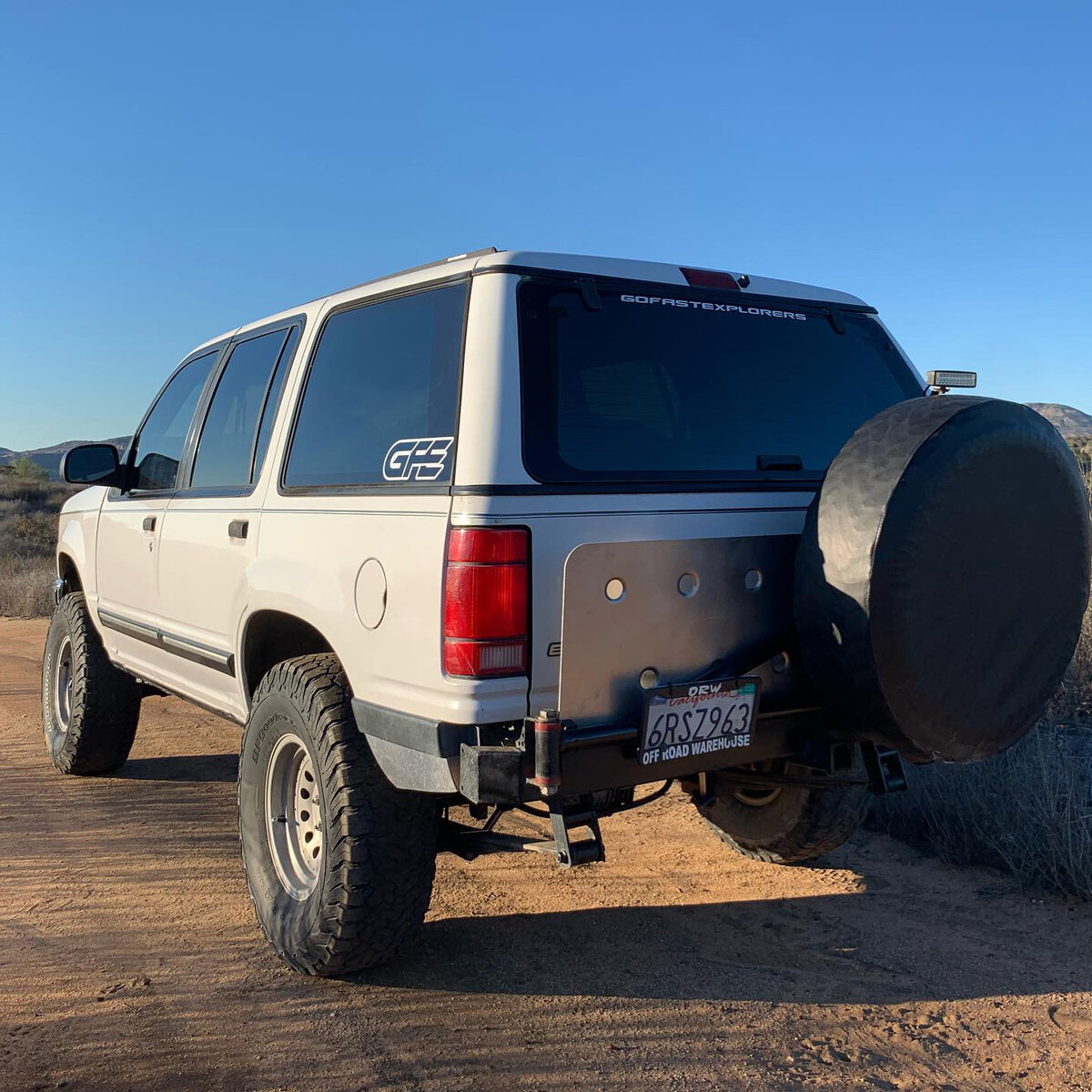

Motor is in & running great. I guess I didn’t realize how tired my old motor was! I’m blown away on how much stronger it pulls now. Zero clacking, zero surging, and just overall so much smoother from idle to 5k. The new solid motor mounts are perfect for my truck. The added rigidity is noticeable as soon as you turn the key. I can also feel it in the gas pedal, & in the seat. I am pretty in tune with the handling of the truck, & I feel less “slop” in bumpy corners, where I would feel the truck wander before. When I hit 65-75 on a smooth highway, it really mellows out & is barely noticeable. I think all of the sound deadner that I have added makes it much more bearable on the street.
I also had a some time to work on my rear bumper. I cut off the little storage box that was attached to it. I’m pretty sure it was acting like a bass drum over heavy Baja washboard roads. The rear hatch is already dented from flying tow straps, so this will give me some protection and cover the dent. It is bolted to the swing out tire gate.

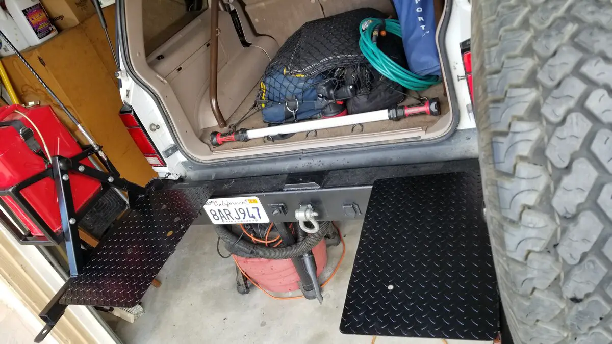

Good to see it back running and better than ever. I made some fold down tables for the tire and gas can swing outs on my bumper. You could easily turn that into a table for camping with a piano hinge.

I was considering doing something like that, but I dont usually open my hatch when I'm camping, only the glass. It has so much Kilmat added to it that the struts wont keep it up. I also push my truck so hard through whoops, that I kind of had to compromise on some quick accesibilty for strength. The gate has 2 anchor points, the .75 bolt on the driver side (nut is welded to the bottom), and the plate that is welded to the back of the hatch that has tabs & accepts a smaller half inch bolt through a bushing that is mounted up at about the center of the tire height. It's still fast, but it needs an impact, and when everything goes back together, it needs to be torqued down really tight.

Having it mounted to the hatch as well as the bumper would take a lot of wobble out of a tire carrier. I thought about that but wanted to be able to quickly open the hatch while on the trail or camping. There is also a lot of movement in the end of the frame. I usually go on the expedition type trips with a buddy who usually sets up or breaks camp in about 10 minutes. Even with easy access, it still takes me about three times that long. My tire carrier doesn't wobble very much compared to most, but I use a bolt instead of a latch to lock the swing-outs down to the bumper. 1/2" bolt, just like a whole bunch of my suspension components with the ratchet wrench in the driver door pocket. The swing-outs used to have brass bushings, but I got tired of fighting it as it was always too tight or too loose. I redid it over the first COVID lockdown to add the traditional 1500 pound trailer spindles and bearings. Having the ends bolted down takes the strain off the trailer spindles.
With the fold down tables, my Coleman two burner camp stove fits perfectly on the tire carrier side (not the gas can side for obvious reasons).
