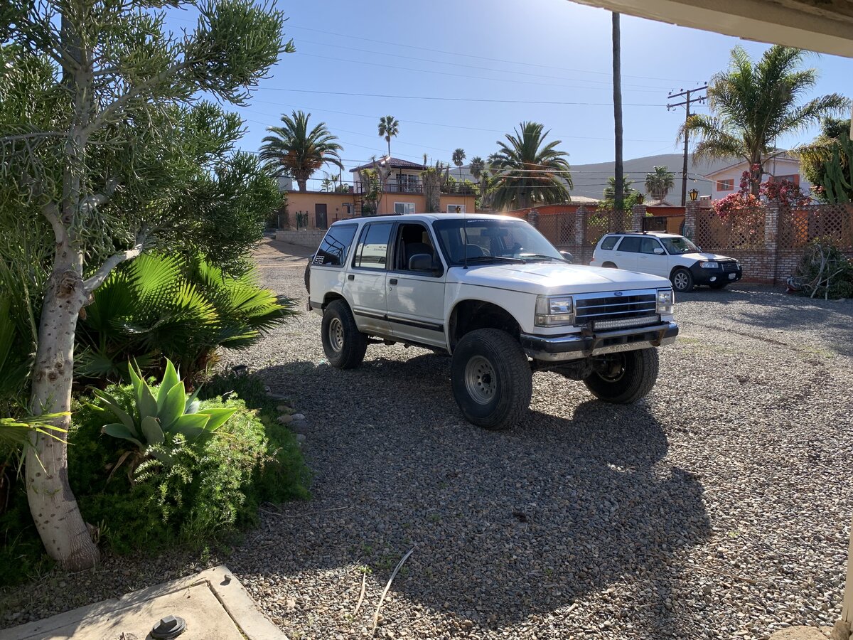

Current pic

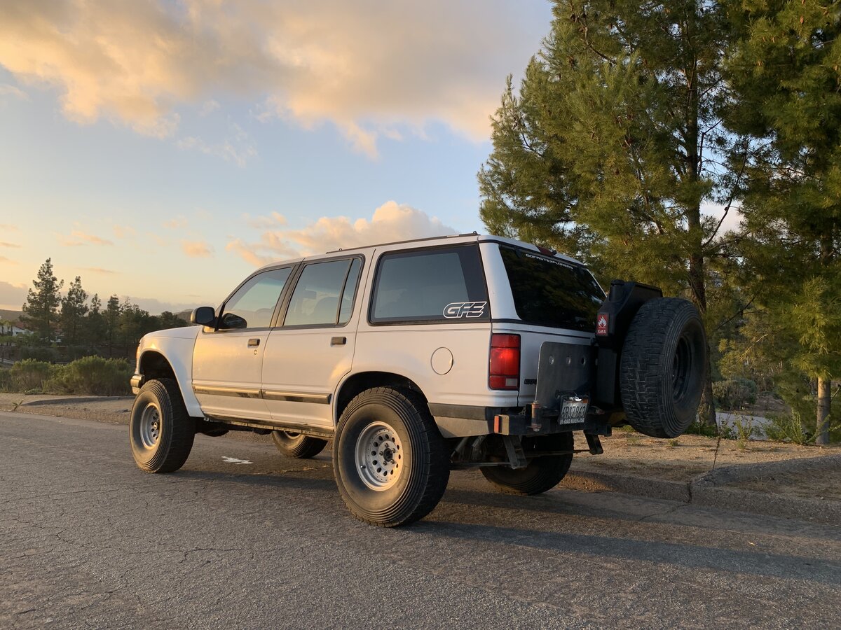

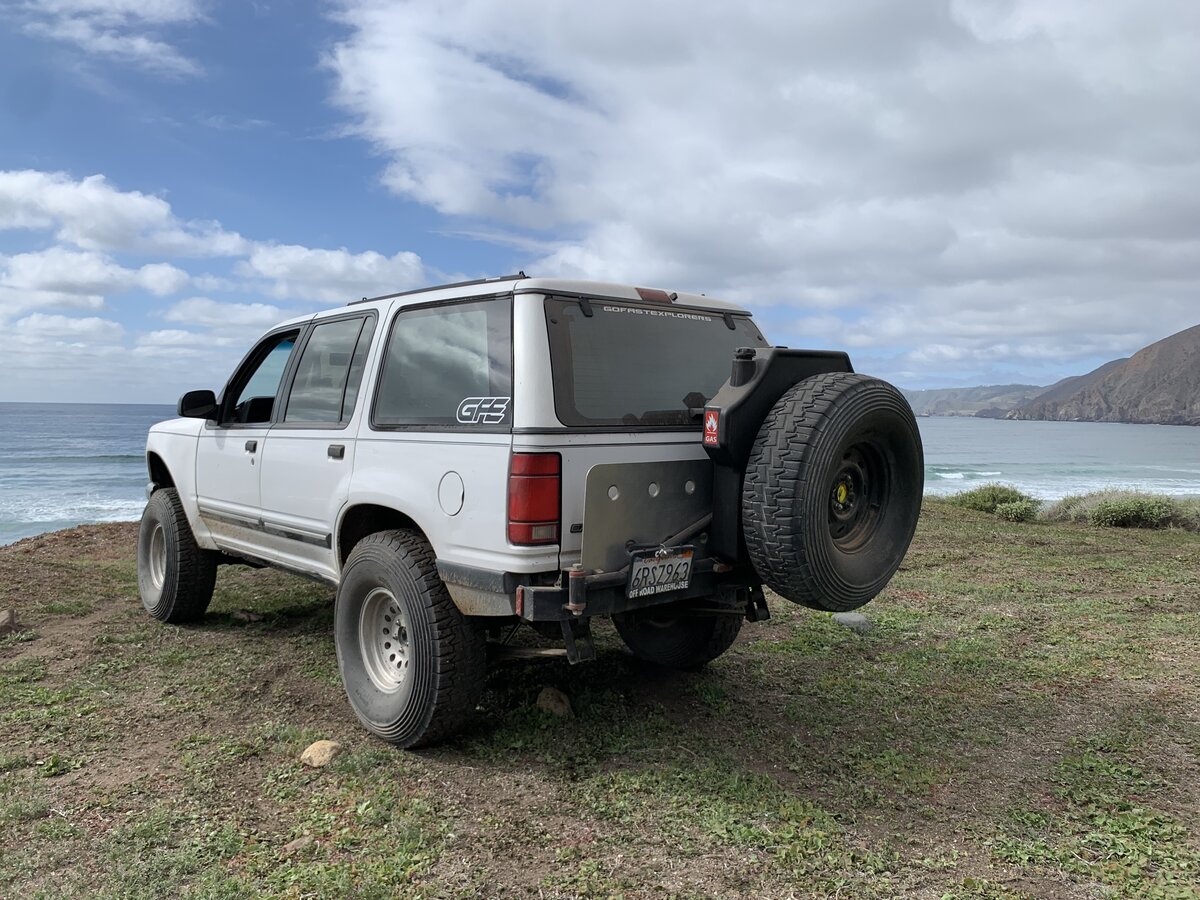

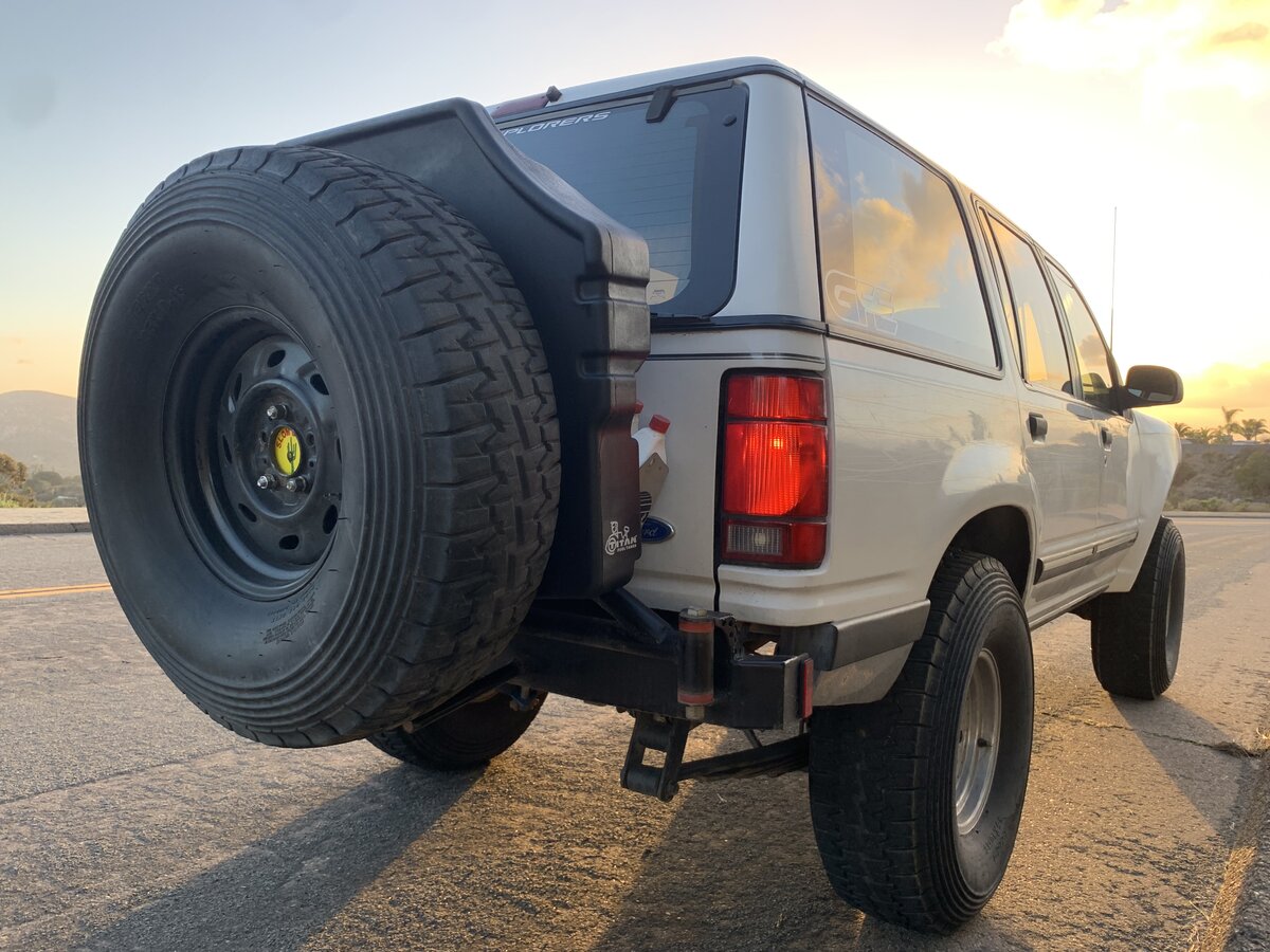

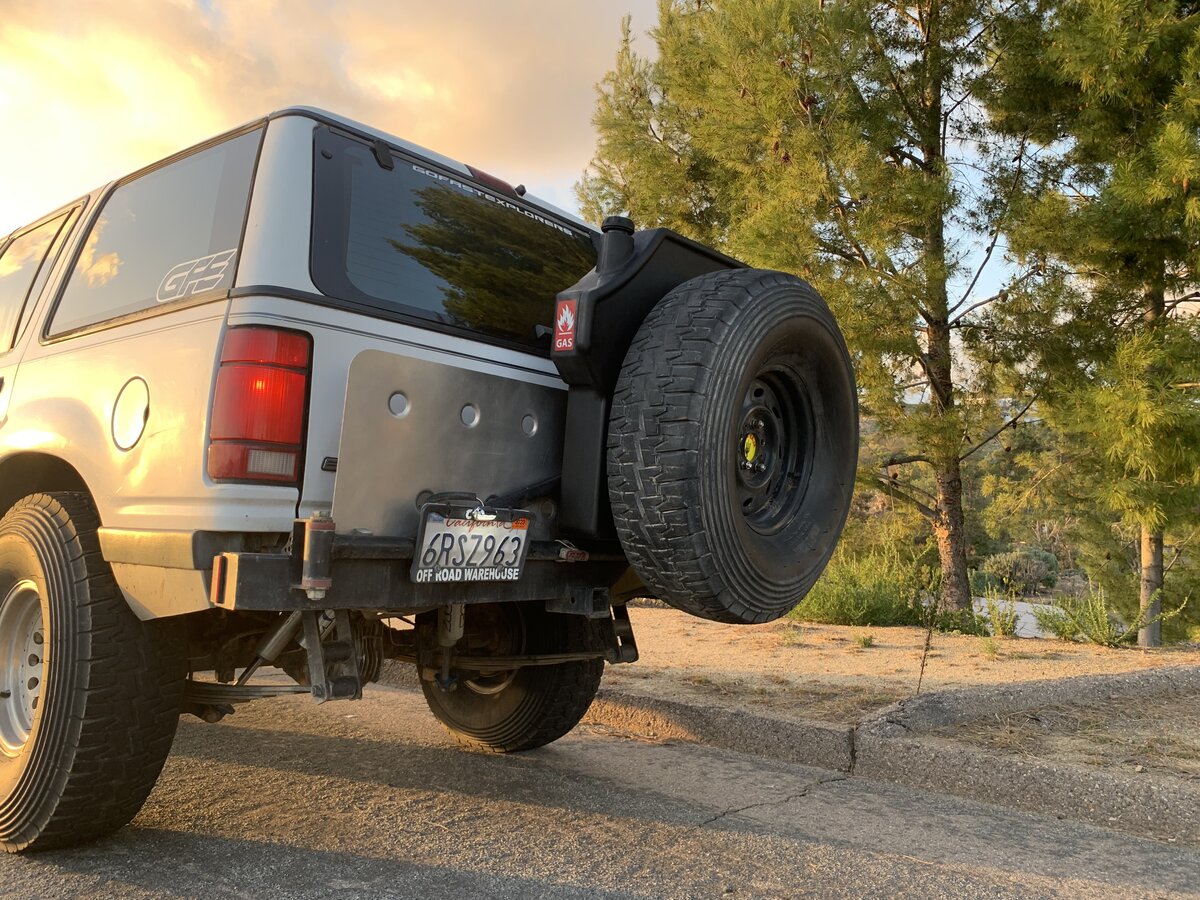

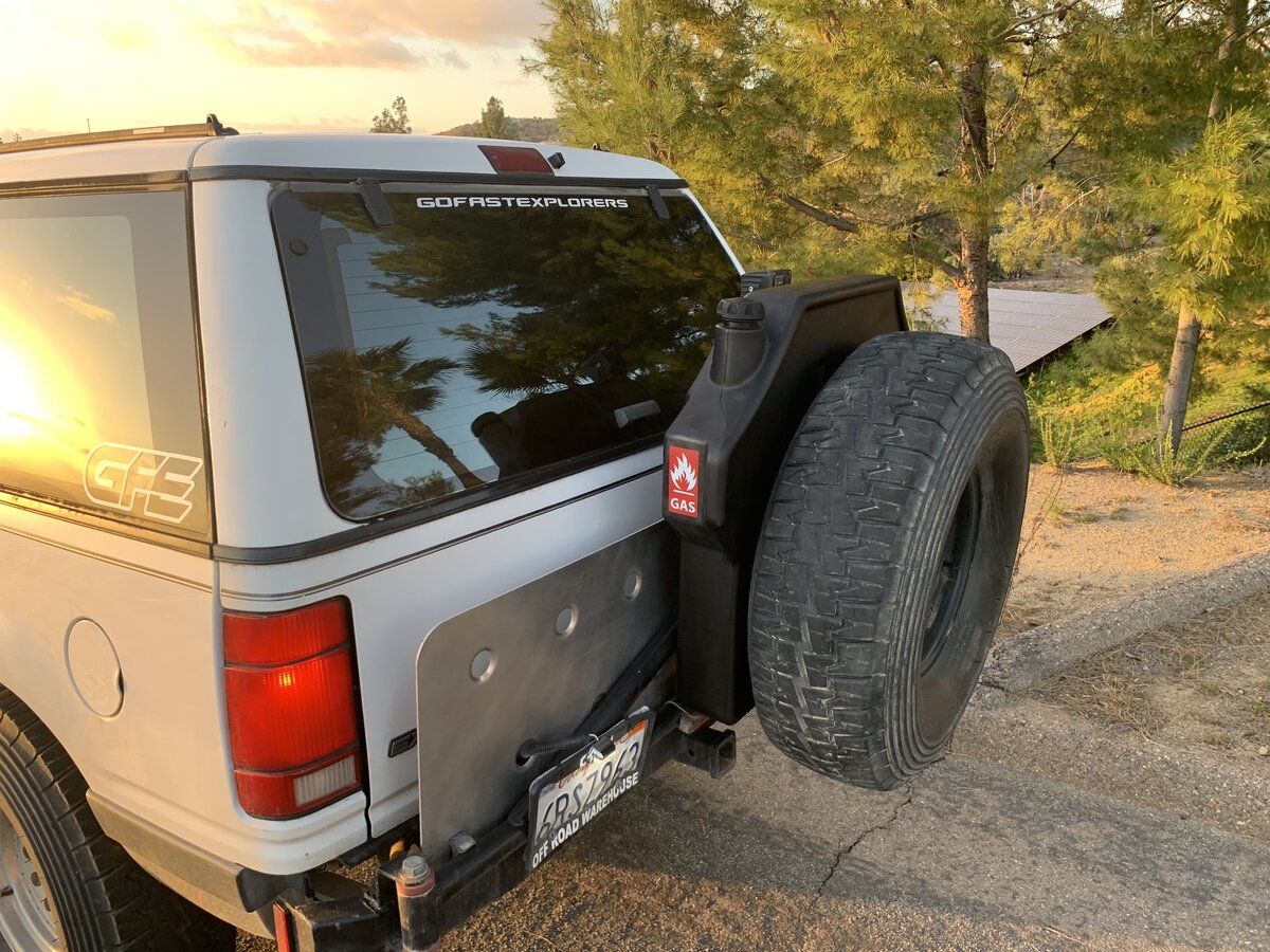

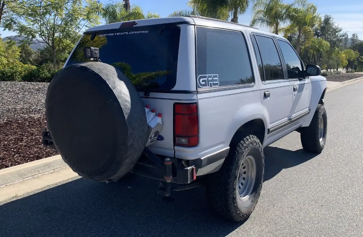

Having it mounted to the hatch as well as the bumper would take a lot of wobble out of a tire carrier. I thought about that but wanted to be able to quickly open the hatch while on the trail or camping. There is also a lot of movement in the end of the frame. I usually go on the expedition type trips with a buddy who usually sets up or breaks camp in about 10 minutes. Even with easy access, it still takes me about three times that long. My tire carrier doesn't wobble very much compared to most, but I use a bolt instead of a latch to lock the swing-outs down to the bumper. 1/2" bolt, just like a whole bunch of my suspension components with the ratchet wrench in the driver door pocket. The swing-outs used to have brass bushings, but I got tired of fighting it as it was always too tight or too loose. I redid it over the first COVID lockdown to add the traditional 1500 pound trailer spindles and bearings. Having the ends bolted down takes the strain off the trailer spindles.
With the fold down tables, my Coleman two burner camp stove fits perfectly on the tire carrier side (not the gas can side for obvious reasons).
Same for me, the entire gate is held in place by bolts, but I would like to change the hinge to a spindle at some point (maybe a Dana 35 snout?). The bolt that is keeping the gate attached to the hatch actually has an old 1/2" drive socket welded to it. Makes it a little quicker to pull off. I think I am goint to build a hidden impact mount on the bumper somehwere to make it a little easier to open. Something like this.

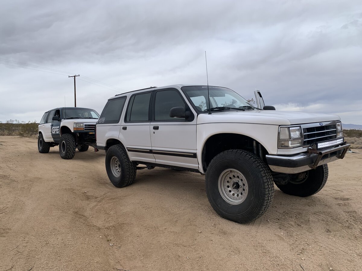

Are you waiting to the current tires to wear out before swapping?
It looks a lot like the first version of my first explorer (minus the rear bumper) right now, it's cool to look at.

I’m prepping my truck & another truck for KOH this weekend. Tires will go on as soon as I have a second to breathe, lol! They will definitely be on for this weekend though.

I recently added a Titan Trekker auxiliary fuel tank to my ride. It added 13 gallons of additional fuel capacity. With gas prices where they are at, it allows me to avoid those middle of nowhere gas prices! The water on the ground in the last pic had me doing a water pump right afterwards!

I've considered one of those fuel tanks too but never knew anyone who ran one. I'm often cutting it close on fuel on trips I do even with a 5 gallon jerry can. Would you recommend it for a go-fast desert truck? Does it seem like it will hold up to the abuse?

That is a lot of weight hanging out over the rear bumper!
Well not too bad considering many rigs carry two jerry cans
Some details of how it mounts back there would be great!
Silly the explorers have a small fuel tank, the mighty bii was shipped with 23 gallons!
My truck is a GoFast Desert truck! I can carry a decent pace through good sized whoops. I have ran it pretty hard when full, but I try to strategize my trip to where it's empty when I get into the big stuff. My bumper is also pretty rediculous when it comes to strength, so that is something that really needs to be done before going fast.
There's a pretty solid run down located here - Titan Trail Trekker II Fuel Tank Review - Off-Road.com

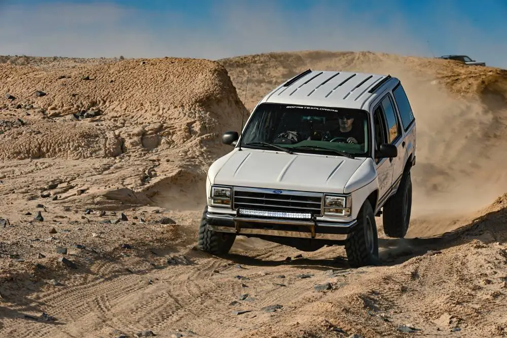

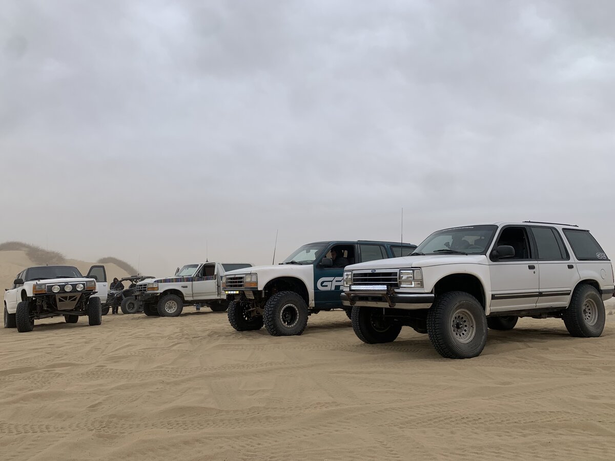

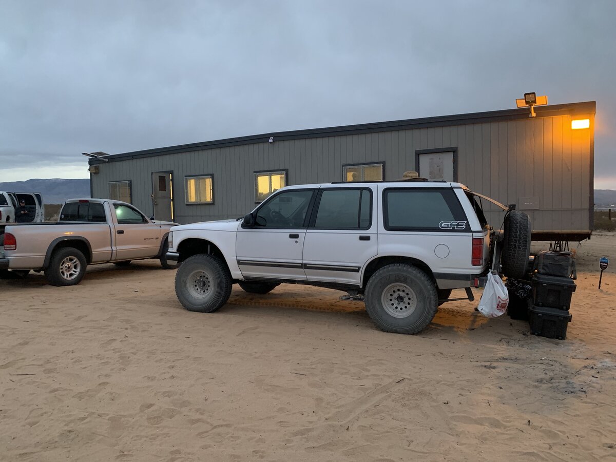

Had a blast running this thing out at the GoFastExplorers meet. Zero issues, and pushed it harder than ever. Before the trip I did a front shock revalve and it made a huge difference!

It’s all about the shocks!!
Nicely done
