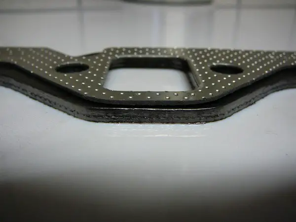

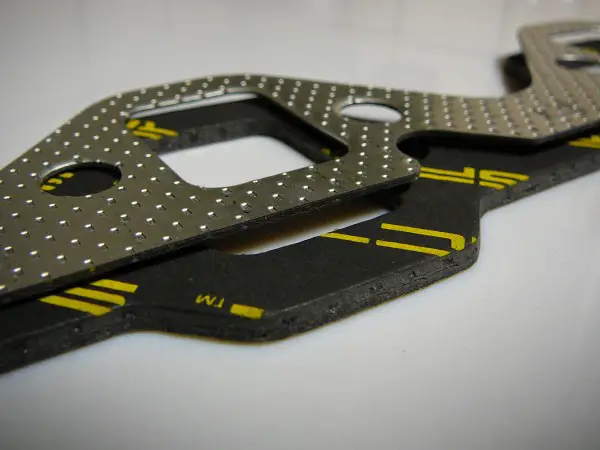

I installed the remflex gaskets and so far i'm glad i did. The quality was better than the other gaskets i looked at. Being 100% graphite they are super soft and mark easily so you need to be careful. I didn't need to re-torque them.
The pics are a comparison of the spectre vs felpro 9000 and felpro 9000 vs remflex. Thanks for talking me into waiting for the remflex celly.
Quite welcome. I'm envious. I've still got the ones that came with the headers in there. :(
