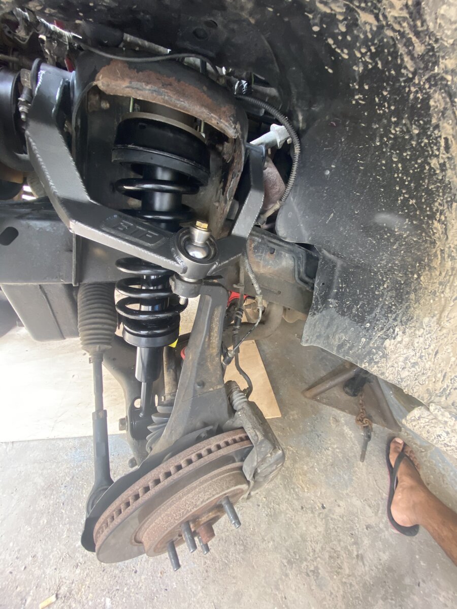

todayworked on my truck as I have received all necessary parts:
BTF upper arm
BTF Struts spacer (3”x2.5”)
Front and rear complet struts (CARiD.com)
Sway bar bushing (amazon)
Sway bar end link and bushings (amazon)
Wheels to come from CARiD.com
now just waiting on my new wheels mayhem tank 8040 18x9 -12 offset to install with tires 265/70R18

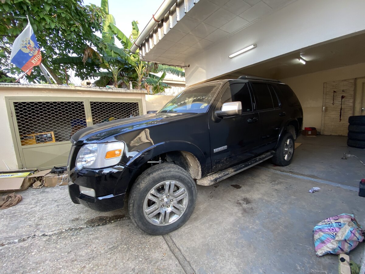

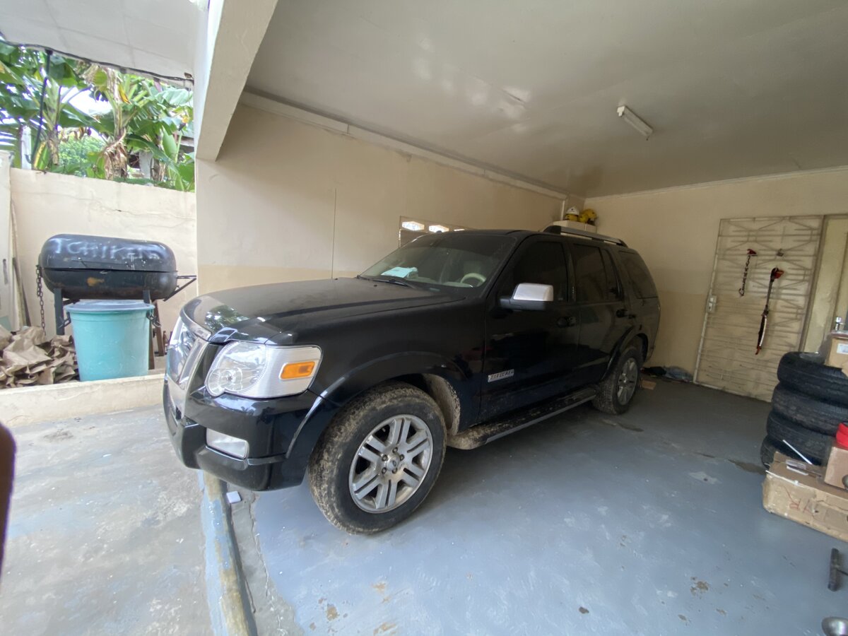

pic. Before and after and during installation

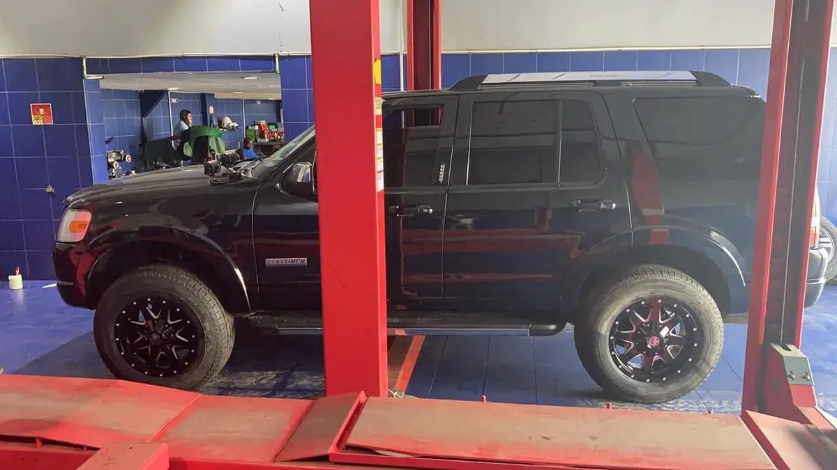

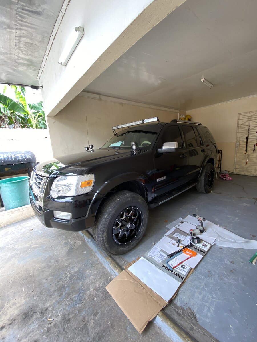

got my set done and I love it.
here is the the final product, just need to get the alignement done. And that will be tomorrow.
Juste have some minors rubbing on the inner fenders.

both upper arms and struts spacers from BTF
