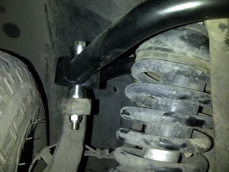

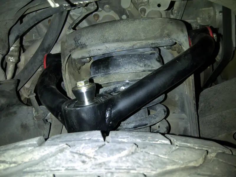

Today I've installed the extended upper control arm and they work great
the installation was a direct procedure
  • jack the vehicle
  • remore the tire
  • remove the side bolts of the UCA
  • remove the bolt that attached the spindal with UCA
  • install the new UCA with putting a new washer for the side bolts and repeat every thing in reverse
only one thing when I ordered them I request them to be extended for 1/2" which i discovered it is just fit with the UCA pushed all the way back and there are no space for a tolerances or further adjustments
so I recommend the the arms extend 3/8" to be more adjustable

Mine are the exact same way. I believe Brandon said that he had to limit the extra length because if they were too long it would have resulted in too much positive camber at normal ride height....more than could be compensated for by an alignment.
So it seems there are two ways to get around the issue of arm/spindle contact on the spring:
1. limiting straps
OR
2. using a smaller strut spacer on the top and making up the rest of the lift difference by preloading the coil springs.
I am currently working on option #2 by modifying the OEM type struts and will order some smaller BTF spacers.
For my vehicle it looks like I will be limited to a 1" BTF spacer on both the front and rear. To make them work I am going to remove the existing mounting studs on top of the struts and install studs that are 1" longer so they can pass though the BTF spacers and extend through the top mounting area so the nut can be installed.
The rest of the lift height will be gained by preloading the coil springs by .75" on the front and .5" on the rear.
This will result in the same amount of lift as I have now with 1.75" front/1.5" rear BTF spacers, but the control arm and knuckle will not touch the springs and the axles will not touch the frame in the rear.
The only disadvantage is that I will lose .75" downtravel in the front and .5" in the rear, but this is not significant in my opinion and it definitely is better than having suspension parts rubbing together.
When you get your coilovers you will be able to do the exact same thing by adjusting the spring seats on them. Or you can eliminate your truxx spacers entirely and adjust the coilovers to give the entire amount of lift you have now (best option, all the advantages with none of the disadvantages).

is arm/spindle contact on the spring an issue???
it is only happening when the tire become air born
as long as it is not hurting the CV, the lower ball joint nor the steering rods, I'm quit happy with the extra wheel articulation. actually it gives more to the off-road capability of my Ursula :D

As you said it only happens when the tires become airborne. Depending on the type of terrain you drive on it may happen frequently or not at all. I would prefer that it not happen at all, but I tend to think in terms of the worst case scenario. For me it does not occur too often but like I said I think I can prevent it from happening without losing lift or doing too much extensive modification so I will try what I described in my last post and see.
I think the only time it is bad is if the spindle gets caught in between or hangs up on the coils...though it does not look like that would happen to your truck based on the photos. On mine the spindle slides a little on the coils and the uniball cup touches the spring but only at full suspension droop. It is not a very big problem but something I would like to see if I can fix. You may get some of the coating on the springs scraped off (as I have) but that would probably be the worst thing that might happen.
The CV's and lower ball joints/steering components should be fine.

I have the springs scraped as will and this is happinning from the first time I installed the Truxxx spacers.
And becuase I jump my Ursula on dunes with speed I can assure you James the scraped spring and fast damaging upper control's ball joint is the worst case scenario. And hopefully with BTF UCA I will never get the uni-ball damaged as OEM
