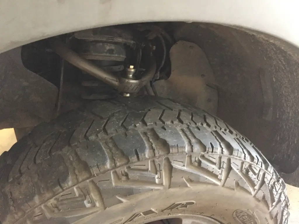

just got the BTF control arms put on now its time for new tires and an alignment def recommend these if you run the truxxx lift because with the stock upper arms you definitely see quicker wear of your tires.
ordered mine yesterday after a talk with Brandon.
1-2 week lead time.
Here are the photos from when i got them put on couldn't get a good one from my phone with the new KO2s though but w/e.
wow - looks great!
