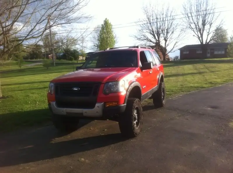

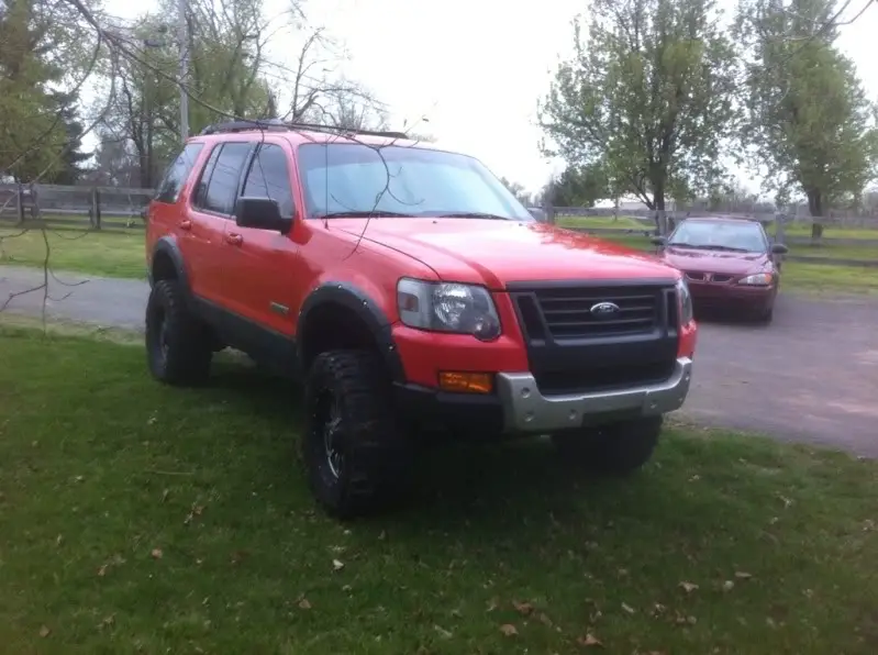

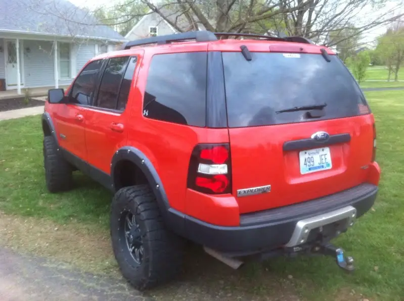

Today. Hopefully it last. Here are some pics Keep in mind I run 2.5" spacers

Allaa' - I am currently running 245 70 17 tires on the stock wheels (looks a little goofy with the lift, that's why no pics at the moment). I want to upgrade to 265 70 17, keeping the stock wheels if possible. Have you experienced any clearance issue between the 265s and the UCA? There is only about 1/2" of space between the sidewall of my 245s and the uni-ball housing, so I'm concerned about the wider tires. Or will I need to go to wheels with a little less backspace? Or 245 75 17?
I didn't have any clearance issue between the 265's and UCA because the 265's is only 20mm wider which means the tire will become colser only 10mm to the UCA.
On the other hand, because of the lift the wheels went inside and looked so dorky. For that I used 25mm spacers to compensate. And now the tires are in the exact level with fender arch.

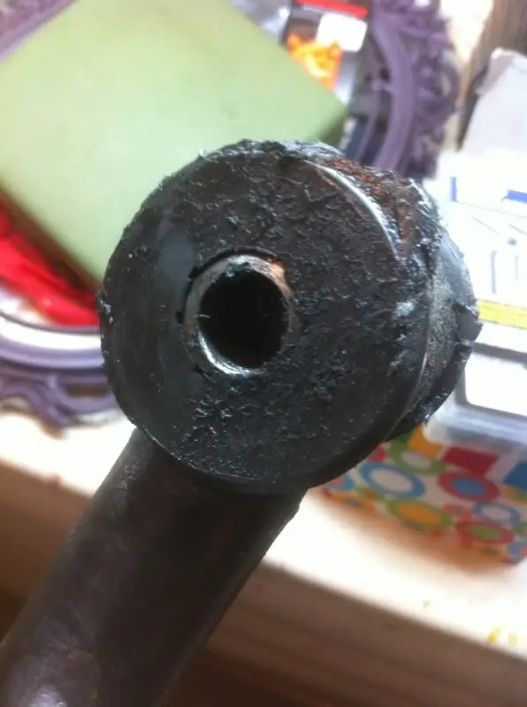

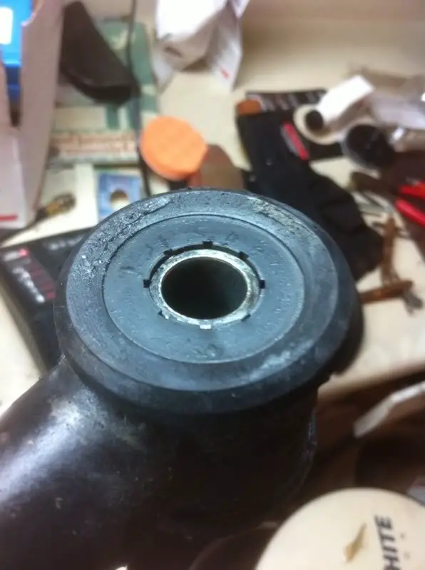

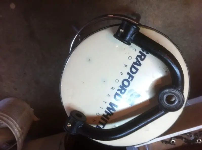

Ok I'm still having problems. I'm posting pics. It still seems the metal sleeves are just to short. Let me know what u all think. The bushing has sunk in a lot to try and compensate for the short sleeves. I think this is why I can't keep anything tight.
As u can see even with the bushing sunk in from the washers the metal sleeve still is not even with the outside. Please let me know if u all agree or if I'm completely wrong. Thanks!
Got ahold of Brandon. He confirmed that the sleeves are to short. He is making new ones so hopefully that fixes the problem.

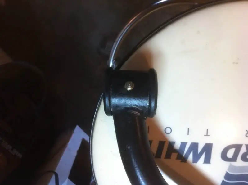

I went ahead and added some grease fittings so I can keep every lubed.
