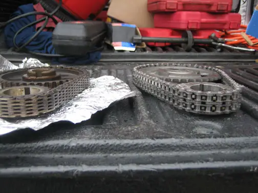

Some photo updates:
Timing chains compared. Stock on Left, Cloyes Double Roller on right:
New chain installed:
It was very easy to get the old one off, I used a standard gear puller on the cam gear, and the crank gear slid off. Crank bolt was then removed by putting vice grips on the old chain.
