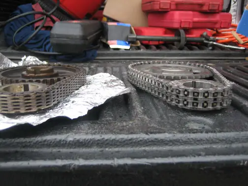

BTW, did you notice if the timing chain had true rollers, or did they have seams? I bought a Cloyes for my first Cleveland in 1980, and it was supposed to be a true roller. It was not, and I have never bought any of their products since. The rollers are supposed to be seamless, from a solid tube stock. That's the key feature of a roller chain. Get it running now.
So, what's the advantage to that timing set you replaced it with?
Uhhh... Jtsmith said to use it! :D
The roller designer should provide a little less friction and therefore reduce heat and increase tq/hp. It was also cheaper.
I just picked mine up at the local parts store, and went with it. :)
I didn't examine the chain too close, but I did not see any obvious seems. I didn't see your post before I buttoned up the cover.

Some photo updates:
Timing chains compared. Stock on Left, Cloyes Double Roller on right:
New chain installed:
It was very easy to get the old one off, I used a standard gear puller on the cam gear, and the crank gear slid off. Crank bolt was then removed by putting vice grips on the old chain.
