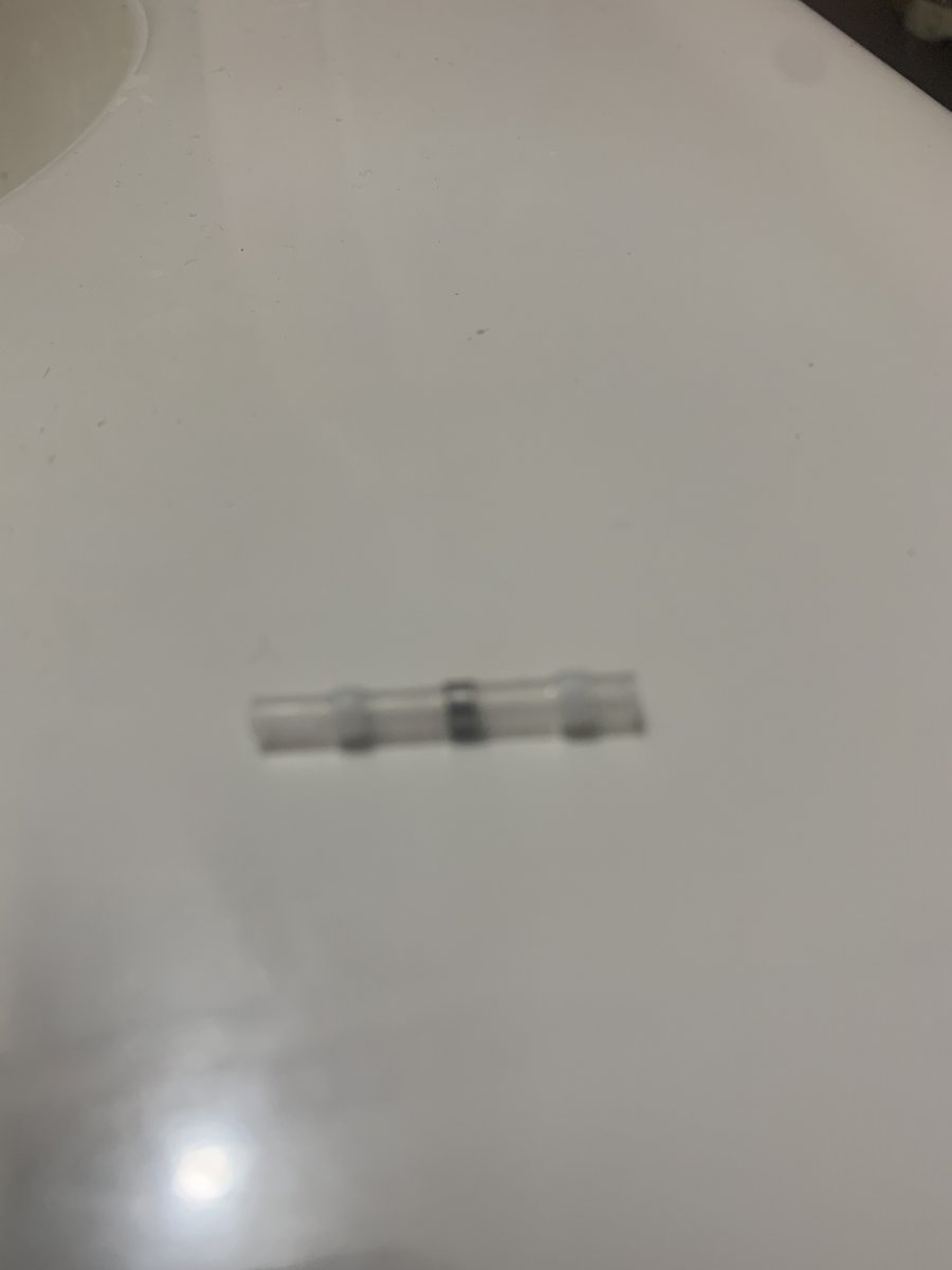

Finally my phone doesn’t glitch out replying to this one, im using marine butt connectors, the ones that are made for wiring that’ll be used in a water type situation I use them on everything, It comes with the silicone and wsolder in them just gotta head them up once the wires are spliced back together (photo below of one, too small for these wires, though, I do have bigger ones that will work)
