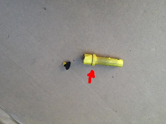

Today I decided to poke around the Explorer and was actually testing suspension components. Curiosity got the best of me and I started looking around under the vehicle which eventually led me to wonder about the transmission fluid that I had changed back in February, I believe. I wanted to verify that the fluid level was around where it should be on the dip stick and that the fluid was clean vs the slightly burnt/dull red color when I checked it back in October/November of 2016. Well... this is what I found -
The shop that I've trusted my vehicles with for the last 4-5 years had snapped my dip stick and what appeared to be epoxy to try and mend it back to the base part... on top of that it appears that a piece snapped off. For all I know that other piece is floating around in the transmission somewhere. The epoxy part separated after i tried rubbing the black crud off thinking it was some kind of sludge. The kicker is that when I was checking this, the fluid wasn't even at operating temperature or with the Explorer running, so I'm sure this is a major factor, but the fluid was up to where the red arrow is on the picture. WTF?! I know for fact that the dip stick wasn't broken when I checked it last year. I'm slightly peeved about this and I'm not even sure what I should do. I sure as hell know that I won't be going back there. Oh, and the fluid was bright red so at least that's a plus. I'm wondering if there's too much fluid in the transmission, could this also contribute to the RPM surge issue?
The red line you have indicated is where the metal cap would sit when screwed into the case. If your fluid level is up to the top of the case, then it could be overfilled and could cause some unusual conditions. So its possible that you have solved the mystery. Have a vacuum pump to remove some fluid?
The broken "stick" piece if in the pan should not cause any problems. A new dipstick is Part # 6L2Z 7A010 C.
Yes, exactly! The fluid expands as it gets up to operating temperature. I wonder what happens when there's no where for it to go? I drove multiple long trips this year with no problems. And I do have a hand pump that I could pull some out if need be. Trying to figure out how much to pull out while at operating temperature might be tricky... Also I'll need a new dipstick first, luckily they are only about $10. And I guess that's what the transmission filter is there for?
Check the level with the new dipstick , then go from there. If you have a Mityvac type pump, the small bottle holds 4oz. Remove the 4 oz and check level.
