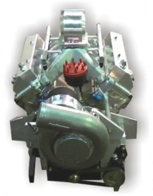

Nice Ideas and I want all the feed back the cooling is the issue I am facing the most I was going to move it forward since i'm running a stick I won't need a transmission cooler so I could move it forward that way and the transmission is the other thing I have not found for that particular engine I have one I like but I'm no sure how it going to mate to the 351W and it is a 6 speed like this one http://www.rsgear.com/products/transmissions/race-performance/zf.aspx
. Supercharger is going to be $4,400 http://www.dyersblowers.com/1694.html .
The heads I have not found yet but putting about $1,500 for a full loaded set. As for oil pan I was going to go custom as I am leaning towards dana 60`s and headers custom as well but probably home built instead of bought.
