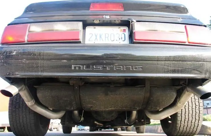

Not to worry. Lots of cars, including Mustangs, have the exhaust running right beside the tank. There's an inch gap between the tank and the pipe. I doubt you'd be able to ignite the gas inside from heat alone anyway if fumes aren't involved. The heat would have to be pretty intense and the tank be pretty near empty for the gas to heat up from a tailpipe. Just my thoughts...
And, the part you see under the 'stang is a plastic (ABS?) rock guard for the tank. The tail pipes are quite close from factory. In an unrelated story I loaned my car to a buddy once and he backed into something and bent the passenger side tailpipe (my excuse for getting new 2 1/2 stainless ones) up against the plastic. This resulted in a melted guard and a melted plastic fuel line which proceeded to spray a fine mist of gasoline at the bottom of my prized possession. Fortunately I happened to notice the leak and disaster was averted...
Hmmm, kind of rambled on there, not sure what all this has to do with the thread now.
