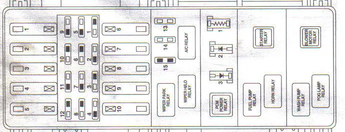

Most likely cause is the relays. Had the same problem with my '01. There are two relays along the inside of the passenger's side frame rail in the engine compartment forward of the wheel. If either one of the relays goes out, the washer will stop working (these relays work in series).
this is how they are layed out
How do I go about testing the relay?
Easiest way is to find another relay in the vehicle with the same part # and swap the other one in to see if the problem goes away. Remeber, BOTH of the wiper/washer relays must be operational for the system to work, so you may have to check more than one place.
This box looks different then mine. Looks newer then my 96 which does not include. the washer pump relay. Does anyone know where to find the hidden relays on a 96??? The line going to the pump does not have 12v and the fuse appears good, so its either the relay or the MFS (multifunction switch) on the column.
Thanks to curiousity and "Dogfriend in the Ranger forum", this box has been found to be in the front below the air cleaner. - Bad spot for a relay box, since box get covered with salt spray from grill and the washer pump relay was the closest to the front edge and got corroded.
