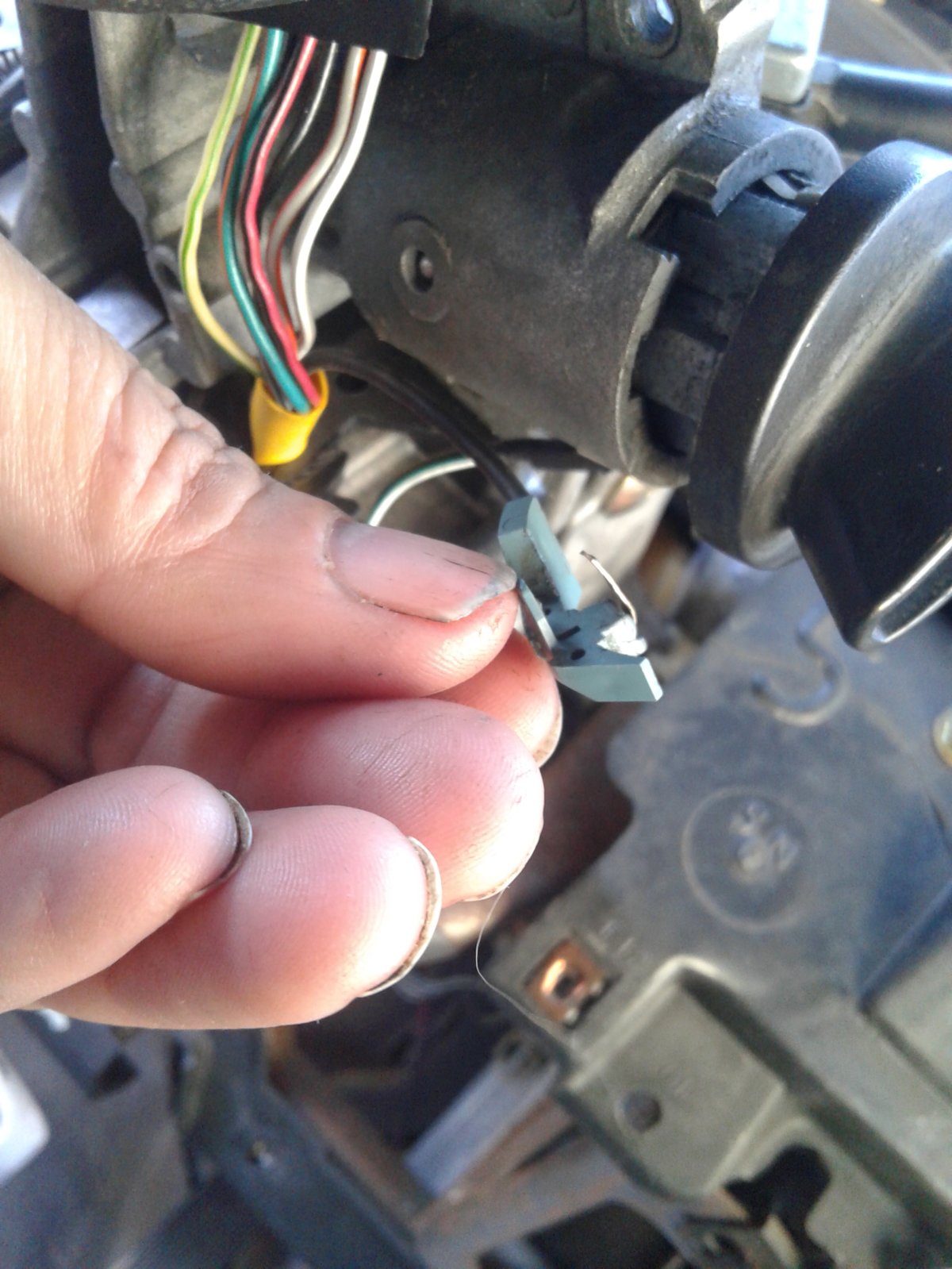

I have a 1997 Explorer XLT 4.0 SOHC... The shifter is loose and I took it apart to check it out when I noticed this little gizmo just kinda hanging out of the ignition... Can anyone tell me what this is and more importantly what the part is that would hold it in place... I am pretty sure I am missing something here I just do not know what it is...
I think that's the thing/switch that activates the "ding-dong" chime when the key is in the ignition with the door open.
I thought that was what that was... any ideas as to what fills the gap??? Something has to hold it in place... and thanks for the quick reply... I am stranded out of town and need to fix this ASAP...
IDK how it fits into the lock, but it should'd be leaving you "stranded". What exactly are you experiencing?
I am actually stranded because the pin fell out of the shifter and well I have no shifter... I put the key into the ignition and I can pull it out no matter what position it is in... when I turn the key off it sometimes does not turn off all the way so my electrical stuff is still on... not cool for the battery...
Sounds like you need a new lock cylinder and maybe the parts the lock cylinder engages to work the ignition switch. The pin that holds the shifter in is called a roll pin. In a pinch a small machine screw can he substituted to get you home, but you have other problems. It's a bit hard to believe all these things broke at the same time. What broke first?

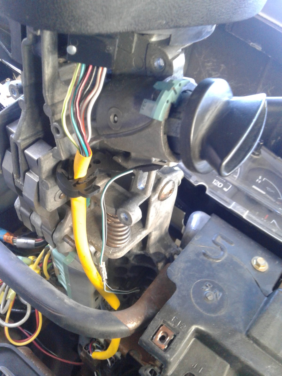

That switch reads the key position I think. It may do just what koda says. It's not a critical piece in that it will strand you. I think the piece that holds it in place has broken off, but it should work fine if you tape it in place. It's properly positioned, or very close to it, in the bottom pic.

98 Explorers have PATS... the part looks like it might belong there except for the connectors are different... I get that I could tape it down, I was thinking silicone to absorb vibration, but I really want to know what goes there... it was born with something there...

When I replaced the steering wheel and clockspring in my '01 Sport Trac this summer, I broke the piece we're discussing here and spliced in the one from the steering column I got the other parts from. I had to think a bit and find the old part just to be sure we're talking about the same part. There's supposed to be a little finger of the plastic that holds that piece in place. It's kinda hidden, so when one pries that piece from it's position, that finger gets broken off unless you know it's there and are VERY careful. That little finger is all that holds this piece in place. The reason I asked about PATS is the PATS module that reads the chip in the key has a plastic ring that fits in the space between this piece and the collar of the ignition key slot. You're probably seeing something similar for the Expedition.
You are correct, that is exactly what I saw for the Expedition... I thought I had it with the anti-theft immobilizer module but not so much...
That parts set was loose/off on my 98 Mercury ages ago, and it would cause a no start condition. I finally discovered that and put a dab of RTV on it to make it stay in place.
