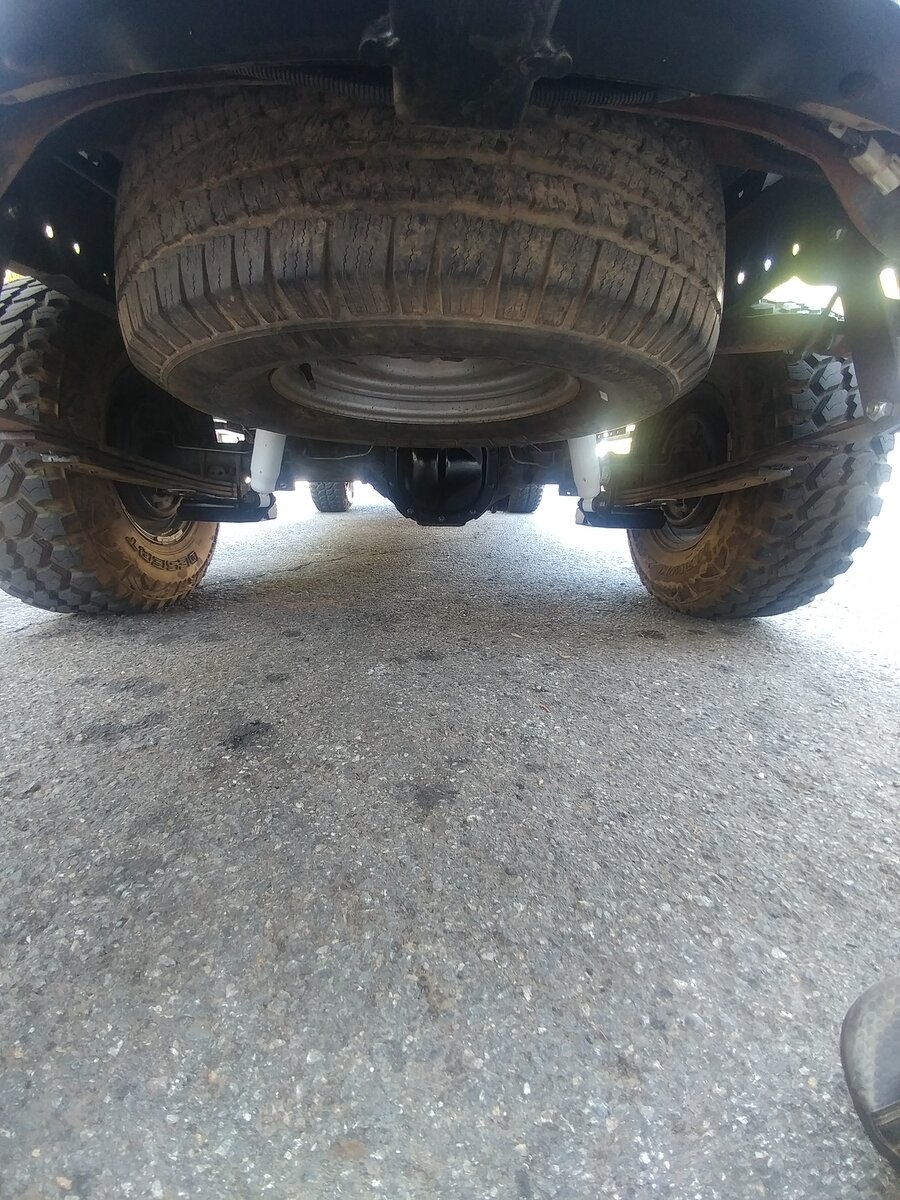

Painted and Installed the U bolt sliders that were made by @Brian1.
Thanks Brian.
The rear sway bar was removed to give room for the shocks since they are a few inches higher now.
After my last trip out the lowest point was my shocks and clearly they got scraped up a bit on some rocks including the factory brackets.
These new sliders with the higher shock mounting points will alleviate this problem.

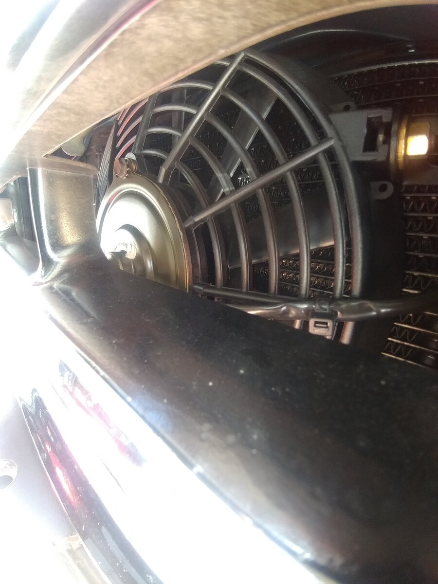

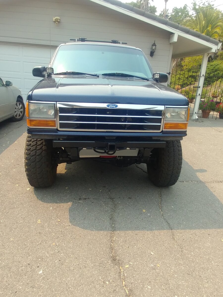

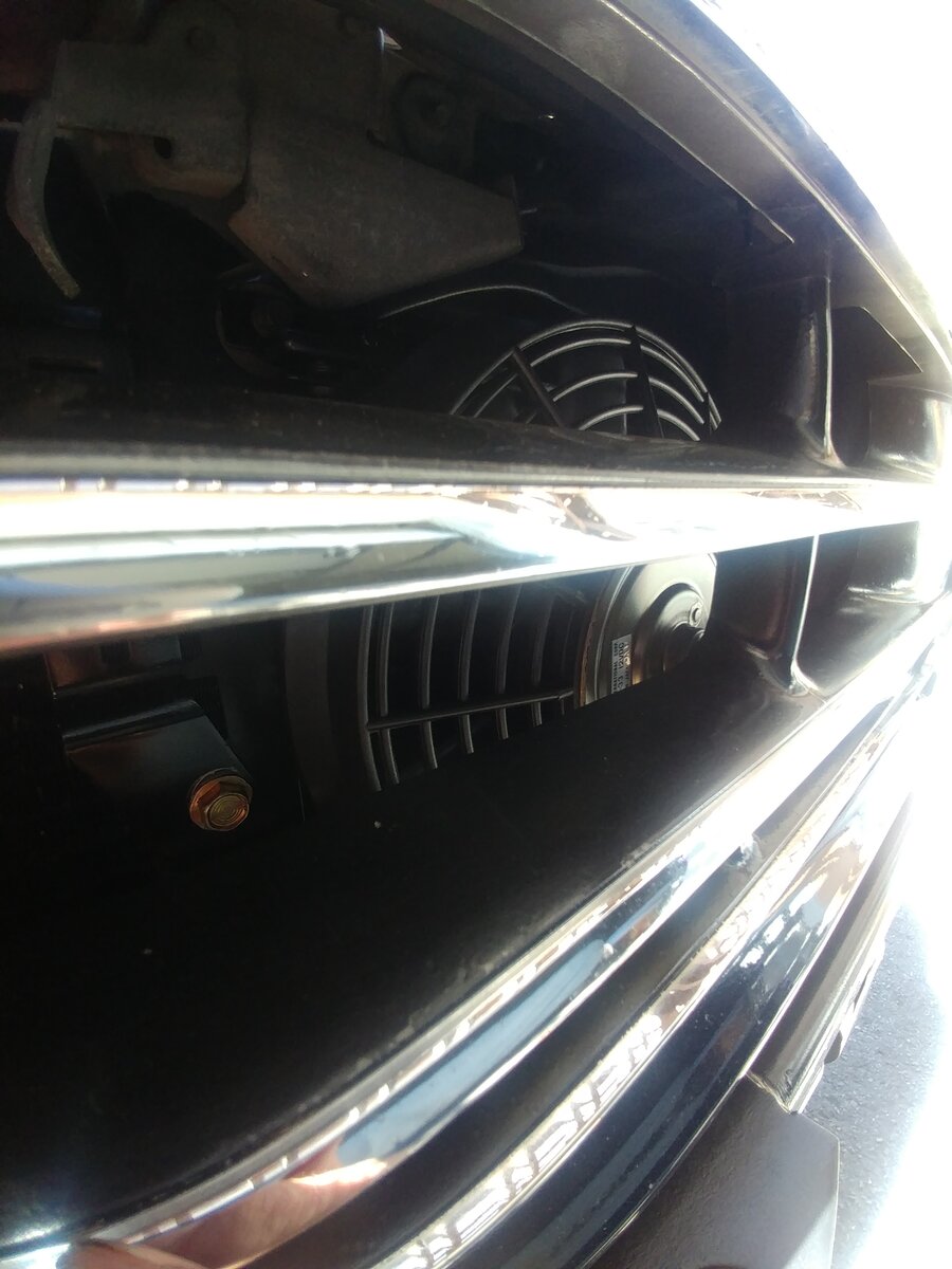

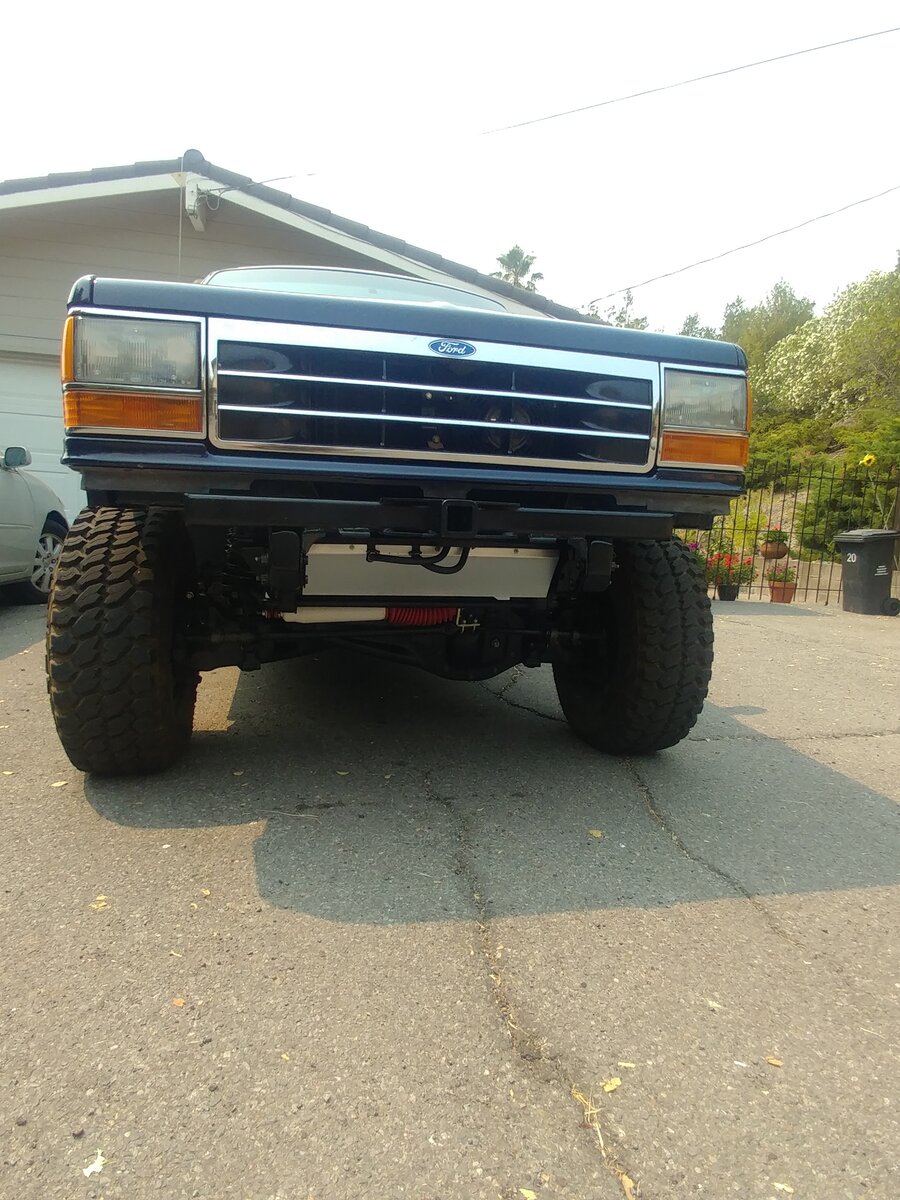

The other day I Installed a fan on my transmission cooler.
I found a Ford NOS fan part # F1TZ-19E736-A on eBay.
The bracket that came with the fan lined up with the holes on the center support brace.
I did have to make some spacers and a bracket on the other side but the install was easy.
I used a relay and used my rear wiper switch to operate the fan.
I removed the rear wiper motor awhile back ago since it was broken when I bought the X and not planning on putting another one in.
Today I made a aluminum plate to cover the open space below the radiator as well.
Pics..
Pics..
I like that no bumper look.

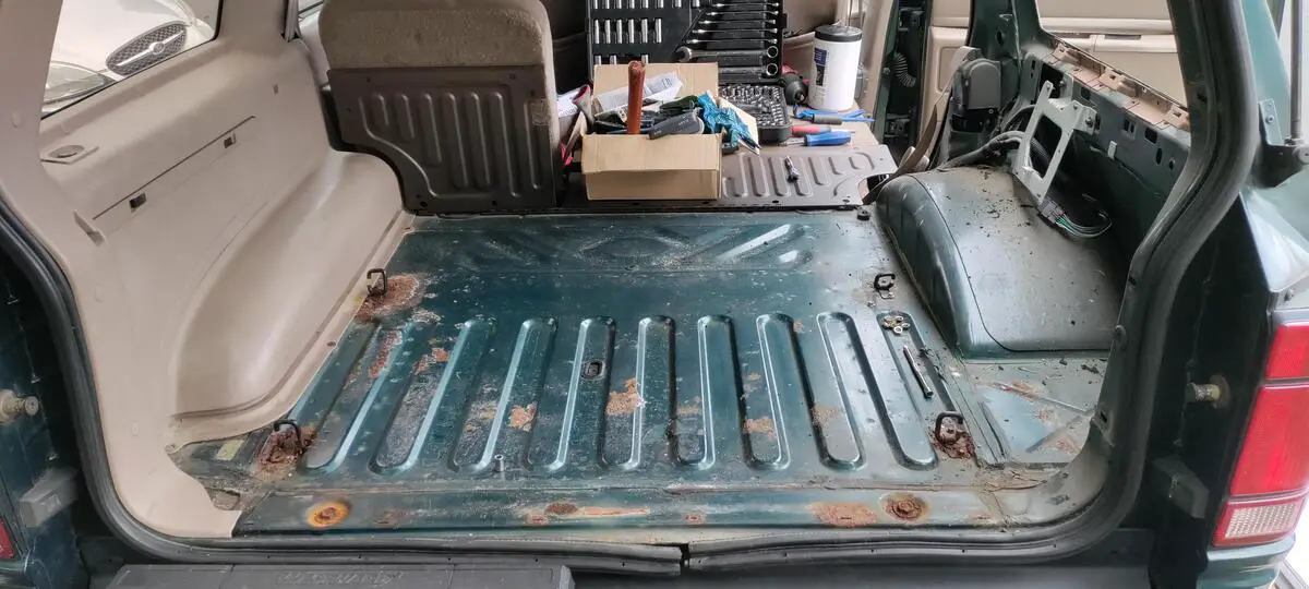

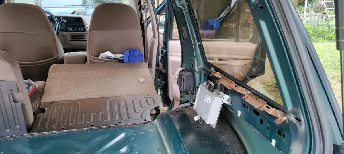

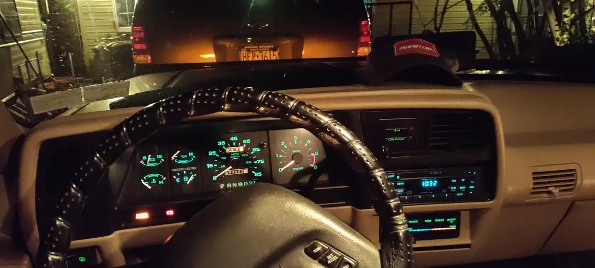

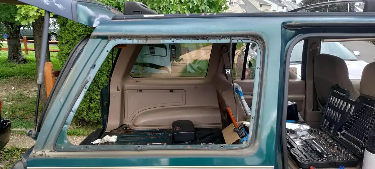

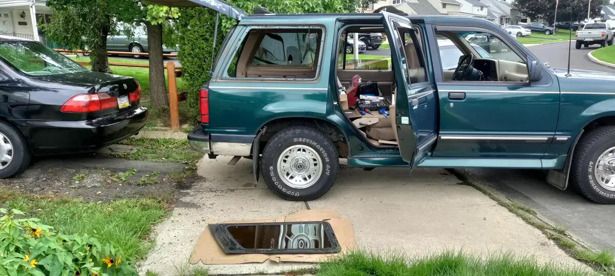

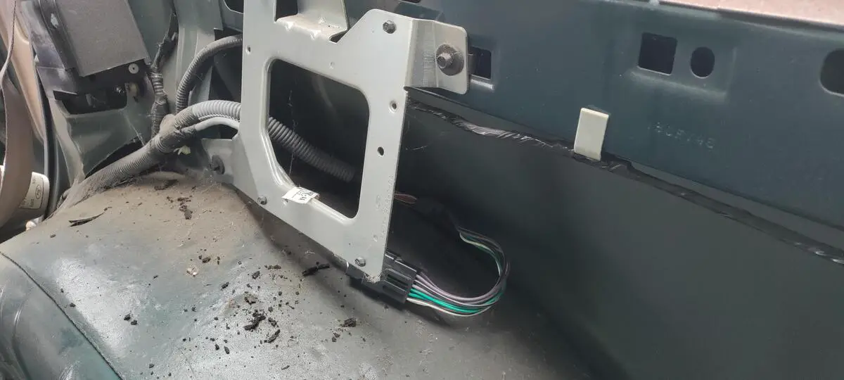

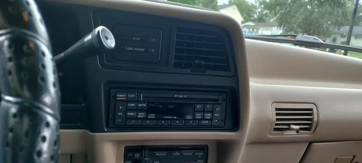

I started a new job a month ago after being out of work for so long and finally have some money to throw around, so I spent the last couple of weeks taking on a few projects that I've been putting off.
I decided I wanted the stock look back to my dashboard and got myself a factory CD head unit out of a Windstar. The head unit that was in it previously was a Pioneer that the previous owner put in probably in 2008 or later. There was a lot I didn't like about that thing, but the last straw was when my new phone wouldn't connect to it after pairing, that and the mounting cradle prevented me from getting the dash apart because of all the tabs bent out to hold it in place. Thankfully the previous owner didn't permanently modify any of the harness, but I found out upon installing it that the Amplifier had been bypassed because all I heard out of the speakers was low level audio that was distorting and clipping like crazy.
I figured since I have to remove the rear section of the interior that I would finally address my leaking rear quarter window as well.
It looks like I'll be having this apart again soon, I have some bad rust spots to take care of.
...and this is when I found out that the amp was not only bypassed, but removed entirely, forcing me to make yet another trip to the only salvage yard that still has 1st gen Explorers.
1 week later (My Tuesdays off are the only time I can make it to these salvage yards)
Amp's put in and it works great! Oh, and the window doesn't leak anymore. Mission accomplished.
It's so nice to have a gentle green (or slightly blue in this case, I don't mind) glow that matches the rest of the dashboard, and I missed the ease of use that comes with these radios. That and I believe it'll hold accurate time after a month and not gradually speed up like the Pioneer did, man I hated that.
Oh, and the third thing I did was replace the overhead console I put in two years ago with another one. The last one had to be either cycled through the modes or tapped to get it to work nearly every time I started it up, and a few weeks ago it finally died for good and wouldn't power up at all. Got this one out of a 97 Eddie Bauer Explorer, which worked out perfectly because it glows blue and matches the display on the radio.
Still got plenty more planned, including wiring up a 2nd gen rear door lock switch (I may do a tutorial on this) and replacing the headliner and cargo carpet.
Very nice work! I notice your stock radio shows the time...Mine doesn't (stock 1998 XLT the cassette/disc in the head) Am I missing something or were there different stock radios..

@JSWarrell Seeing how good of shape yours is in and having rust spot scares me for when i plan on pulling my interior for pressure washing later on after i finish trans rebuild. I had a leak i ignored for awhile not having time now im worried it was leaking before i noticed and it might have rust. I fixed the leak quit awhile ago but never checked for what damage it caused stupid me!

@joney I don't know, this one was out of a 98 Windstar. I thought all Ford head units displayed the time.
@MakinJeepsWeep! Yeah I feel you, I think mine was leaking for a while before the previous owner sold it to me. I ended up ignoring it further for about two years before I finally got around to fixing it. This thing's got plenty of rust spots in other places as well, but I plan on learning how to weld in the near future and patching in my own steel to fix it.
