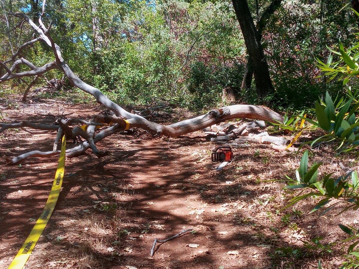

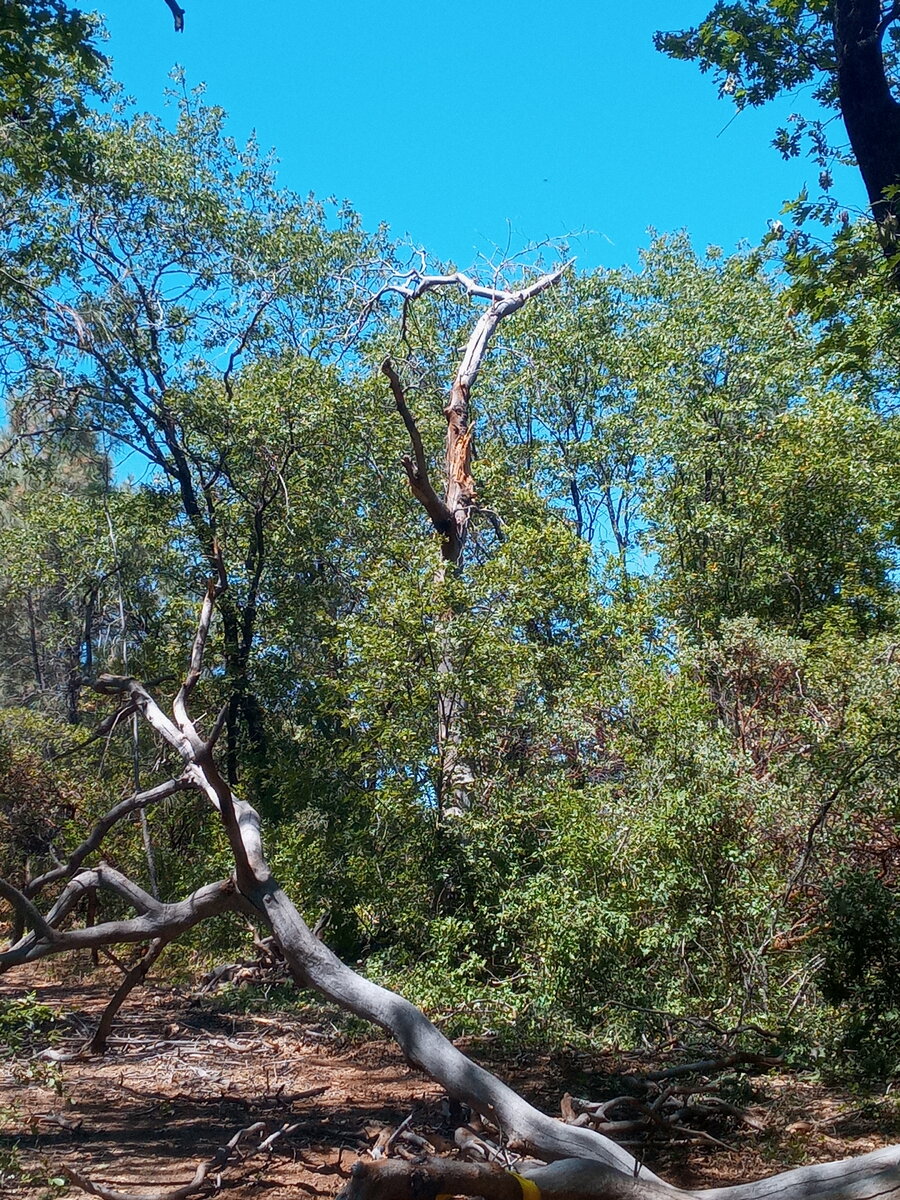

Wednesday I used the Explorer to rip off huge branches off an old oak tree. These are pictures of the second branch I yanked out. A lot of work to get the tree down.

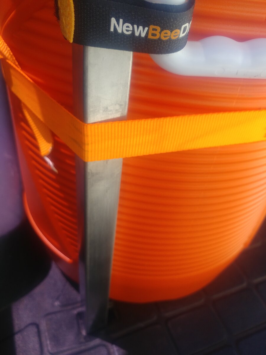

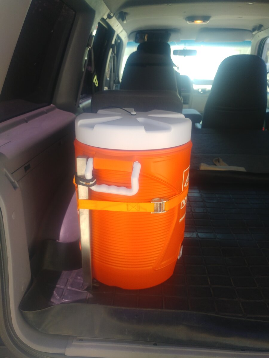

I fabbed a post out of 1x1 that bolts up to where my cargo hook was.
Now my 5 gallon water jug doesn't slide around now. It swings out just enough to use it without unstrapping it.

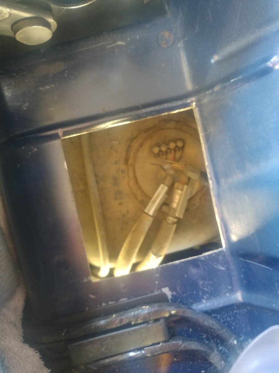

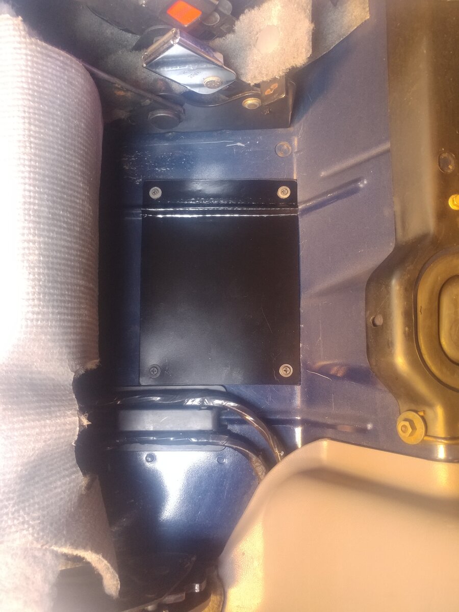

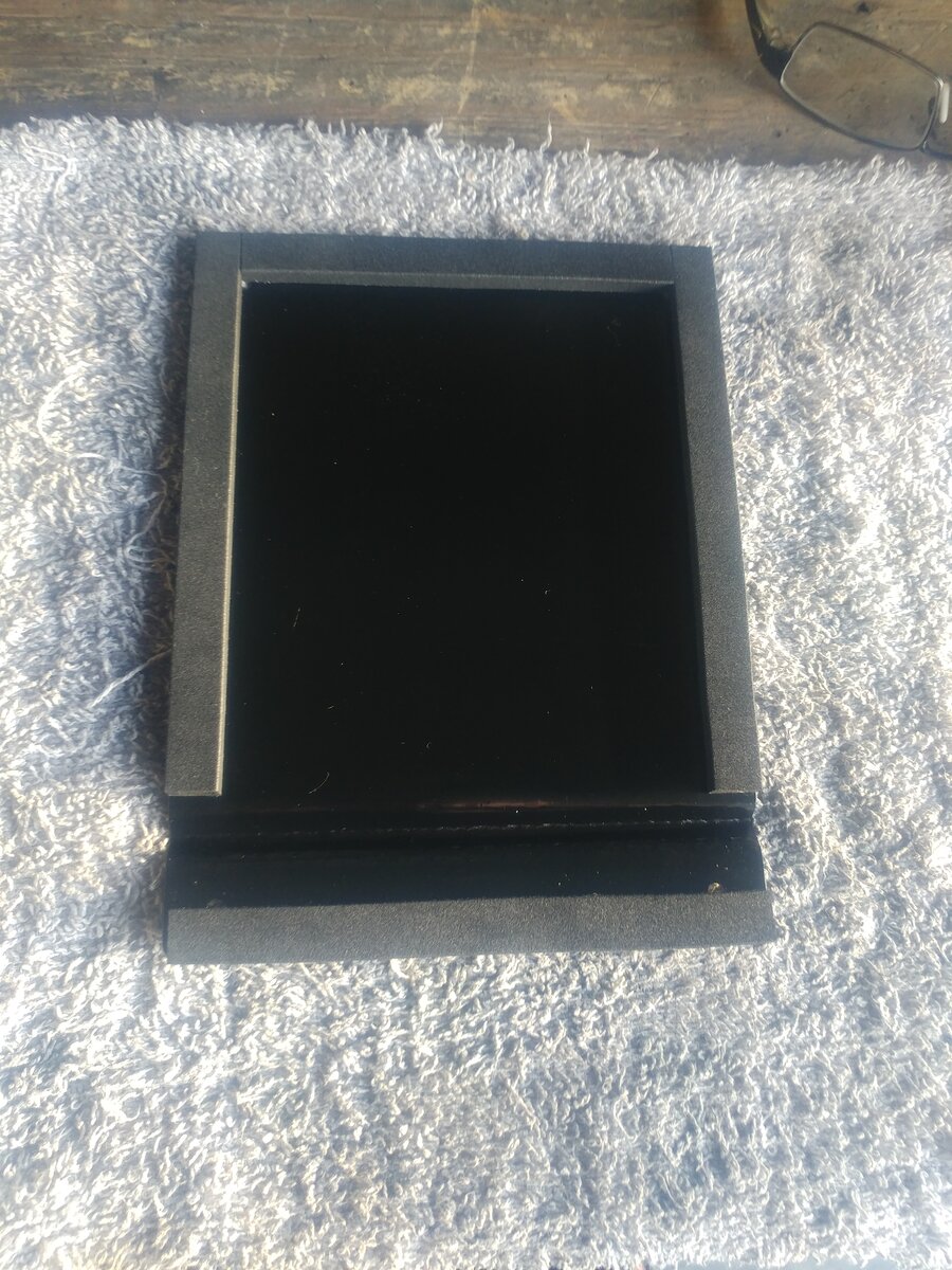

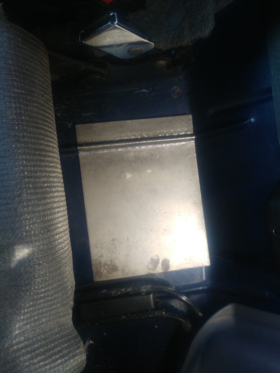

Cut out the floor to access my fuel pump and made a panel.
I'll finish it up tomorrow with paint and seal it and screw it down.
I know someday this pump will give out on me, so I figured do the access panel now and later I'll replace the pump when it shows signs of letting go.
I have no clue if this has ever been replaced from the former owners.
I didn't have to cut the hole to large due to having a 2 inch body lift on it, easy to reach and plenty of room to get it out at an angle.

I was able to finish it today.
When I replaced the body mount bushings a few months ago, I realized how easy it is to drop the tank so no access panels for me. Nice job, but I wouldn't be cutting out the floor if I didn't have to just in case the fuel pump fails. That is one of the cleanest jobs I have seen though.
That is very nicely done. The body lifts helps, every other one I've seen I'd call a hack job, rough cut edges, and a poor cover piece.
