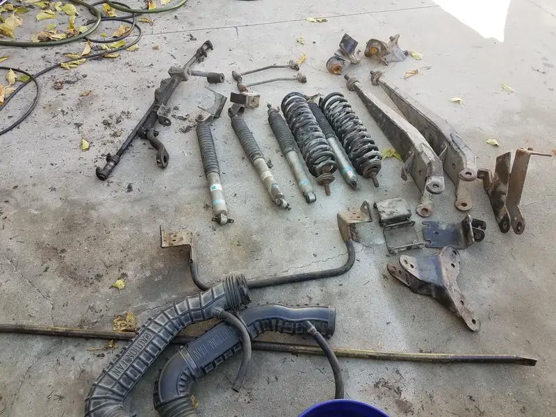

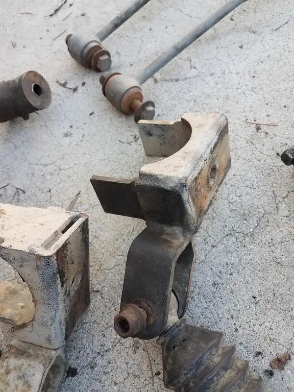

Anyway. Went to junk yard. There was a recent junked '94 , turned out had full lift kit and stabilzer. The SOA was no weld/ custom brackets. Does anybody recognize who made this kit? There are part numbers stamped on everything. Couldn't take that skid guard as no grinders or torches are allowed in the yard and it was welded to frame.
The front brackets were common to the ranger 4 and 6" kits. The long radius arms were an option of the 6" kit, so id be surprised if this one is 4". I think they used the SOA for 5.5" rear lift hence the name of the lift. If you wanted 4" on the explorer, i think you got longer shackles or new springs or something. I really don't remember. Its cool you got the super runner steering kit too. Someone spent some $$ on that truck at one point.
I've had Issues with my idler arm. I cant keep bushings in it. Im sure its an alignment issue. They were rubber/nylon/poly something from original. I machined the frame end of the arm for a custom bronze bushing and grease fittings. It works for now until I SAS the truck.
Yep, Superlift Superrunner kit with steering. I had the same kit except for I used Skyjacker drop bracket on one side as it was cast and not welded plate. The radius arms were an option for the 4" and up kits, since I originally bought them with a 4" lift kit. Those rear SOA flip brackets are Superlift. I have them on mine still, but they are now welded to the axles because one side collapsed and they like to shift around, putting a groove in the axle tubes. If you install them, run a bead along the edge of the perches and they won't move.
Edit: If you cut the rear radius arm mounts off and fab up some heim joints mounts they will flex a lot more. Added bonus of never having to replace those rear bushings again.

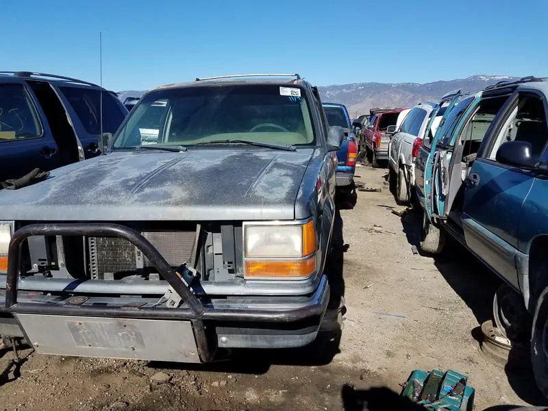

kind of a mystery. There was no damage to I saw except the front right spare. It was an auto, the a4ld was dropped out and I think there was a 5r55e in the back. Interior was not in bad shape. Didn't catch the mileage.
as it came on the lot:
as it came on the lot: View attachment 425100
