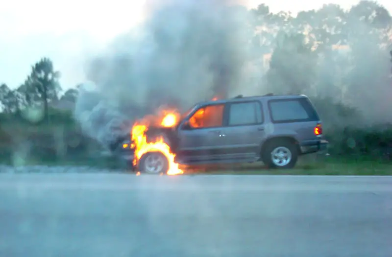

I was driving to the store behind this Explorer when all of the sudden, it started smoking, and within under a minute, it was up in flames.
The flames got much worse than what you can see from the pic.
I was wondering what was wrong with it that it could have done that?
hmmm
No its a 95-97 due to the mirror tint and tail lights, so the cruise control might not of been the issue, needless to say i feel bad for the driver

There is probably an endless list of why this could have happened - but even a bad grounding wire can lead to a fire when for example, the body tries to ground itself to the engine block (which is where the alternator is bolted to and is part of the circuit) because it naturally sits on rubber body mounts.
But, don't the body bolts that run through those bushings conduct electricity? Seems like a half-dozen or so 1/2" bolts should provide sufficient ground, and if they don't, then wouldn't the chassis ground cable?
Funny how every Ford under-hood fire is automatically attributed to the SCDS. As IZ mentioned, there any number of a zillion possible reasons completely unrelated to the speed control that could cause an under-hood fire. There's just no way to tell from the remains of what's left, especially from a grainy cell-phone camera image.
The bushings are two pieces and there is rubber on both sides that sandwich the welded chassis mount.

Yeah the chasiss ground cable is what its there for but that is a single point of failure and if the ground cable is corroded or whatever else happens to it, then the chance of starting an electrical fire increases significantly.
I've seen this happen on my brother's Suzuki Samurai and maybe half a dozen other people on Pirate4x4 has have witnessed fires caused by improper grounding. But on the Samurai, the two paths the ground was taking was the clutch cable and/or the E-brake cable (depending on which lever was making a complete circuit). When electricity would go through the clutch cable, it would have so much resistance at the cable mount (on the trans) that it snapped two clutch cables on the same day. And when the ground was going through the E-brake cable, it first started smoking and half a minute later, the E-brake cable (which is often coated in undercoating -- which is flamable) was on fire.
