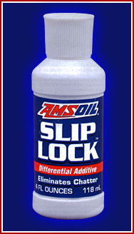

Well, to be honest-I first used it to quiet chatter in my awd transfer case-then I have used it in all diffy changes, not for noise issues, rather to help the differential operate freely. It doesn't hurt anything, but sure can help.
I would use the friction modifier if a had a traction lock. I don't because my Zexel Torsen diff's have no clutches. :

Amsoil says its not needed with their gear lube UNLESS CHATTER OCCURS
>>AMSOIL SEVERE GEAR® is compatible with most limited slip differentials. If limited slip differential chatter occurs, add AMSOIL Slip-Lock™ friction modifier additive.<<
As Jon says, I doubt that it will hurt anything ( my concern is mileage only ). Use it if you like; I just have seen no need for it.
