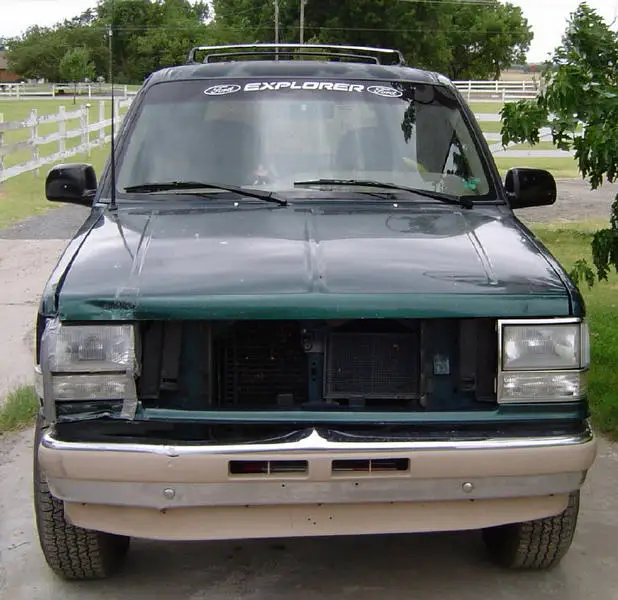

ya, here are the pics, im having trouble with the pass fender though....anyway.
before
after
