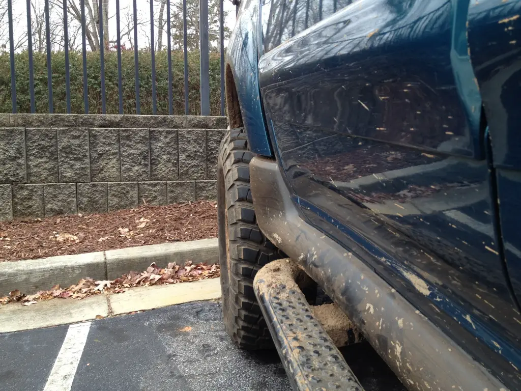

Here ya go. Its way different than the sport would look like but I just snapped some real quick after class.

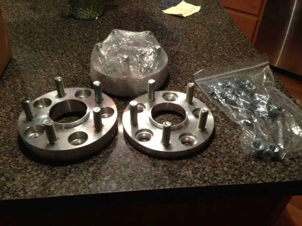

Thinking about getting 15mm or so to the wheels flush and a little more aggressive looking. Bolt pattern 5x114.3 right?

Here they are. 15mm front, 25mm rear.
Looking good Bstollmaier.
They look good! But most important, how is the ride with them, any noticeable differences, shakes, or wobbles?
Thanks. Just rode around the neighborhood and it was smooth as silk. After work tomorrow I'll take the wheels off and re-torque the spacer nuts.

How did you come up with the thiknes of the spacers? Did you had to trim the original studs?

The ride on the highway was perfect. Couldn't tell they were there. I did notice in the turns it doesn't roll as much. That was very evident. Guess it makes sense with the rear 2 inches wider and the front over an inch. The original studs do stick past the spacers but my wheels have a deep pocket between lug holes specifically for that purpose. I think all aftermarket wheels do. I believe the factory wheels do also but not as big. To measure I held a plumbob to the center of the fender and let it hang, that way I had a perfect vertical line from the center point on the outside of the fender. Then I measured from the edge of the wheel to the inside of the string using calipers. Obviously you could use any measuring device but I figured calipers would be the most accurate and I had them on hand. If your setup has the tires sticking past the wheel then you might want to measure to the tire instead of the wheel. My wheel and tire are at the same depth.
