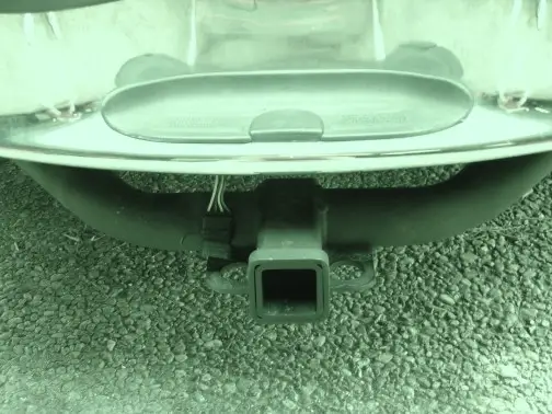

DCExplorer said:I looked at mine again last night. My reciever is only about a half inch below the bumper. It is also recessed about an inch back in under the bumper. Very hidden, and I couldn't be happier with it. The orginal stickers are still on my hitch, so maybe I will look for model number, manf date [purchased 2002], or something like that. The only thing I can think of is that the 98 and 99 had different holes in the frame. If so, I would think Hidden Hitch would make different hitches for each year. They don't.
DCExplorer said:I also have the Hidden Hitch brand, but it is on a 98. Mine is higher and more recessed than the above picture shows. My bolted right in with no drilling, but I couldn't get my 16" spare back in place without some cutting and modifing. The hitch shipped with a little piece of paper that said it didn't work with a 16" spare, but I didn't know that when I bought it. Instead of sending it back, I decide to make it work. If you have 15" rims, then no problem.
Lee S. said:Etrailer.com shows 2 different models for 98 and 99 Ex's. One fits a 16 inch spare and the other will only fit a 16 inch spare with modification. Aldive probably has one on model while you and I have the other.
