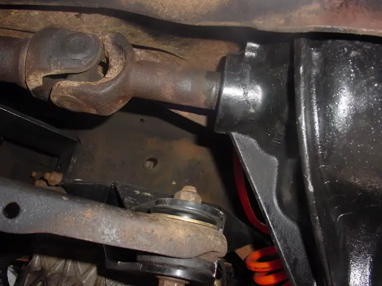

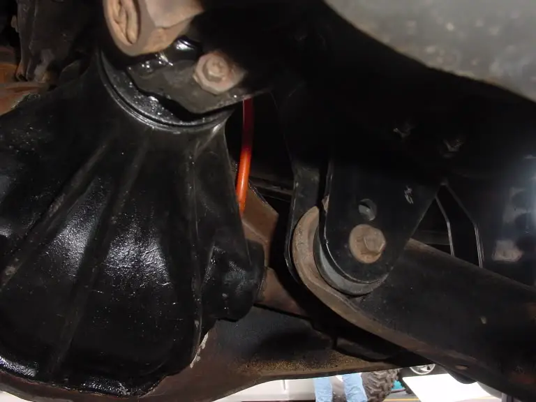

I don't hit at all.
Here is how she was posed in them pics.
