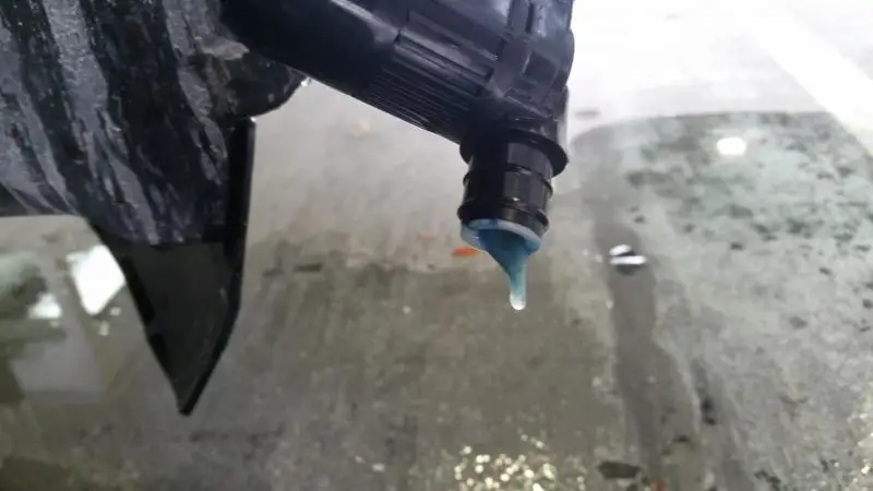

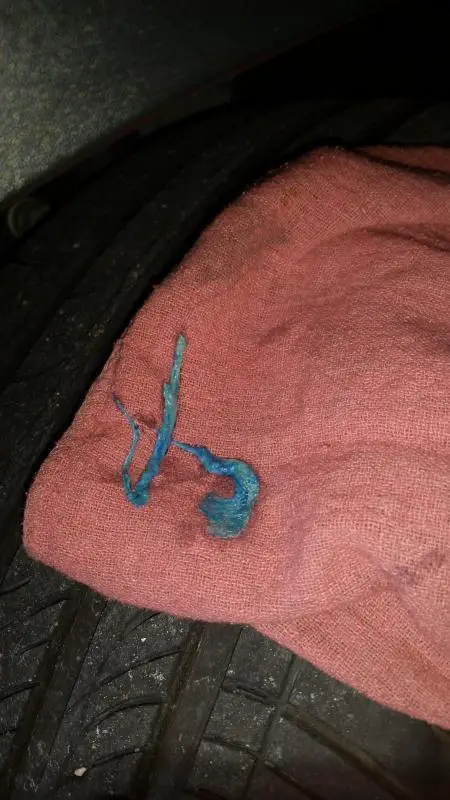

So I was able to go today. The service guy was very nice and ended up taking care of it without issue. He showed me the gunk that was on the filter side of the washer pump. Neither of us have seen this before. Very bizarre. He took care of it no charge and the washer is working again. I will post pictures when I get back to my computer, I'm on my cell phone now.

I've never seen anything like it. It was very slimy, almost felt like silly string? He dumped out all the old fluid and refilled it. It should be good to go. I checked my bottles of washer fluid and they had no mystery goo in them, even poured the one I'd been using through a strainer. Oh well, I'm glad its fixed. Thanks for the support.
