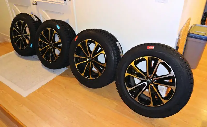

New winter wheels & tires
Just got them today from Tirerack. Will be putting them on once the temp starts to dip into the low 40s or so.
18X8 Enkei Performance SVX
235/65 Bridgestone Blizzak DM-V1
Basically wanted something that looks similar to the stock 20s, not too cheap, not too expensive. The DM-V1 seems to be among the most loved SUV winter tires.
I don't think I've ever been excited before about purchasing winter wheels and tires. Not sure why. At any rate, I had to share my purchase.

I'm putting on my winter tires next week. I was going to wait until the week of the 17th, but cold and precip is forecast for next week beginning on Wednesday. Seems like a good time to do it.
Looks sharp. What was the total damage if you don;t mind me asking. Did you get TPMS too?
After shipping it was $1500. (EDIT - $1,663 with shipping). Yes, got the TPMS.
