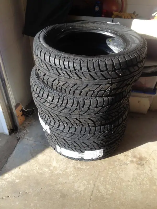

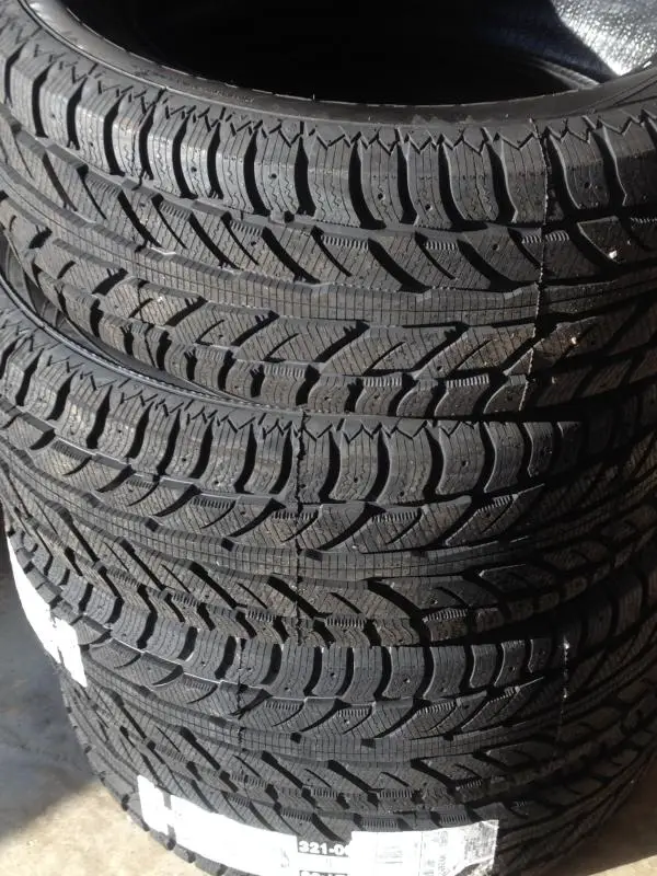

Winter Tires for the XLT
I bought 4 Cooper Weather-Master WSC winter tires for my XLT. 245 60 R18 same as original size. I received them yesterday but will probably not have them installed until mid-November.
They look good, and look like they should have good bite in snow. Time will tell.
