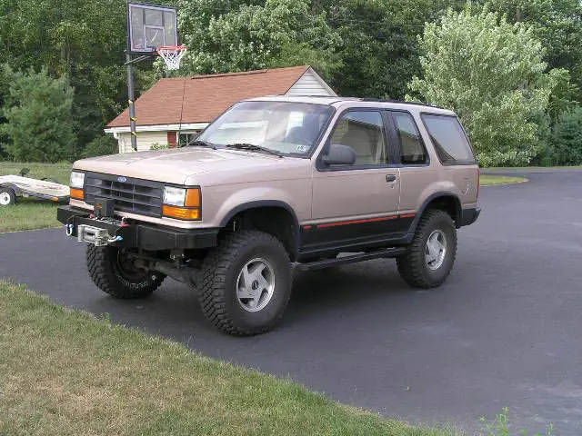

Yeah. The 8" with the 3.75 back spacing will work real good. But if you're going with the 8" wheel, then you could go with the 33x12.5 tire which will look just like this.
This is my first explorer right after I put a 4" lift with 15x8" wheels with 3.75 back spacing and 33x12.5 bfg ATs on it. I didn't have to trim anything.
What Froader said. I'm running 33 x 12.5's on the stock rims, and it's fine. I probably should be about an inch wider to be perfect on the rims. BTW, I didn't have to trim either.
