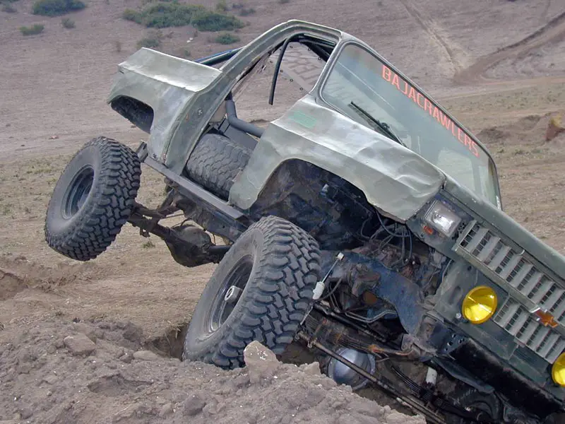

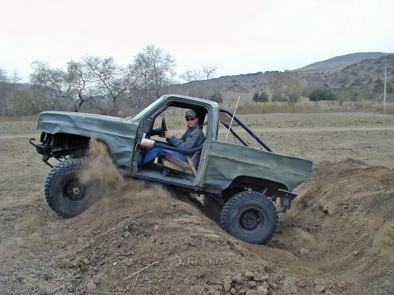

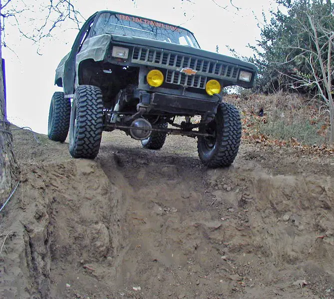

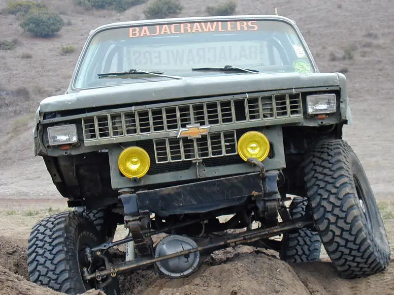

Here are a few pics of Tom & his hacked Blazer in the obstacle course. They are still building it and will add water to the mud pits & more rocks to the rock garden, but its still pretty fun as is;

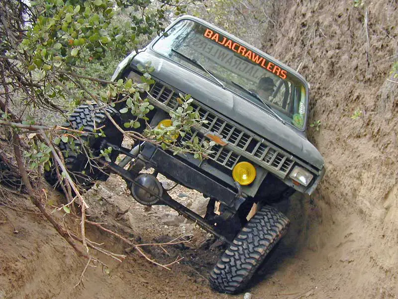

These next pics show Tom dropping down into the arroyo to the point of tilting so much his carb stopped working I & had to go in & pull him back upright.

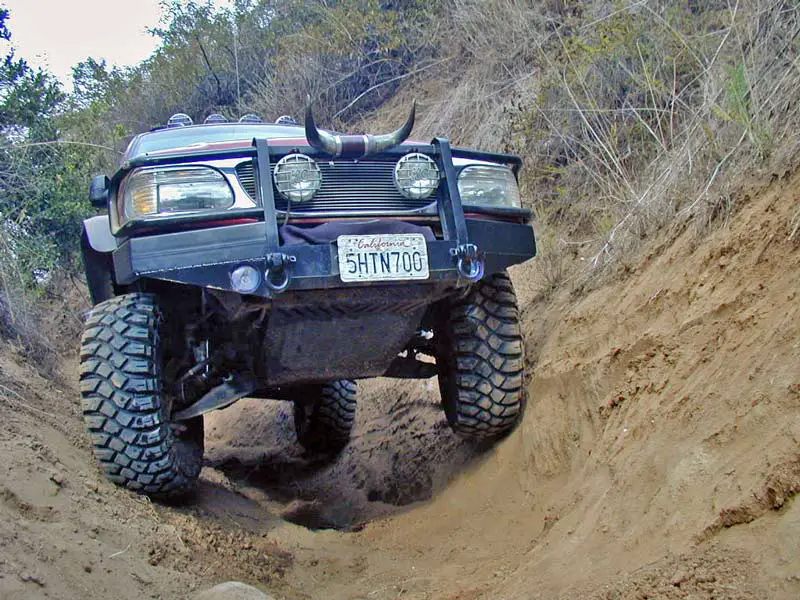

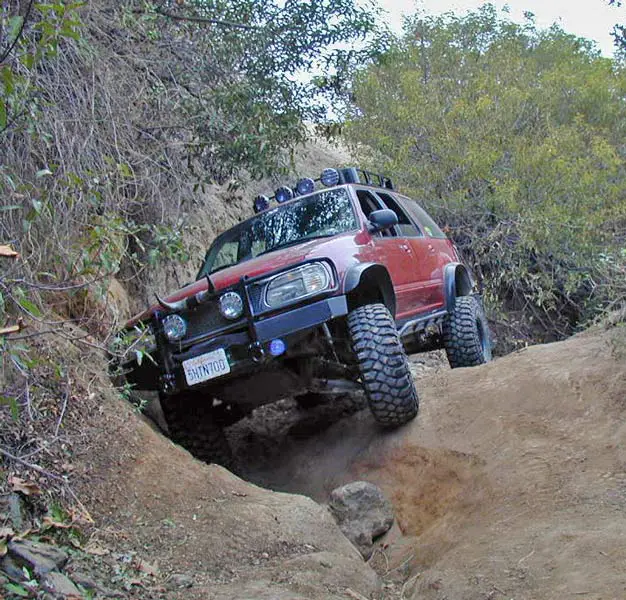

And, here comes Super IFS Man to save the day! Little did I know what was in store for me...:eek:

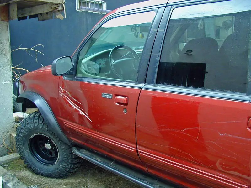

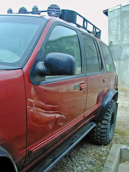

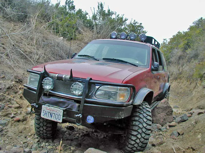

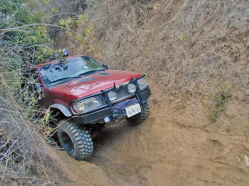

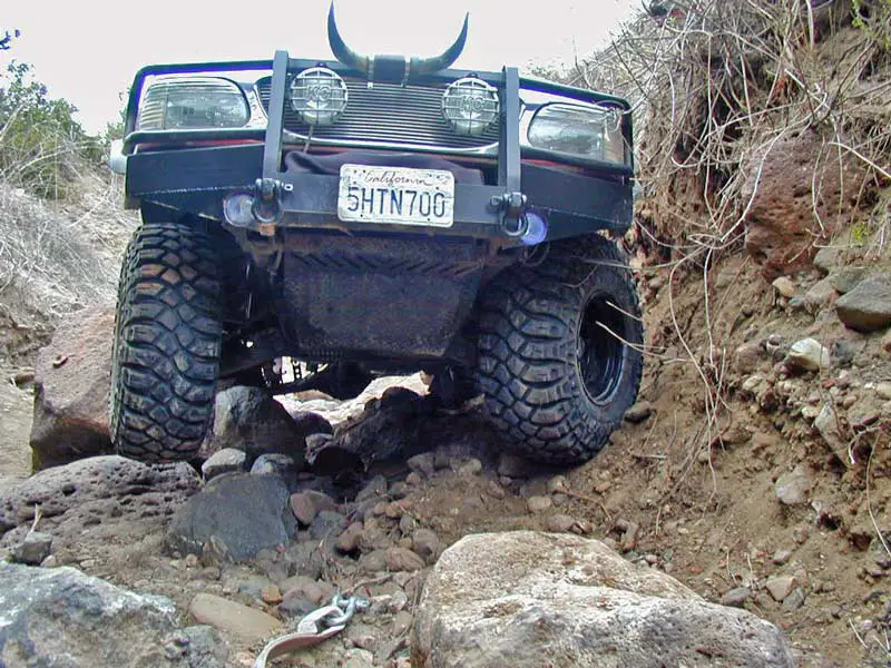

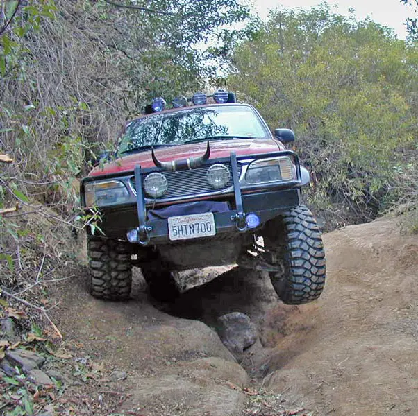

So far so good;) the places where Tom would just lean over & push through, I had to straddle & go slow, I did scrape along one wall & put a nice "Jefe Stripe" in my driver door. And there was a good size rock that gave my sliders a work out...

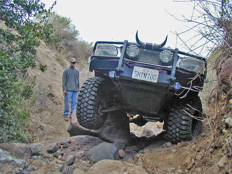

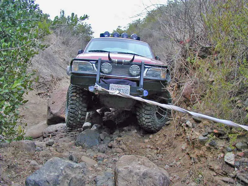

And then, there it was, right in the middle of the arroyo...The Rock That Ate My Truck!
I gave it my best effort, but everytime I got up on it, I slid to the left & forced my drivers tire into the hill. With the front locker bound up, and the rear locker only sometimes working, I tried to force my way through & that was when I heard that funny little "snap" & said, "yup there goes the axle.."
So now with a front axle gone, I decided to give it one more go & hit it hard to slide over once I was up on the rock again... well, the same sliding to the left & jamming the tire into the wall & this time I heard another "snap", that's right I broke another of those "heavy duty Chevy tie rod ends" just like at Moab:eek: I thought since I was helping a Chevy, the Chevy Gods would smile on me, but nope... I had a good mess on my hands.

It's a good thing Tom was up and running again as he towed me out of the arroyo after I replaced the tie rod end, then I drove to a friends shop to replace the axle. I'm glad I carried all the parts with me, but I'm ready to start the solid axle swap on this rig as I'm tired of getting high centered on everything and breaking my front end all the time.

Crazy pics and story Chris. You're right though, any wheelin is good wheelin. I was waiting until you were done before posting. That does look like a "Jefe Stripe" on the door. :)

Same side TRE broke again. Where did it break this time? I am wondering if a limit strap on the front end will help save some of the carnage till you get to do a solid axle. You have a long ways to go on that driverside till it gets a good jefe stripe. You got a good start going though.
Looks like it to me. Seems like it reached the max angle and it went snap.

The tie rod broke in the same place as moab and Steve, that is one of your axles I used to replace the broke one, THANKS:D
I think a lot of the problem is the weight of these tires, they are big biased ply tires & with the steel rims, they weigh a ton! I've read on the Pirate board that even stock Dana 44's are having trouble with them...
I can see some rubbing in the shock mounts that stick out from the frame too, that, and the locker binding make it super hard to maneuver sometimes.
I was just about to order some light weight alum. rims with less backspace, but now I'm just going to start the SAS & be done with it.
Yeah, a few dozen more like that and our trucks will match again. :D
