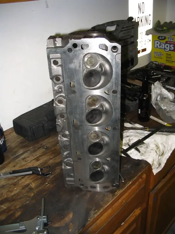

So its (almost) everybodys favorite time of the year, tax time. So my mountaineer is in need of a little help.
The DL.
-98 mountaineer, 4406, 265/75/16s, 16x8 Procomp polished wheels, 4.10 gears
-278k on orignal motor/transmission
So a friend of mine has a bronco 2 w/ a 302 that he put in new a year ago. Hes putting in a 347 so i get a good deal on a short block 302 with just over a thousand miles on it, timing chain set, e303 cam, lifters, oil pump.. etc.
So my question is CAM/HEAD choices. Idealy i would like to keep my heads. He has some knock off edelbrock alum heads he would part with and with my tmhs i highly doubt they would clear the plug location on the alum heads.
And reading through posts here the e cam is a bad choice for the weight and head design of the gt40p heads. (correct me if i'm wrong)
I am planning on talking to a cam grinder and seeing what the best way to go is, but i was hoping for some input from you guys here as you helped me with my tmh install and head recond.
