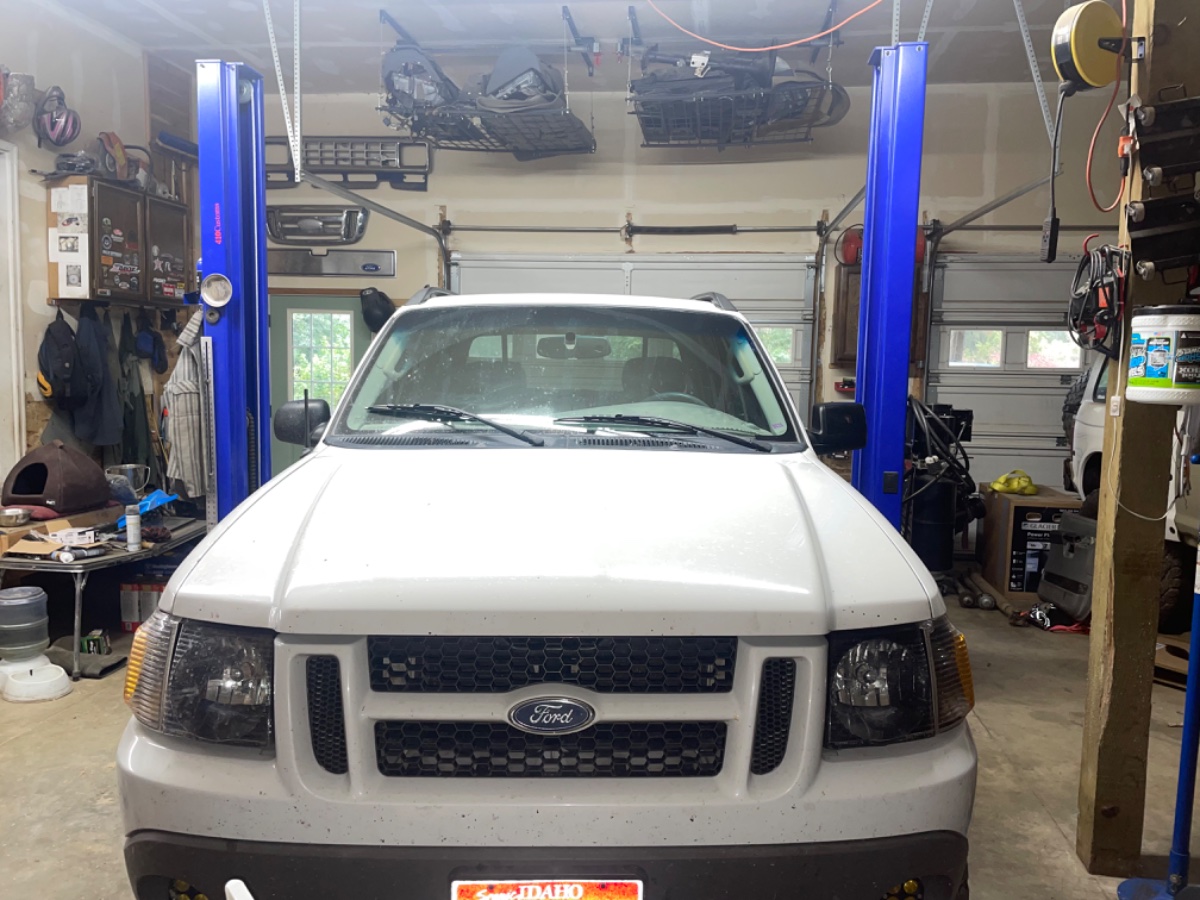

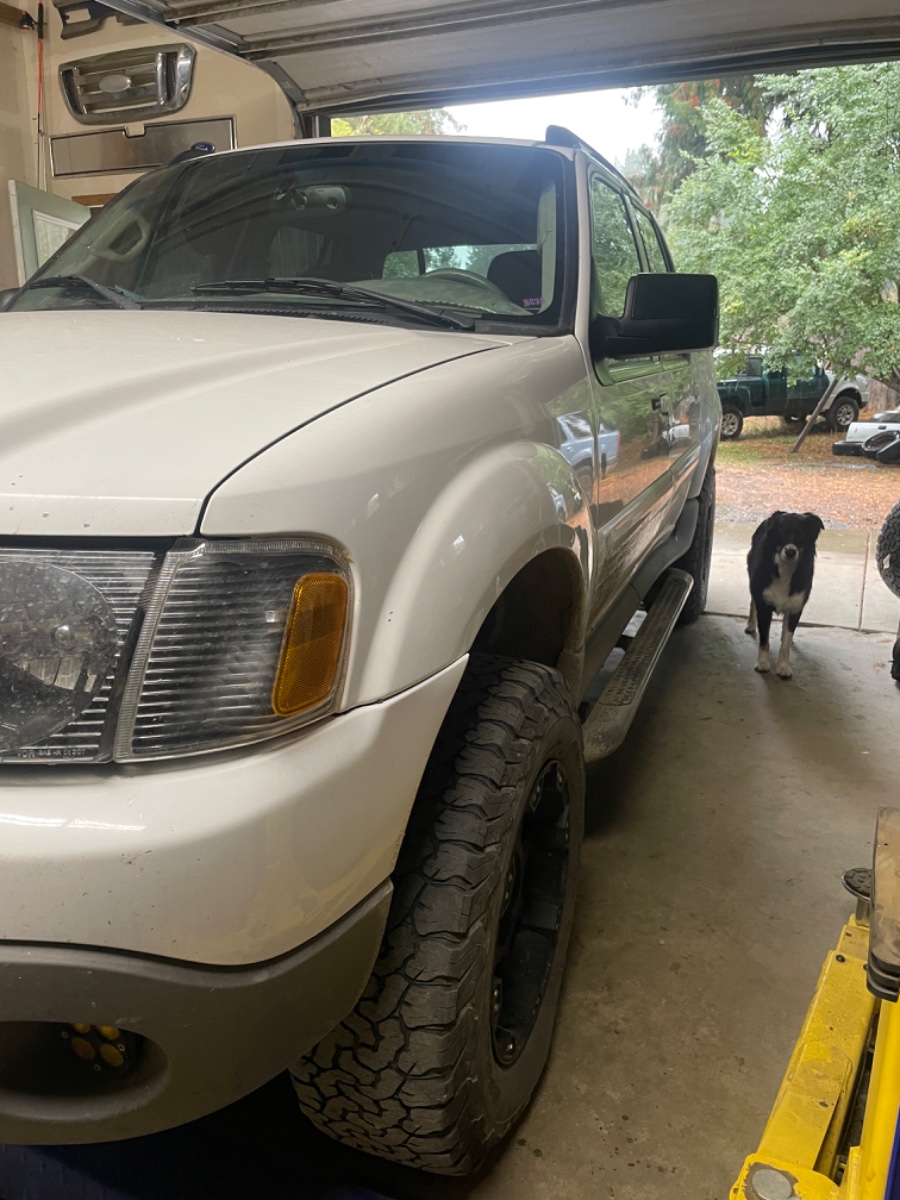

Sport tracs are the best of the best!
Explorer with a bed and a power down rear window
Composite bed and body panels = less rust
They are spring under rangers basically and they ride fantastic. They also look like a 4wd mustang = sporty
The problem?

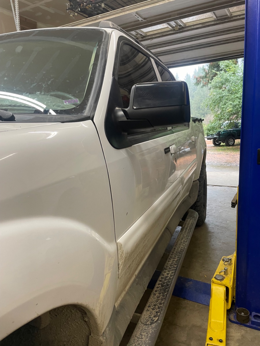

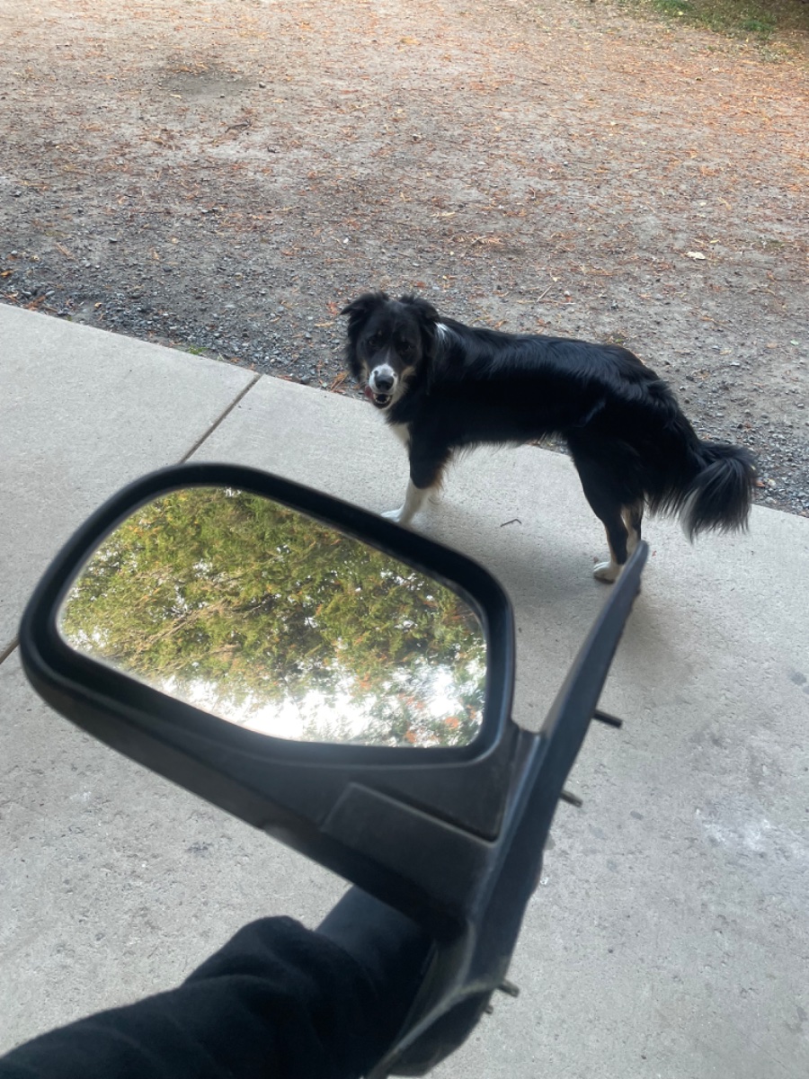

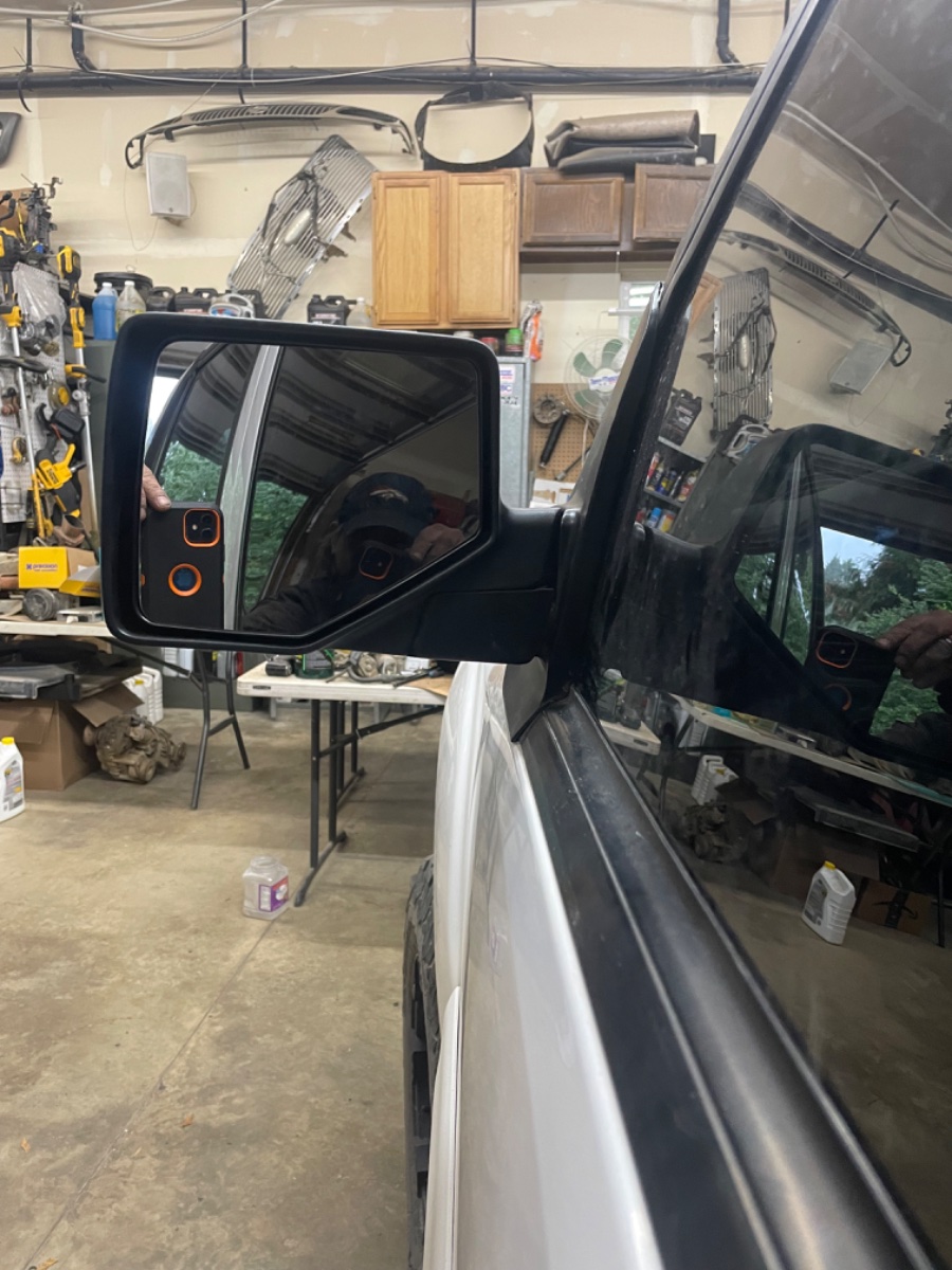

The side mirrors are “meh”’

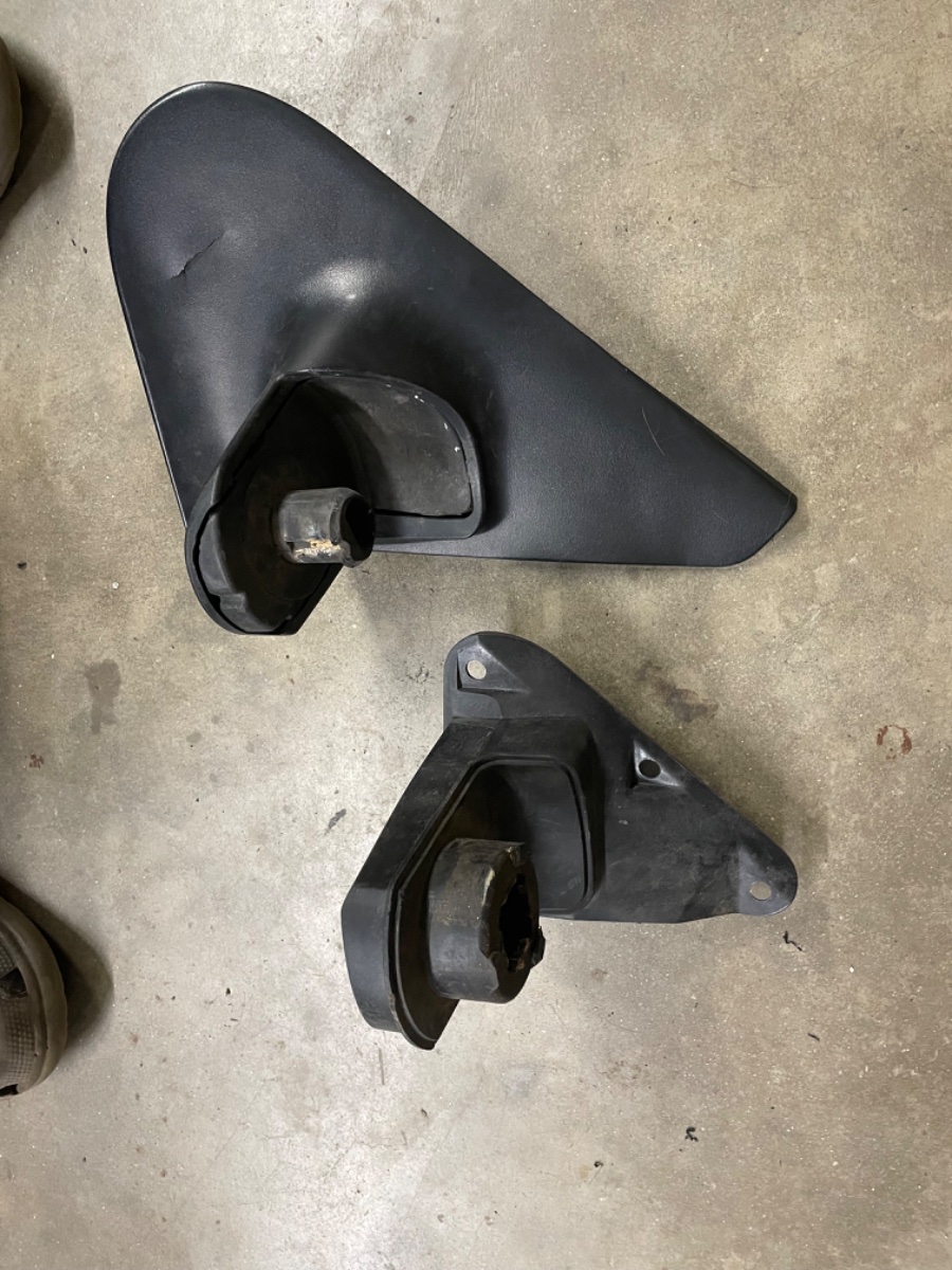

No options, I know I checked. No other ford mirror will come close to bolting to the door

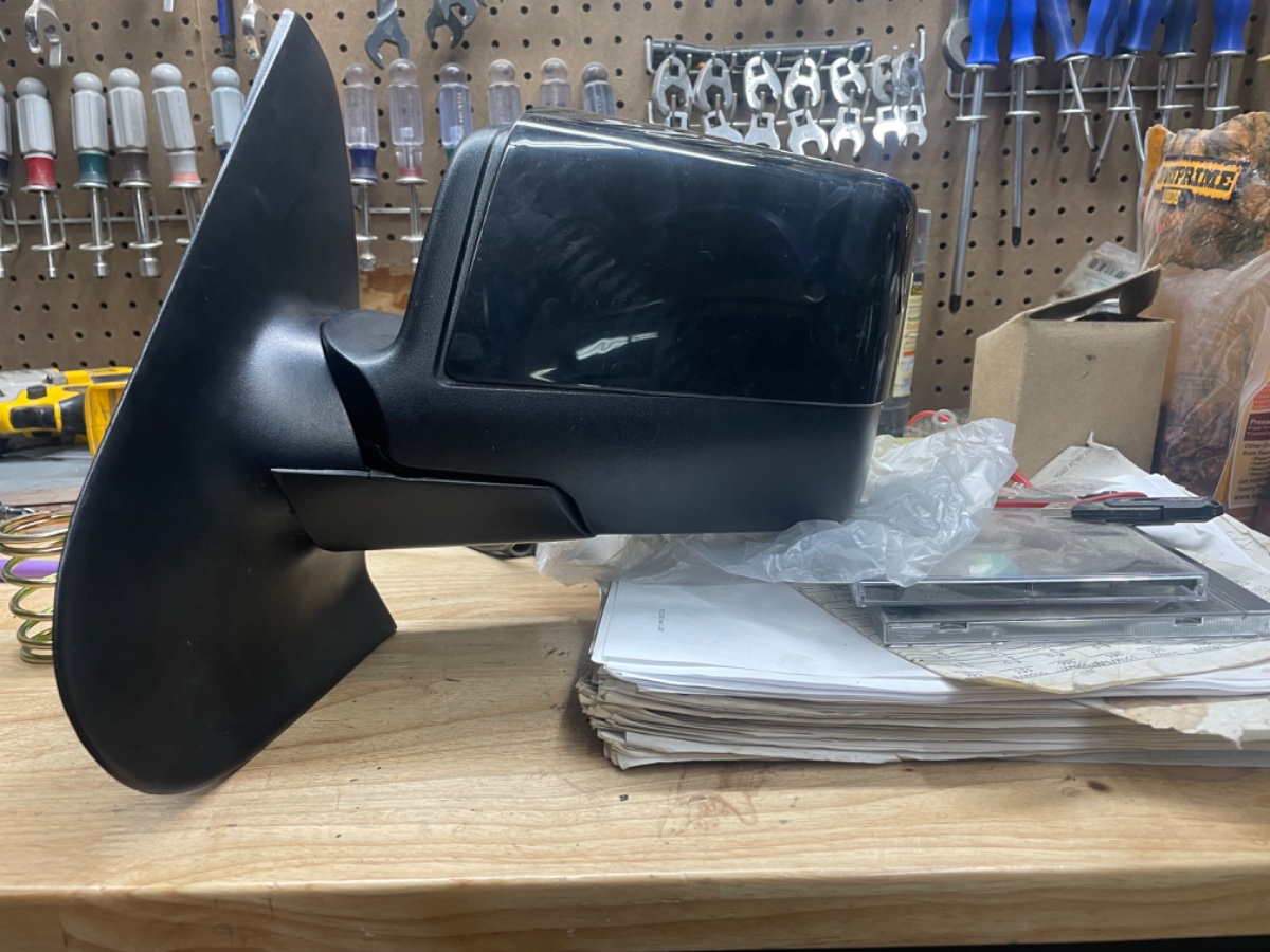

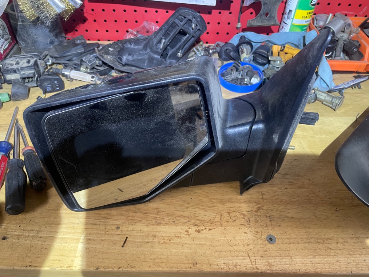

The 06-11 rangers had square mirrors that are much larger with more vision and they look super awesome.
So naturally everyone with a hot rod sport trac (all 6 of us) have been wanting this

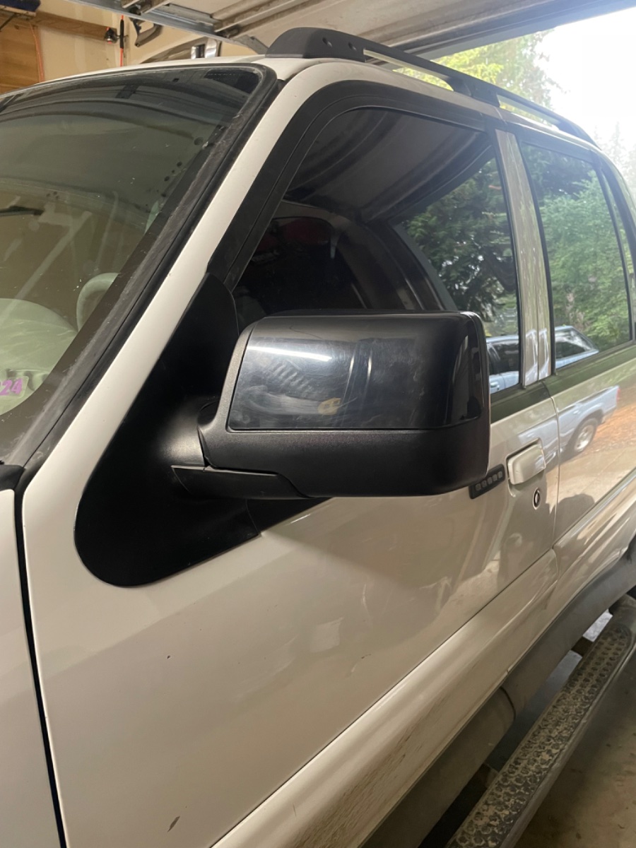

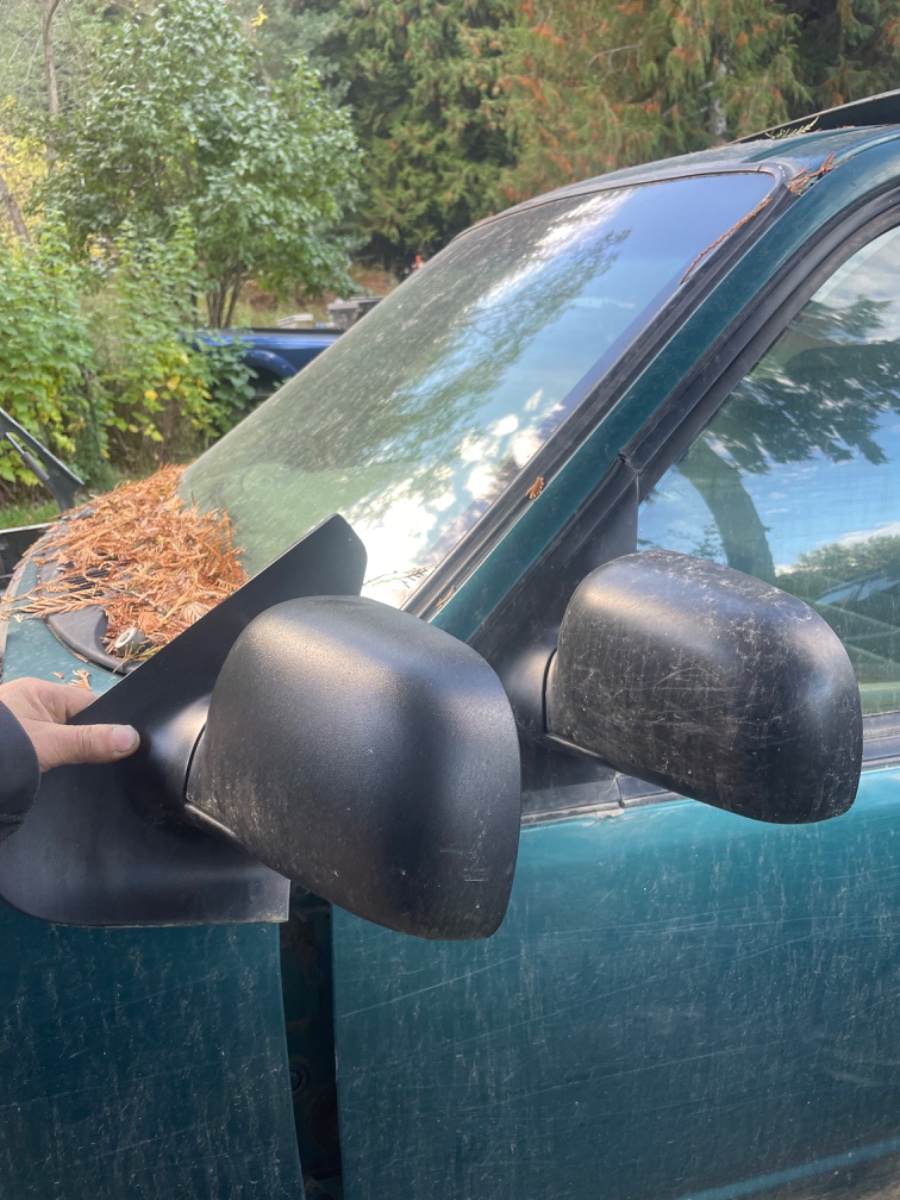

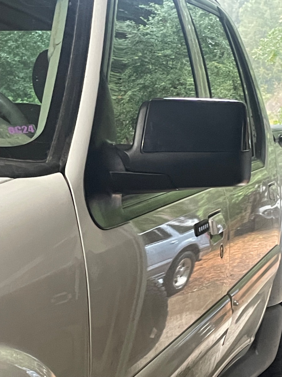

So I made it happen

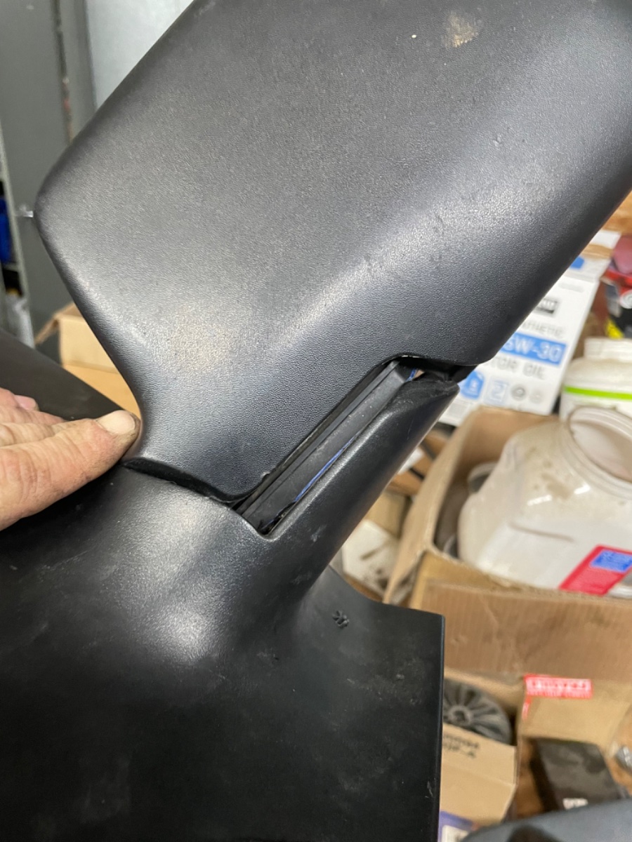

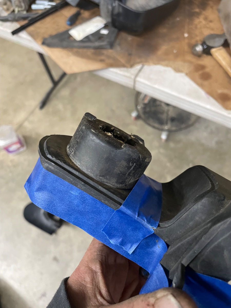

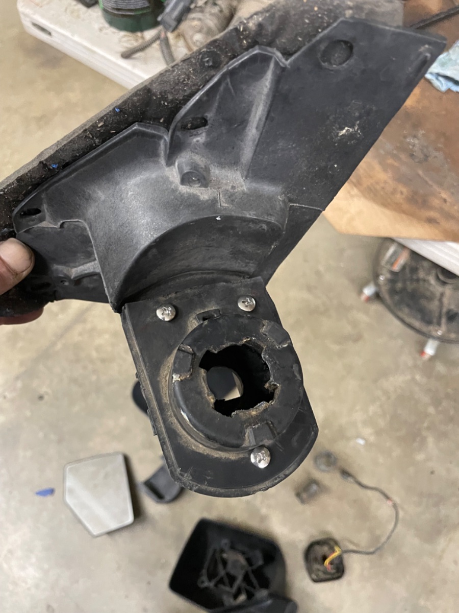

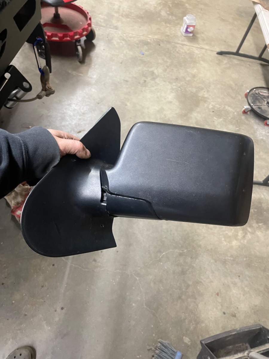

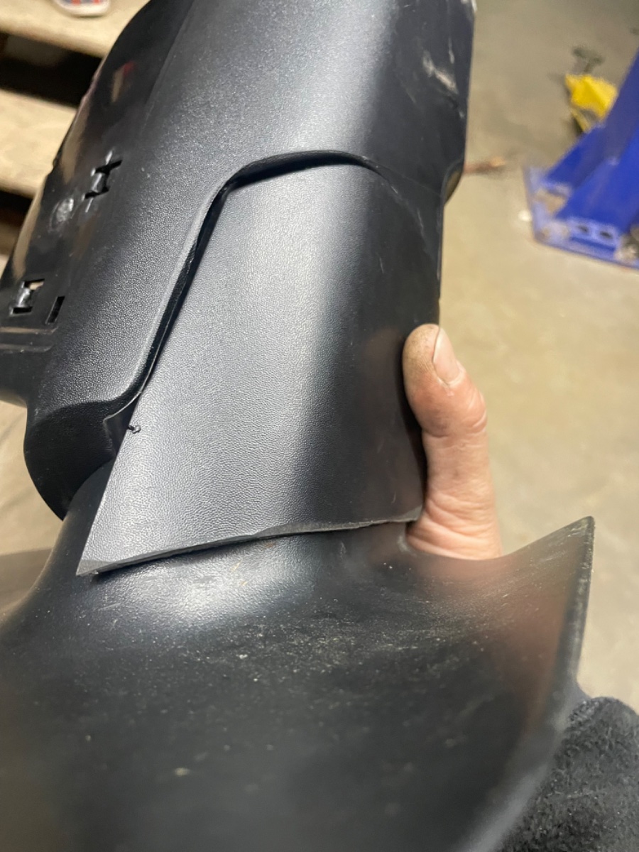

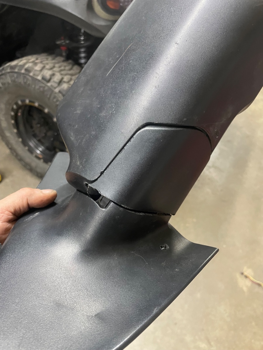

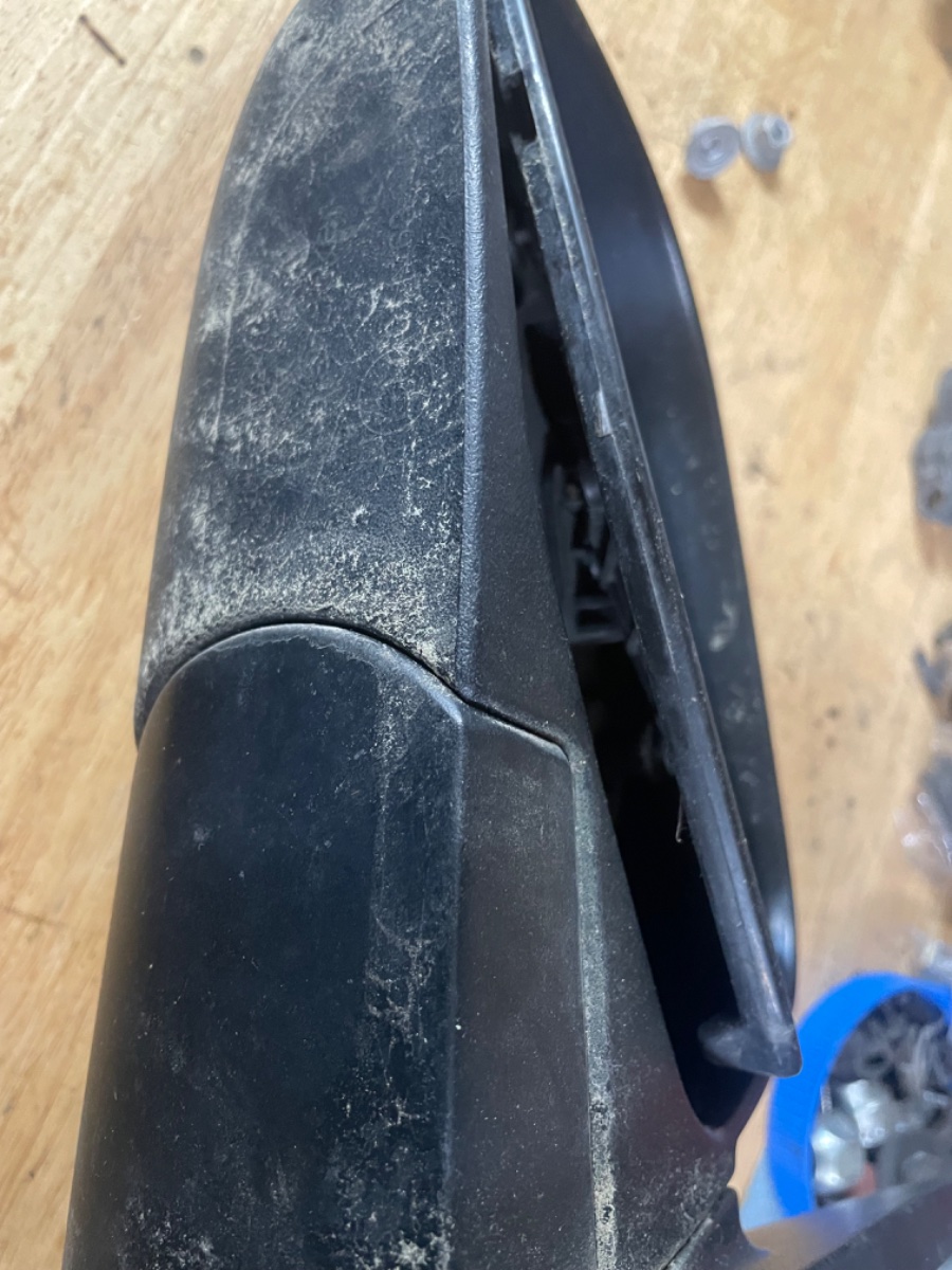

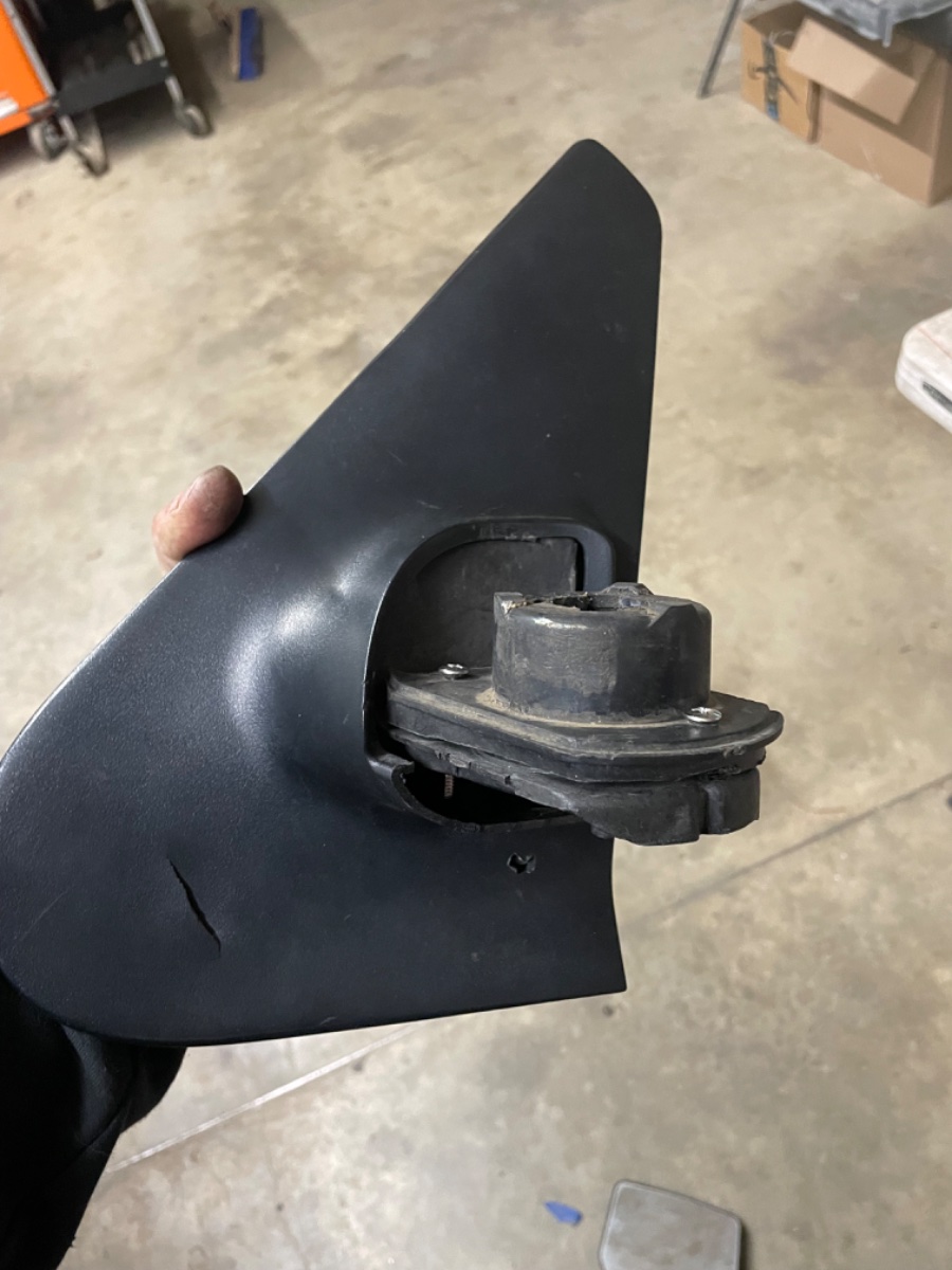

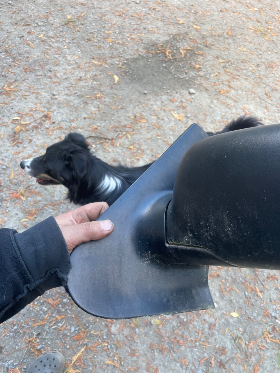

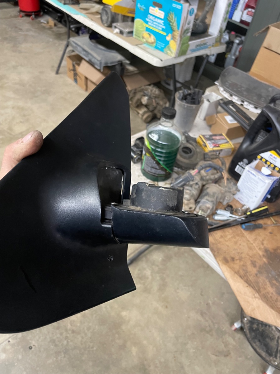

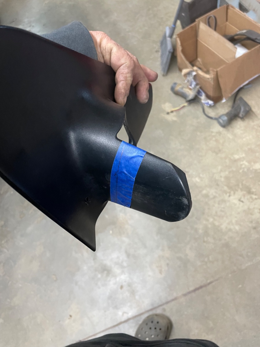

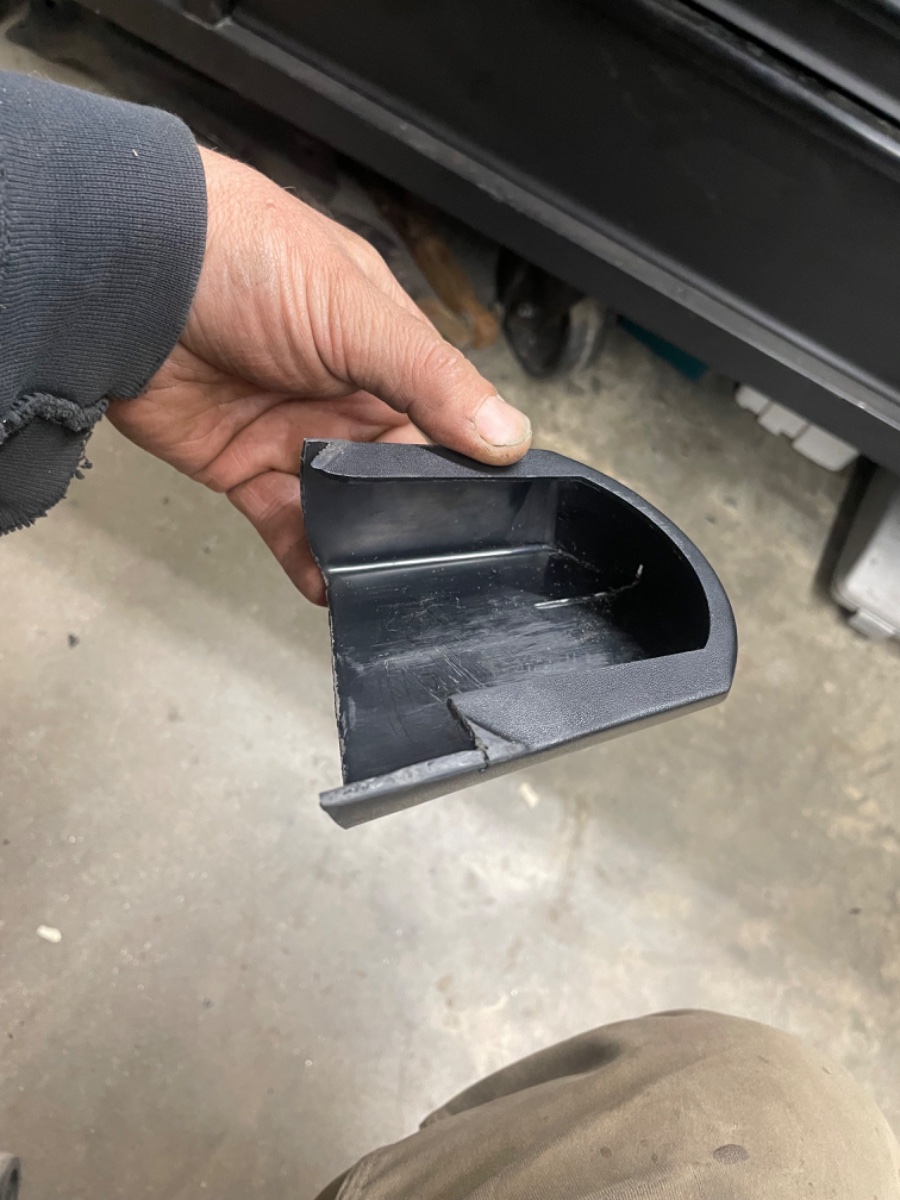

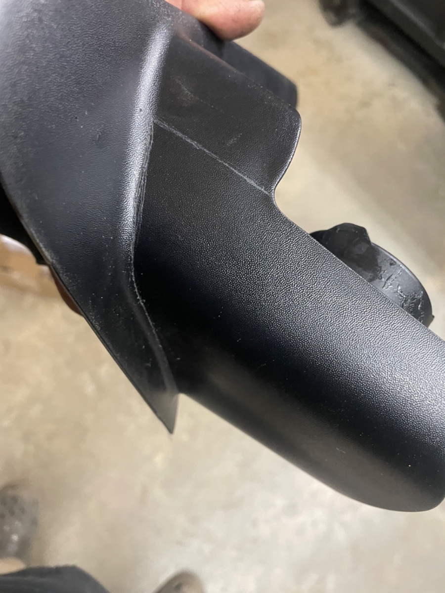

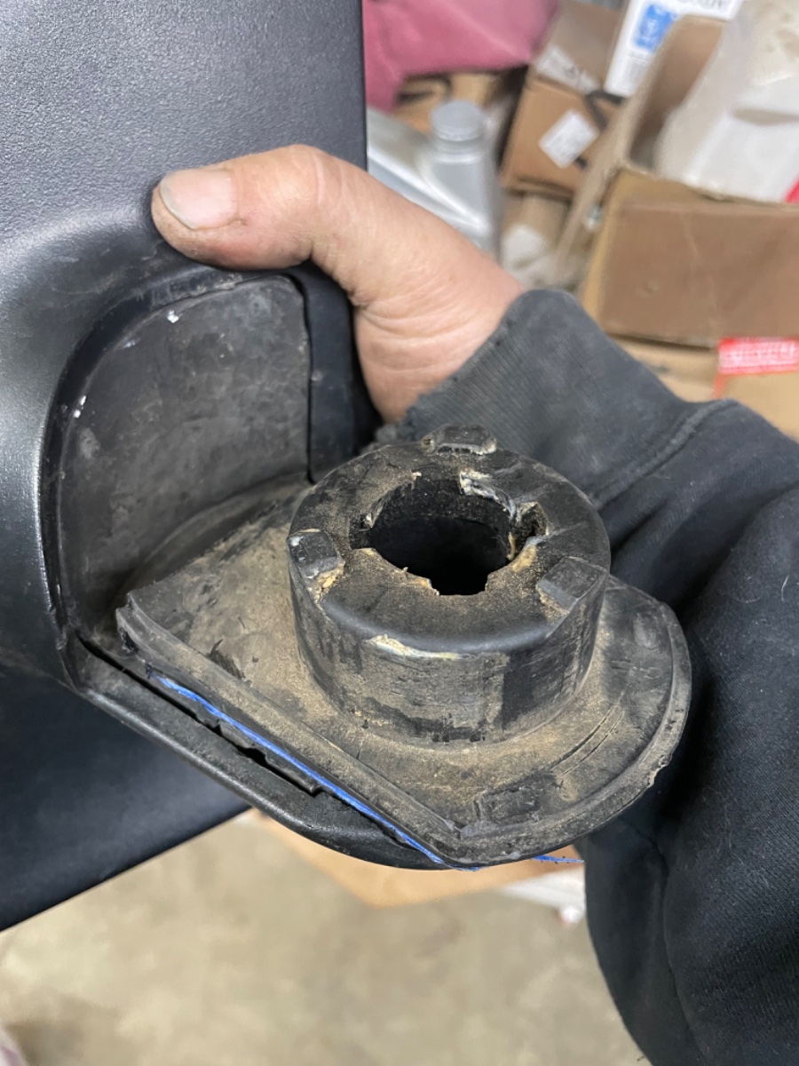

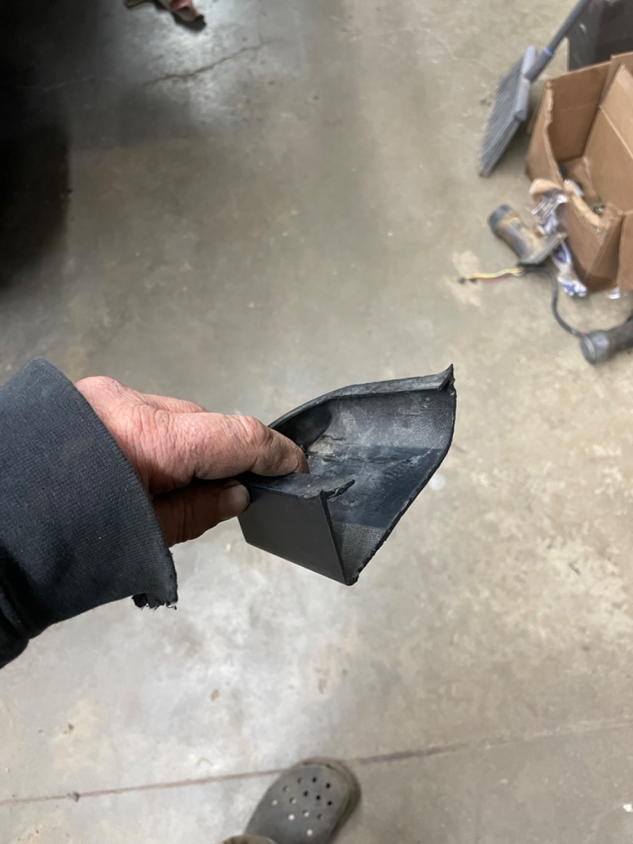

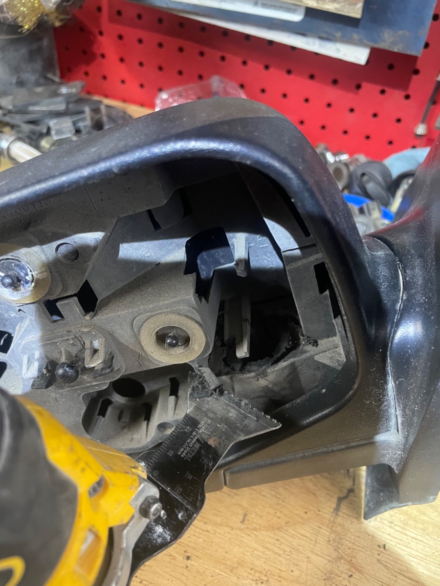

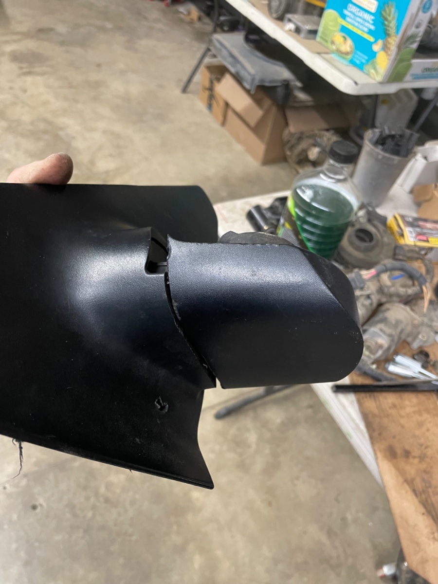

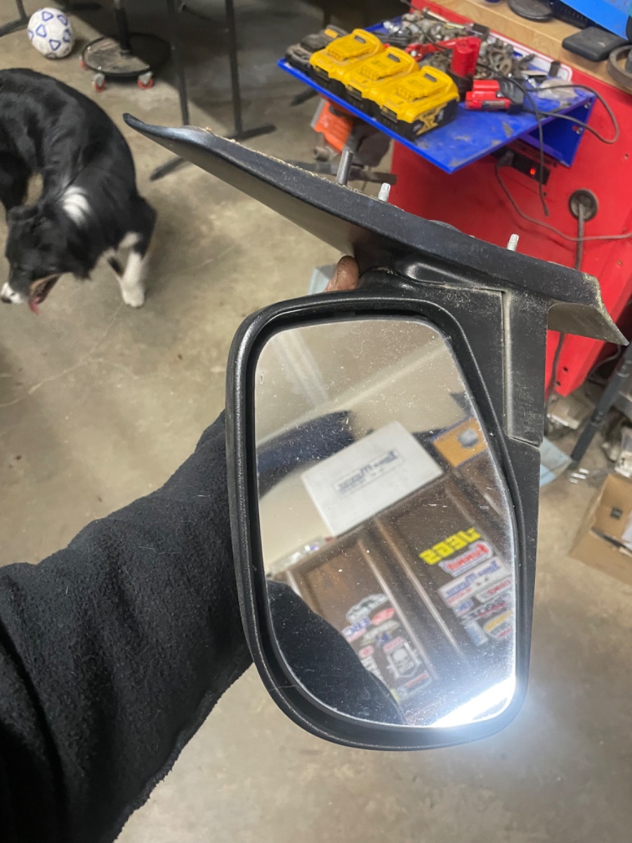

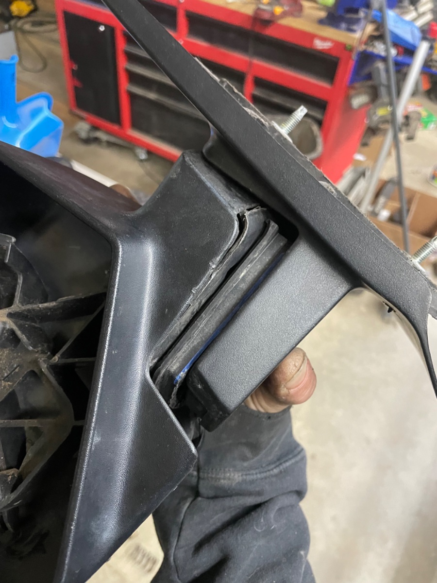

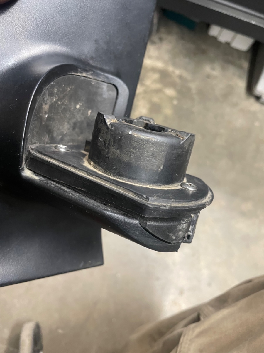

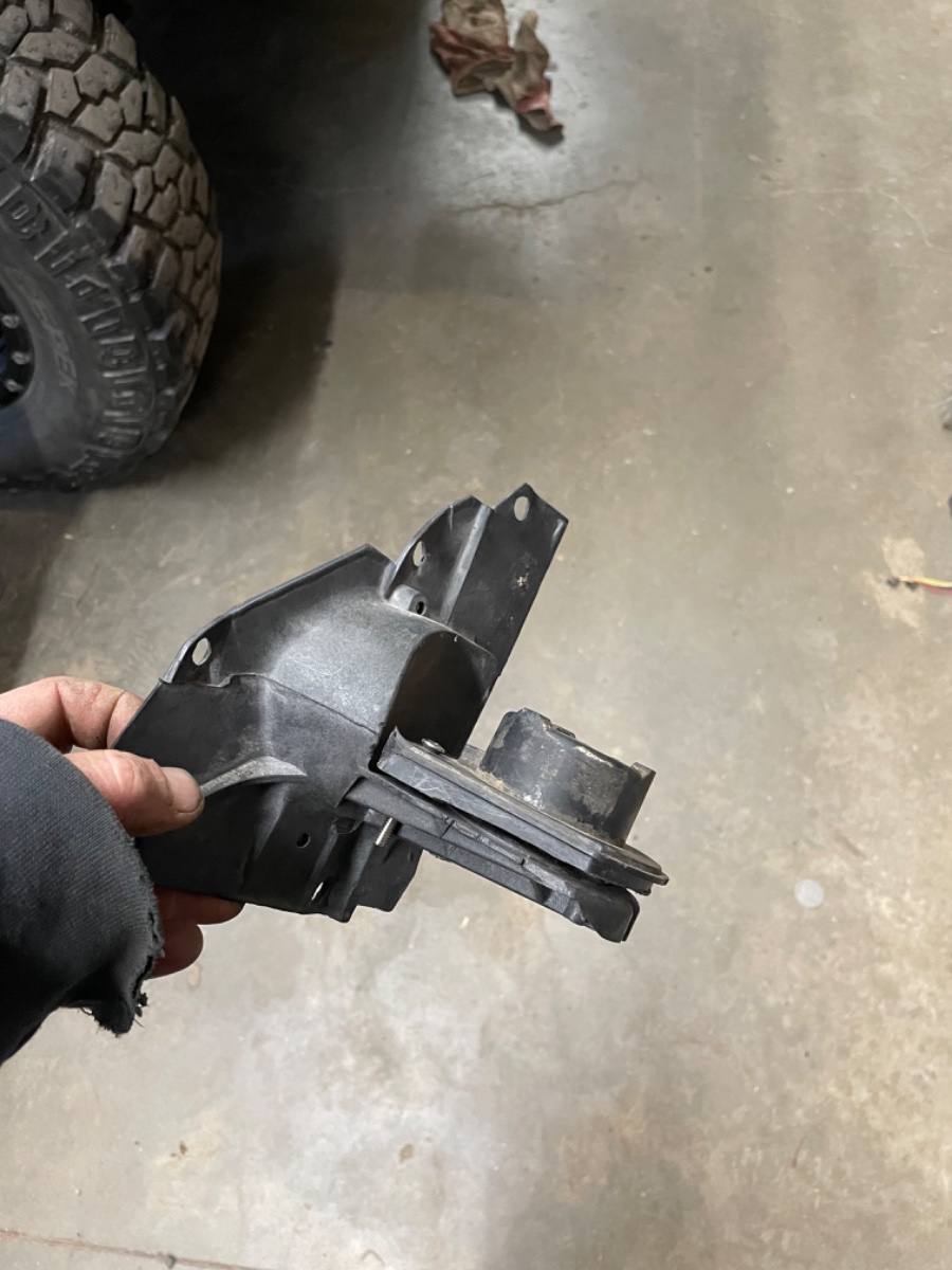

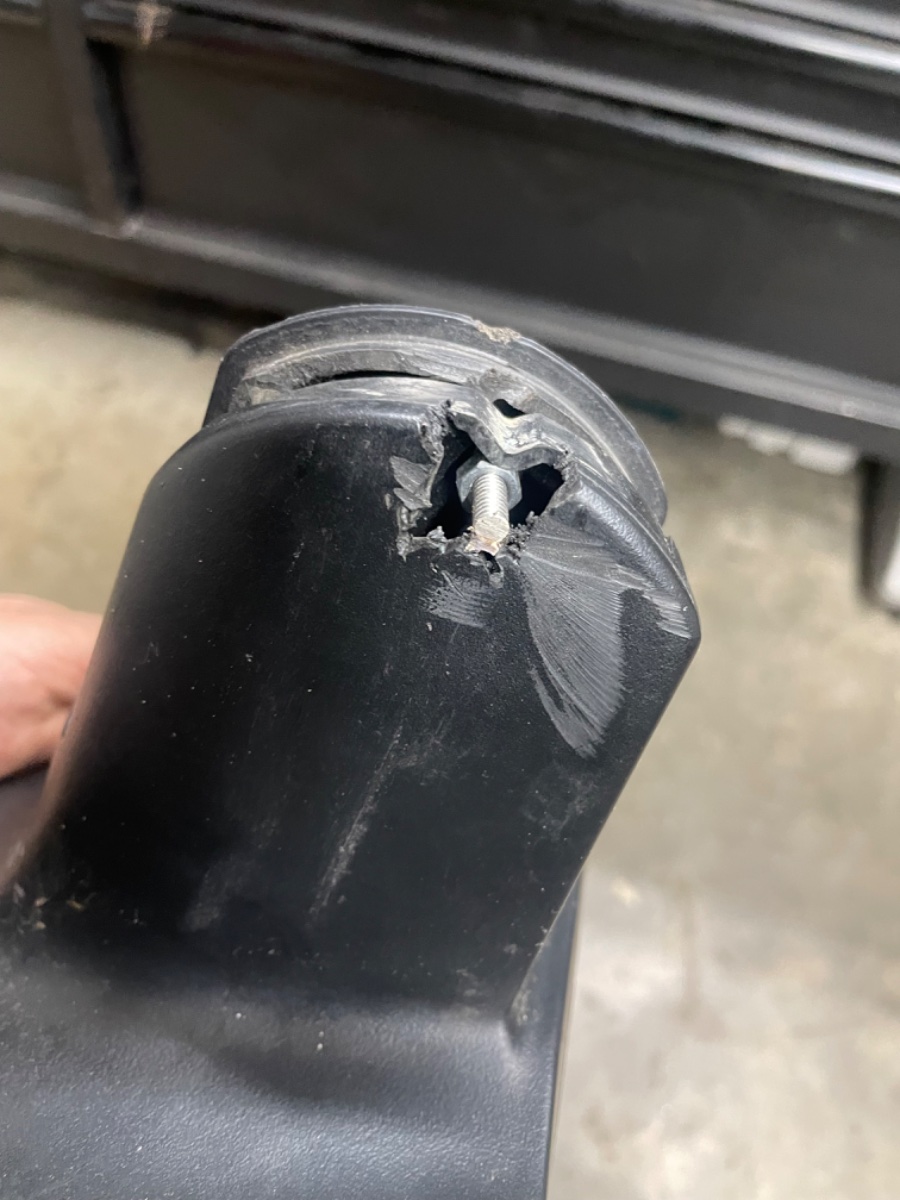

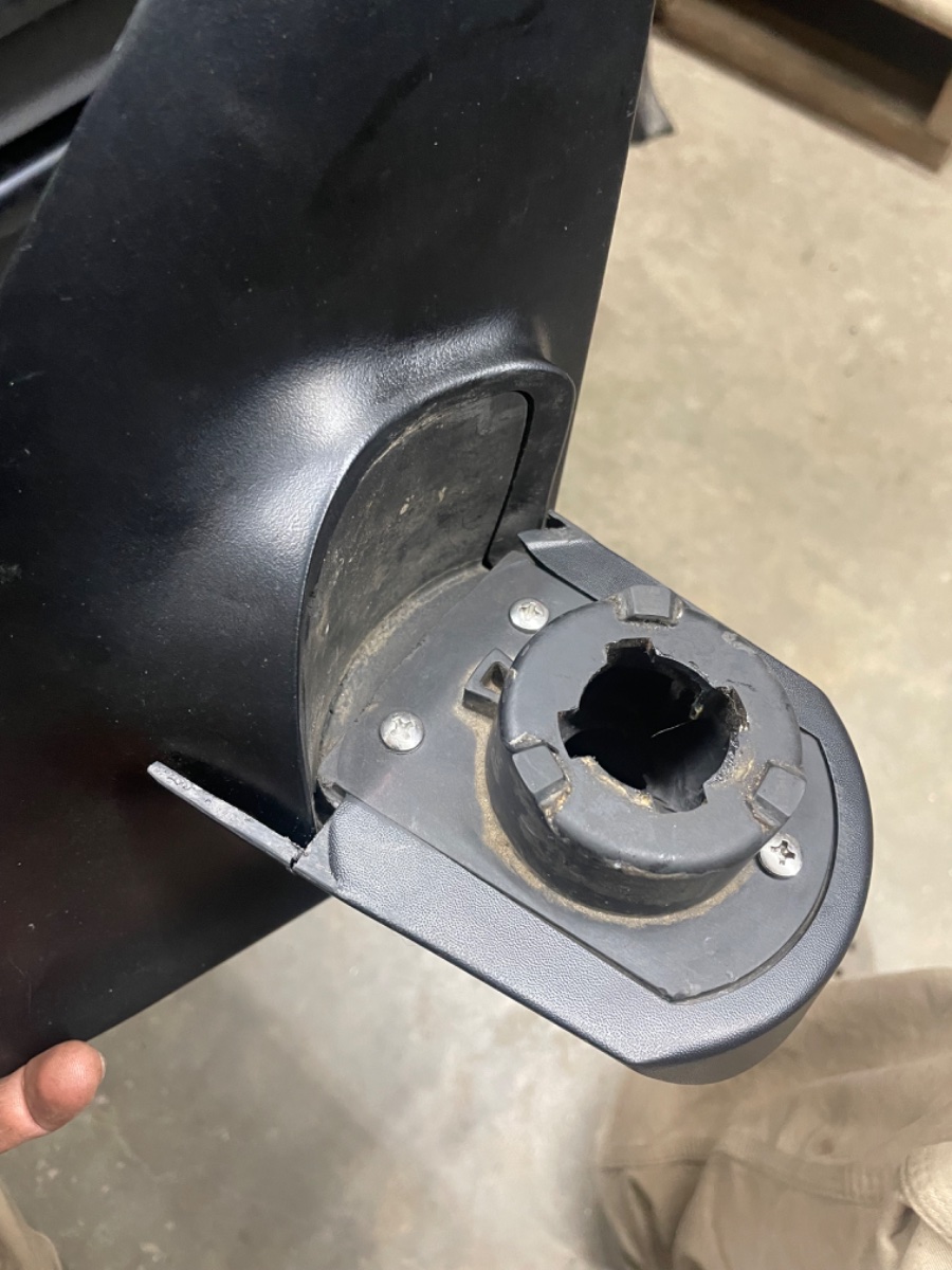

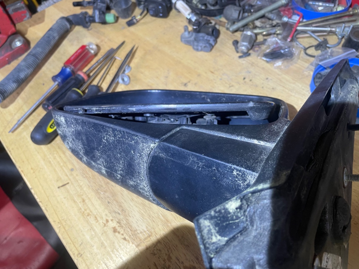

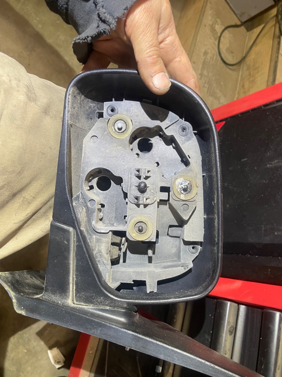

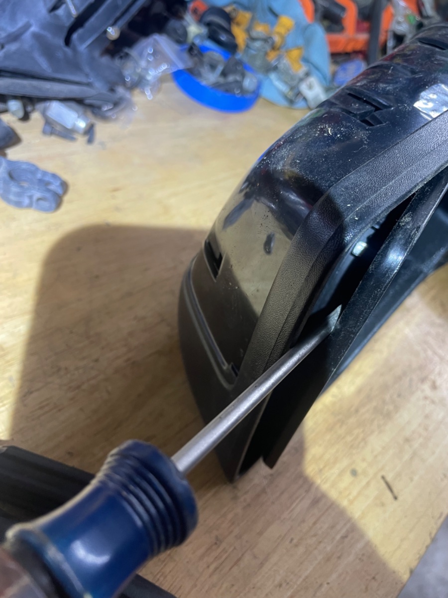

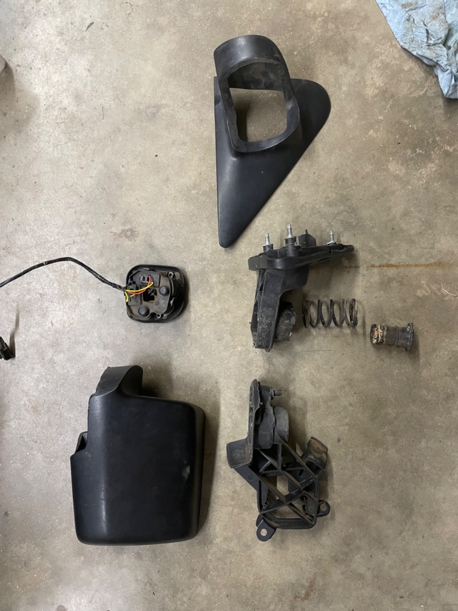

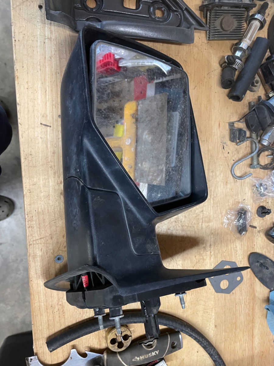

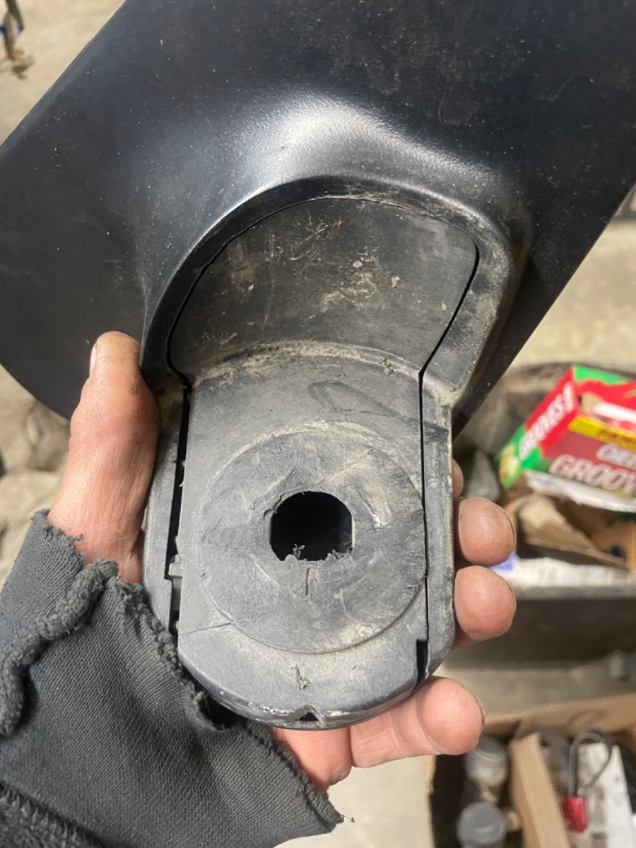

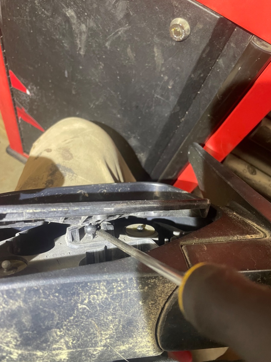

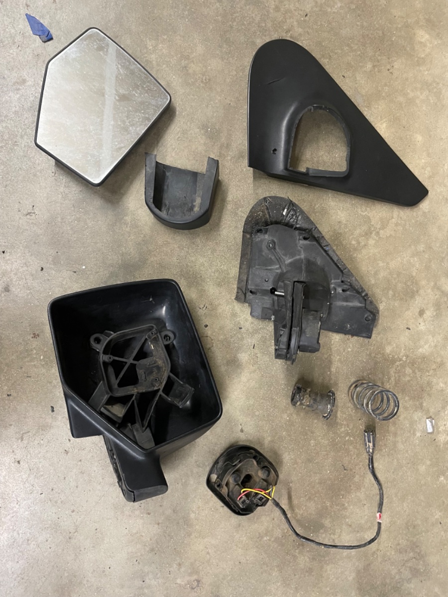

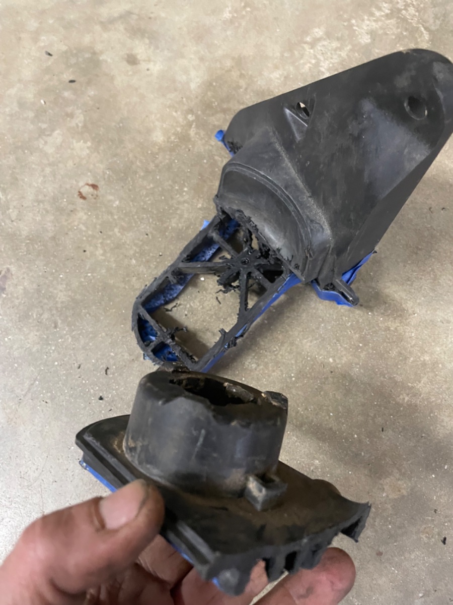

Many hours of tinkering (okay 3) went into this prototype. First hour spent just figuring out how to get the 06 ranger mirror to separate from its base.

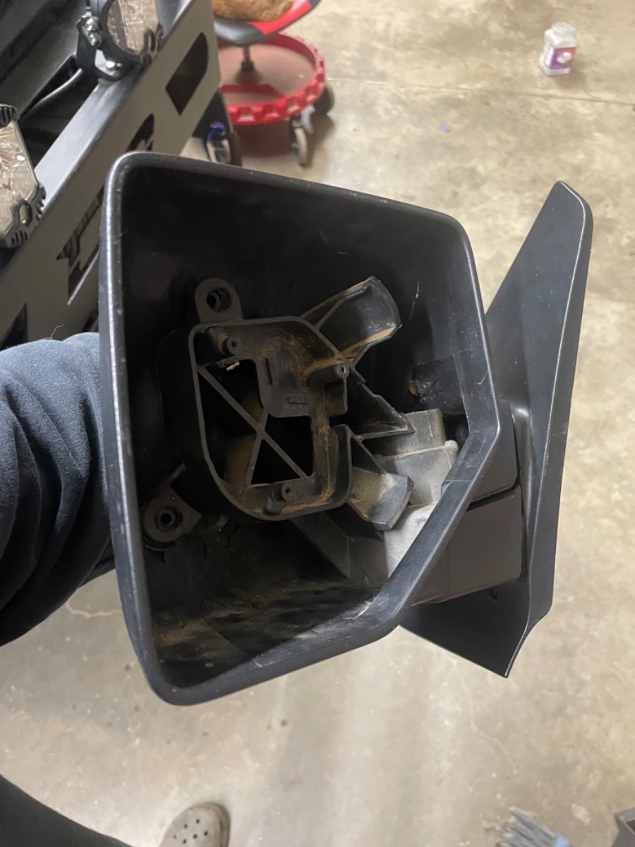

I looked at every option, hack and slash is the only way to make this work

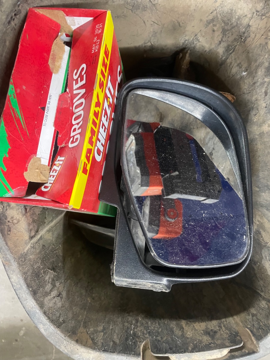

Now to get the good ones out. I have one more set of trac mirrors and one new set of 06 ranger mirrors. The muth turn signal and heated glass is $220
Once i have built the housings and have success I will order the muth kit

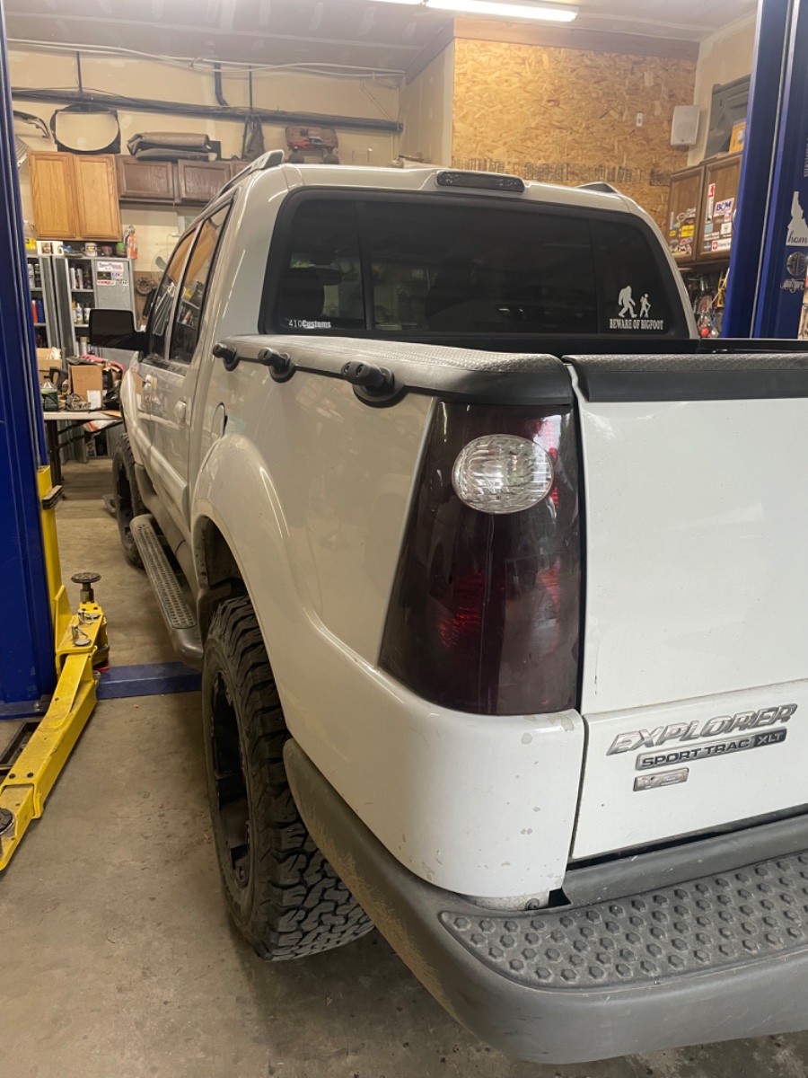

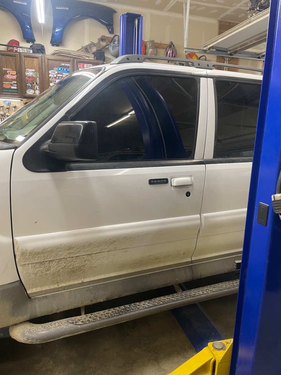

the white one we are driving is amazing rig… but it’s not my forever rig
I have a blue 04 trac just waiting for my attention. I already chose my suspension now I need to choose my drivetrain
