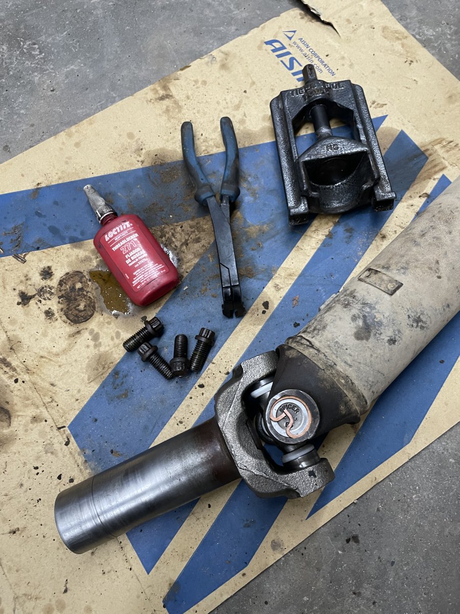

drive it and all is well except new noise in the front drivelines so I changed out the old u joints in the front driveline. They were greasable crappy joints so i installed spicer lifetime
Another week new noise in back…. U joints fried. So I changed the u joints in the rear shaft and visited the rear brakes w new pads and serviced the calipers (slide pins were dry)

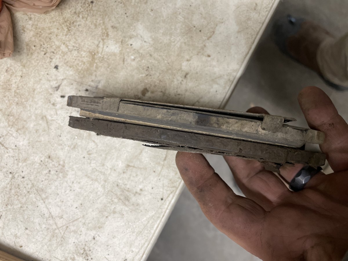

When I put the truck together I re used the brakes and u joints the pads had some life left and the u joints were still tight from the black donor trac. Well greasable u joints just don’t hold up back here not unless I grease them every month and I don’t because we have like 5’trucks and a ton of machines. I love oem u joints no grease zerks they last 150-200k miles so that is what I install. Brake pads are semi
Metallic brake calipers are reman brake best from oreilly. Let’s see how long these hold up

The word of the day is “indicator”
As in wear indicator …
Holy smokes

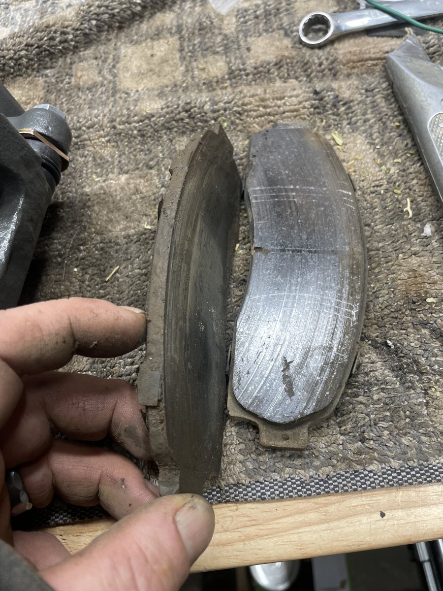

I did learn that when the parts guys says “after something something of 01 or before” I should pay more attention. You see I was buying u joints for a 01 explorer because I know that’s what fits my driveshafts (1330x joint) and so I’m like I better get rear brake pads while I’m here so I have him toss them in the order. Thinking nothing of it actually being an 03 sport trax. So I told the kid “I don’t think it makes a difference” and just grabbed the brake pads
Wrong
The rear calipers have phenolic pistons after 01 and the earlier inner pad won’t fit because the retainer spring is about twice the size…
Whoops back to the store I went more
Humble this time
Now I know! In my head all 95-05 8.8 rear calipers the same! Wrong let’s see if I can remember that in three years when it’s time for rear pads again lol lol
