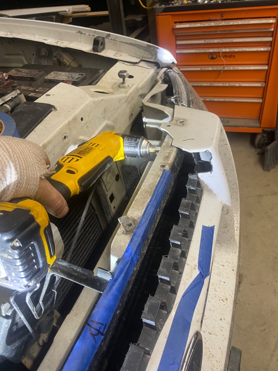

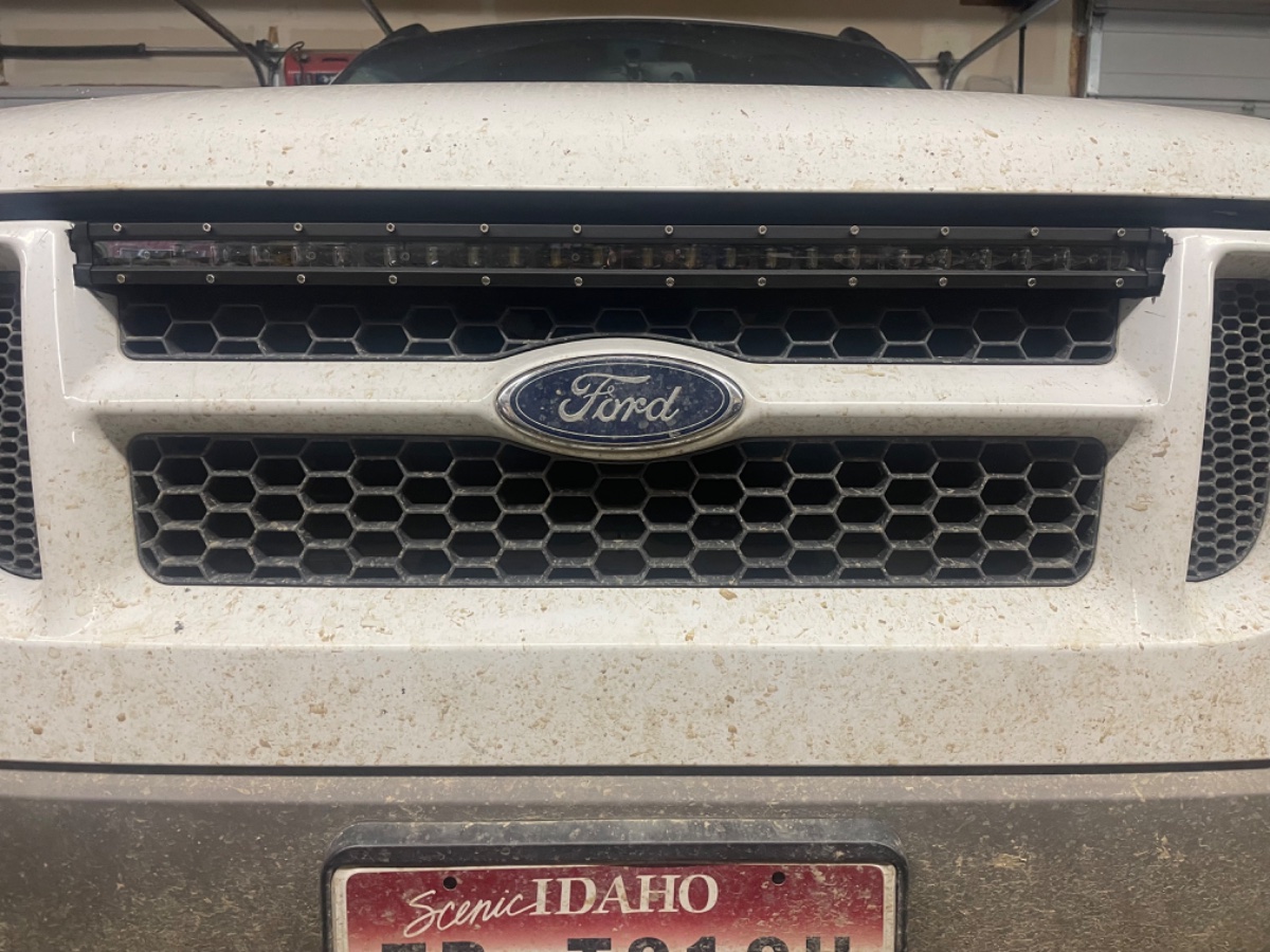

Finished up 26” led bar tuck
This will really help for winter driving back here in the woods
Marked centerline on light and truck

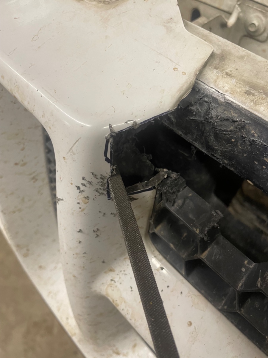

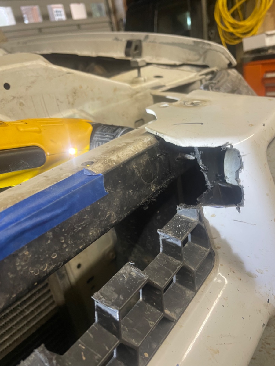

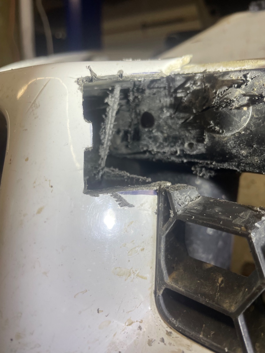

Finishing work w razor and file. Cleaning up the rough cuts I made before
Now I carefully marked the mounting hole locations by marking the locations of the mounts on the truck with sharpie. Then I removed the metal l shaped mounts from side of led bar. And held them in place on the truck. Marked the hole locations and drilled them out first from the front for a pilot hole. Then from the back to size

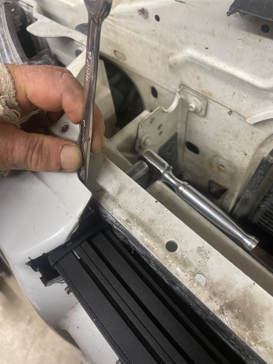

Wrench and socket to tighten bar to drilled header panel
Finished product
The led bar will be wired with new fuse relay and a second factory fog light switch that is already mounted in the custom radio bezel

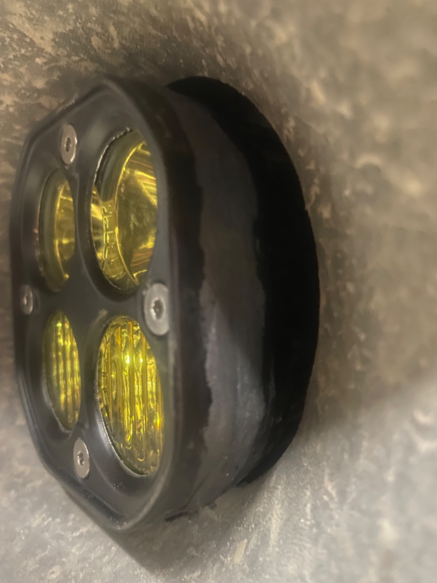

Next I replaced

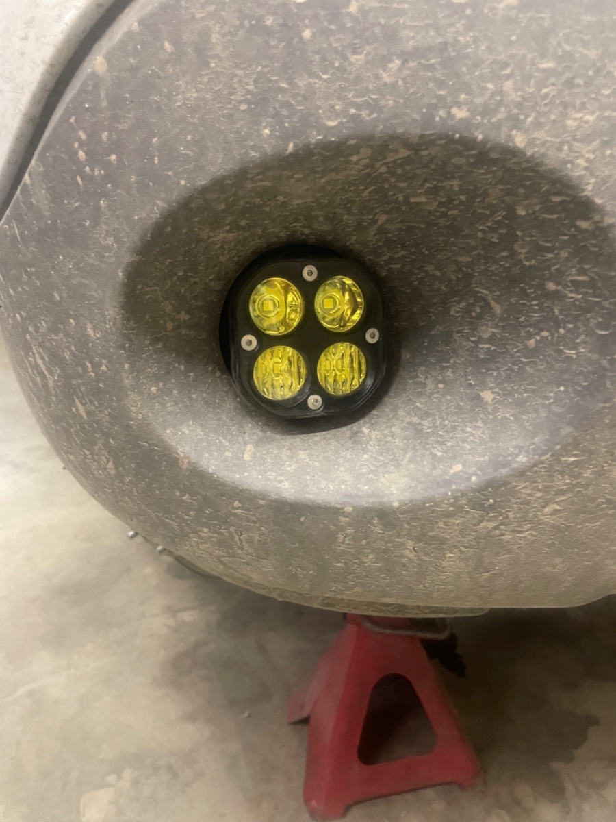

Both led pod lights, the ones I had filled with water
The new ones were dismantled and re sealed with lots of black permatex

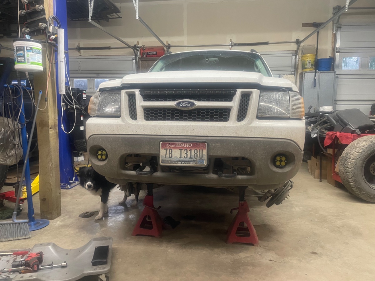

Next I dropped the front differential and rebuilt the custom front driveshaft I have
The new front diff was drained and new axle shaft seals installed
Now the trax has 4wd again and winter lighting
Studded snow tires going on
She’s ready for winter … which is good because it’s almost December

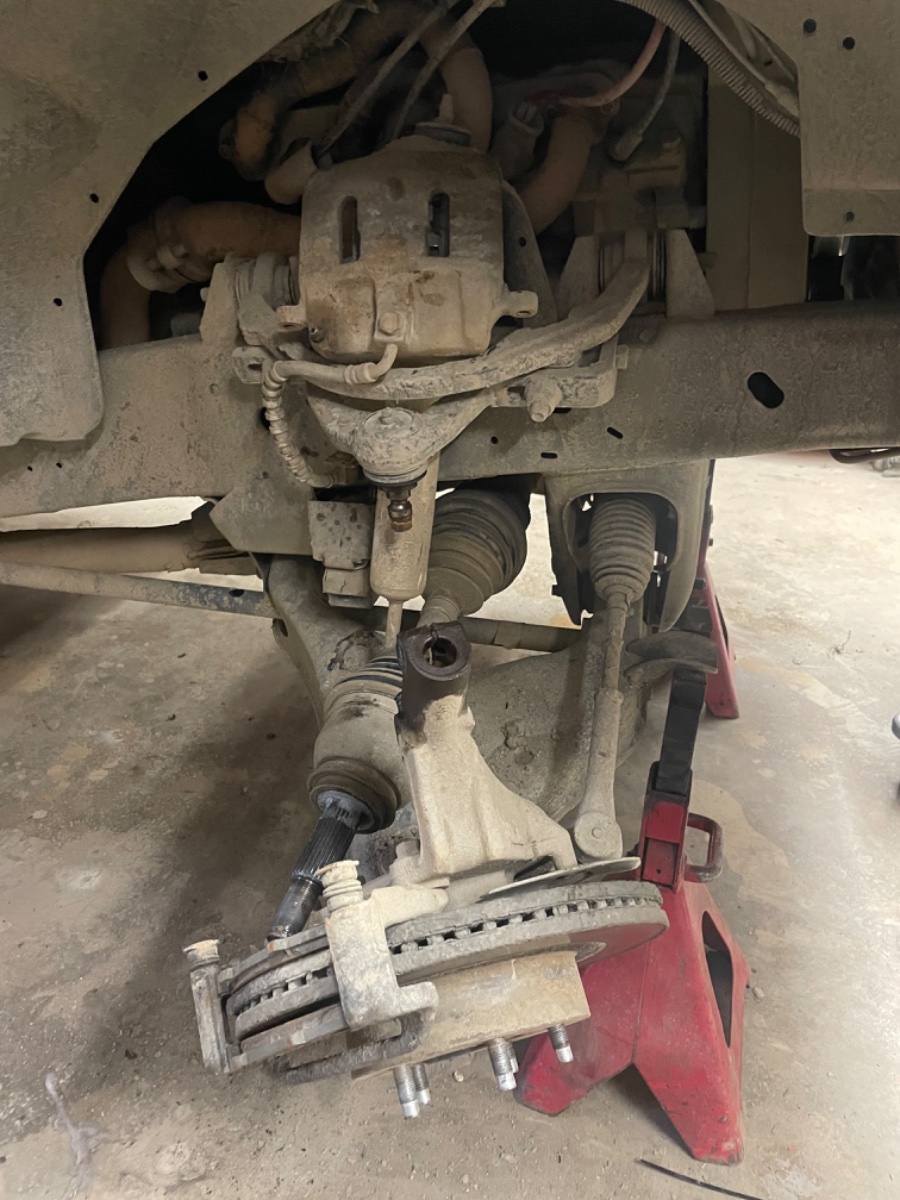

Wheels, calipers, 32mm cv nut, ubj pinch bolt removed
With steering turned and a small pry bar the cv axles can now be removed from Diff
Diff on the ground

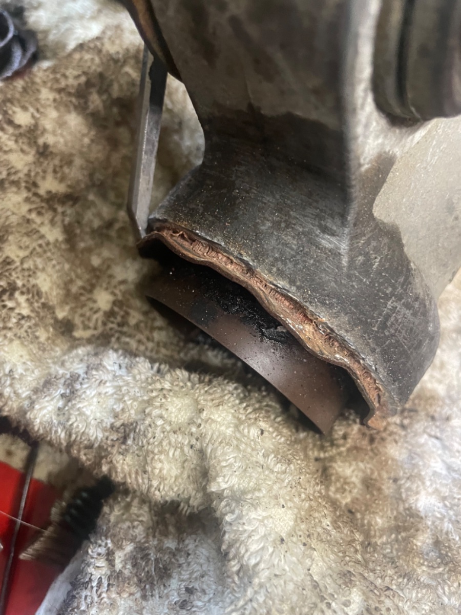

That grey fluid, to me, screams pinion bearing ate itself

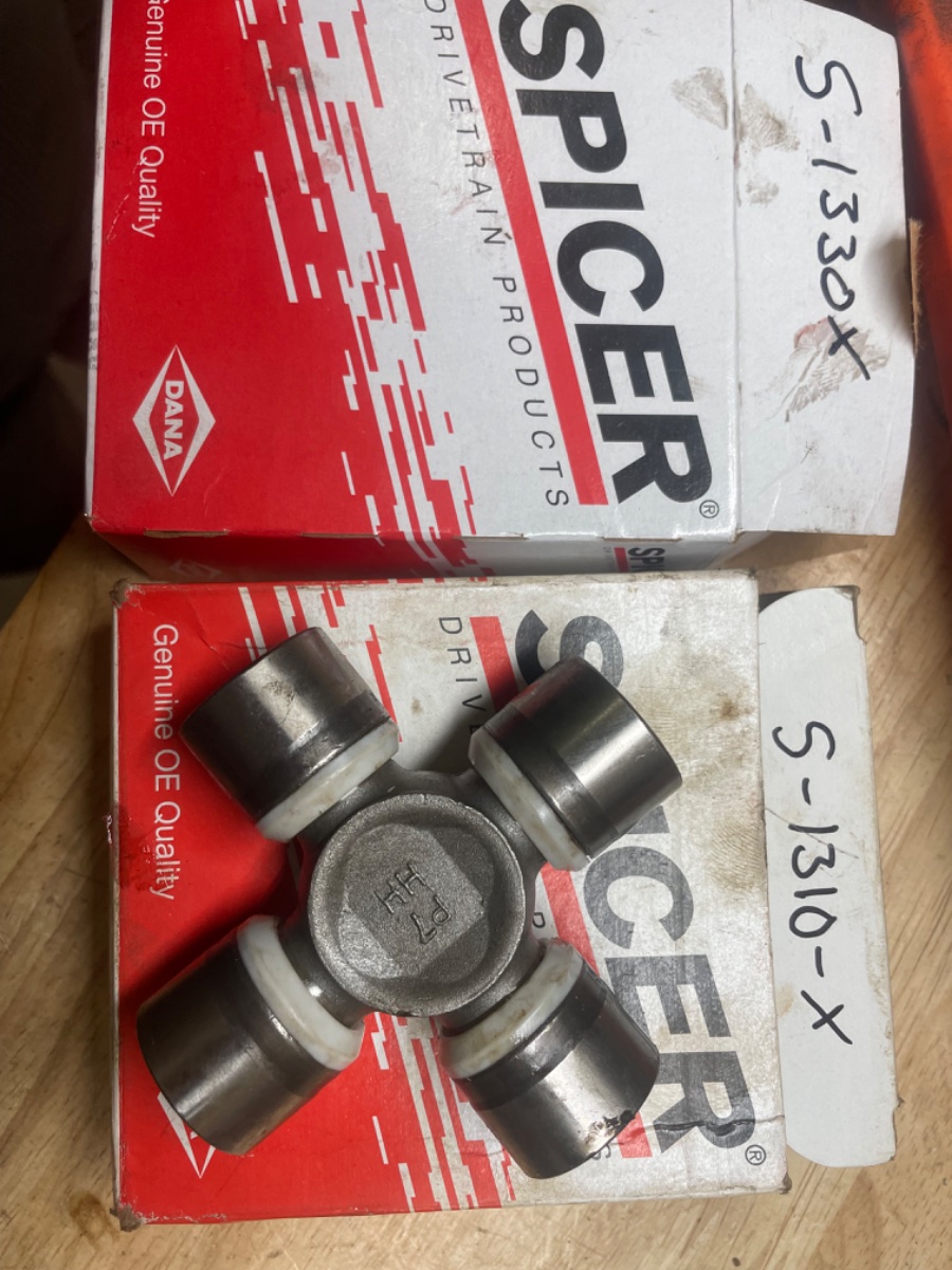

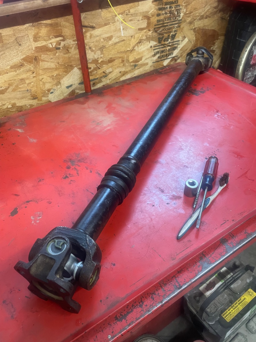

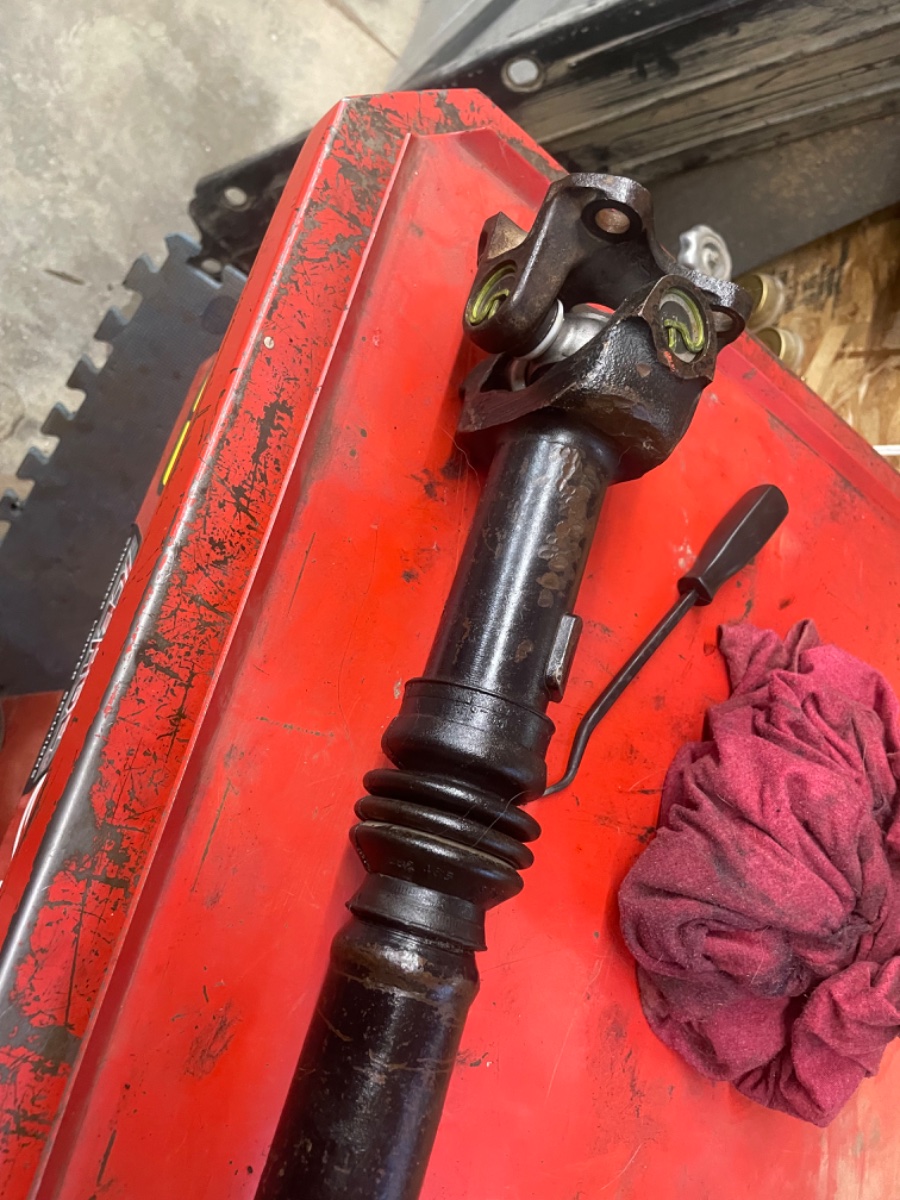

Front driveshaft is custom unit to adapt the 4406 t case to the explorer d35 front pinion
This shaft had slip yoke and uses a 1330 joint at t case and 1310 at diff
Shaft was disassembled, cleaned. Slip yoke lubed and assembled with a new/used boot
New lifetime spicer joints
Great detail on the light bar install. Grey fluid in the diff, never a good sign. But the shiny shimmers, something is starting to die.

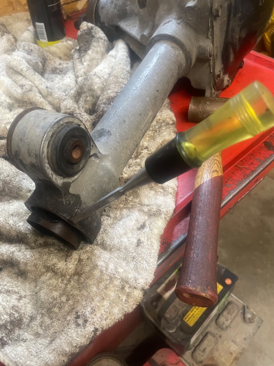

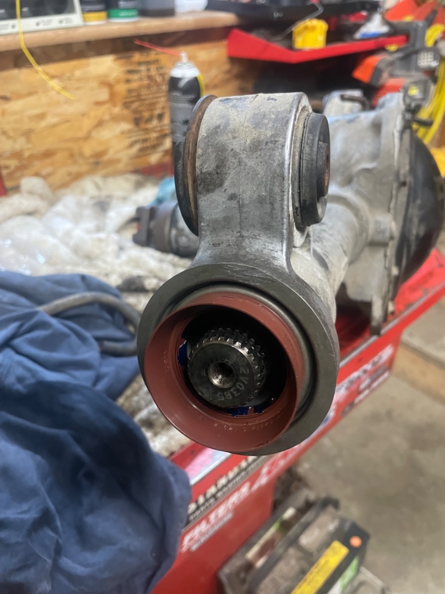

Old seals removed with wood chisel and seal puller
Surfaces cleaned

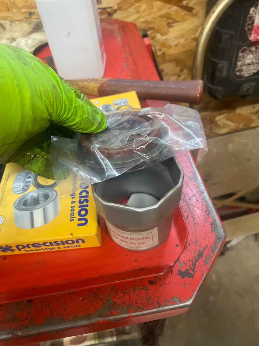

New seals treated to extra flange sealant and driven home with hub socket and brass hammer

Nice, but doesn't your seal puller yank those seals out in one or two whacks? I've had mine for 25+ years and don't recall needing to use a screw driver or chisel etc, to get any seals to come out. The two outer axle seals are very big and tough to deal with, but I think I've had little trouble with those either.

Yes seal puller will get them but I’m working with one arm, my wrist is healing
So I have to do things a little diff whacking the seal puller wasn’t in the cards
The chisel method can be done in the vehicle in a pinch as well

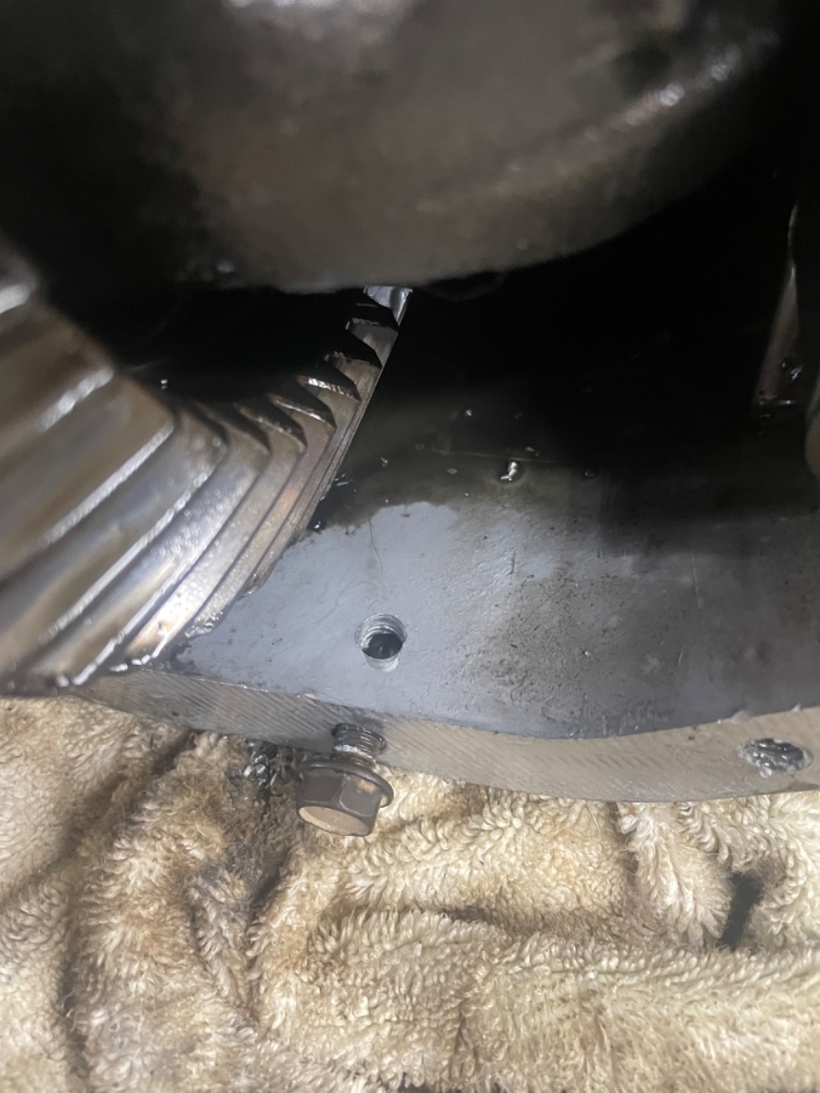

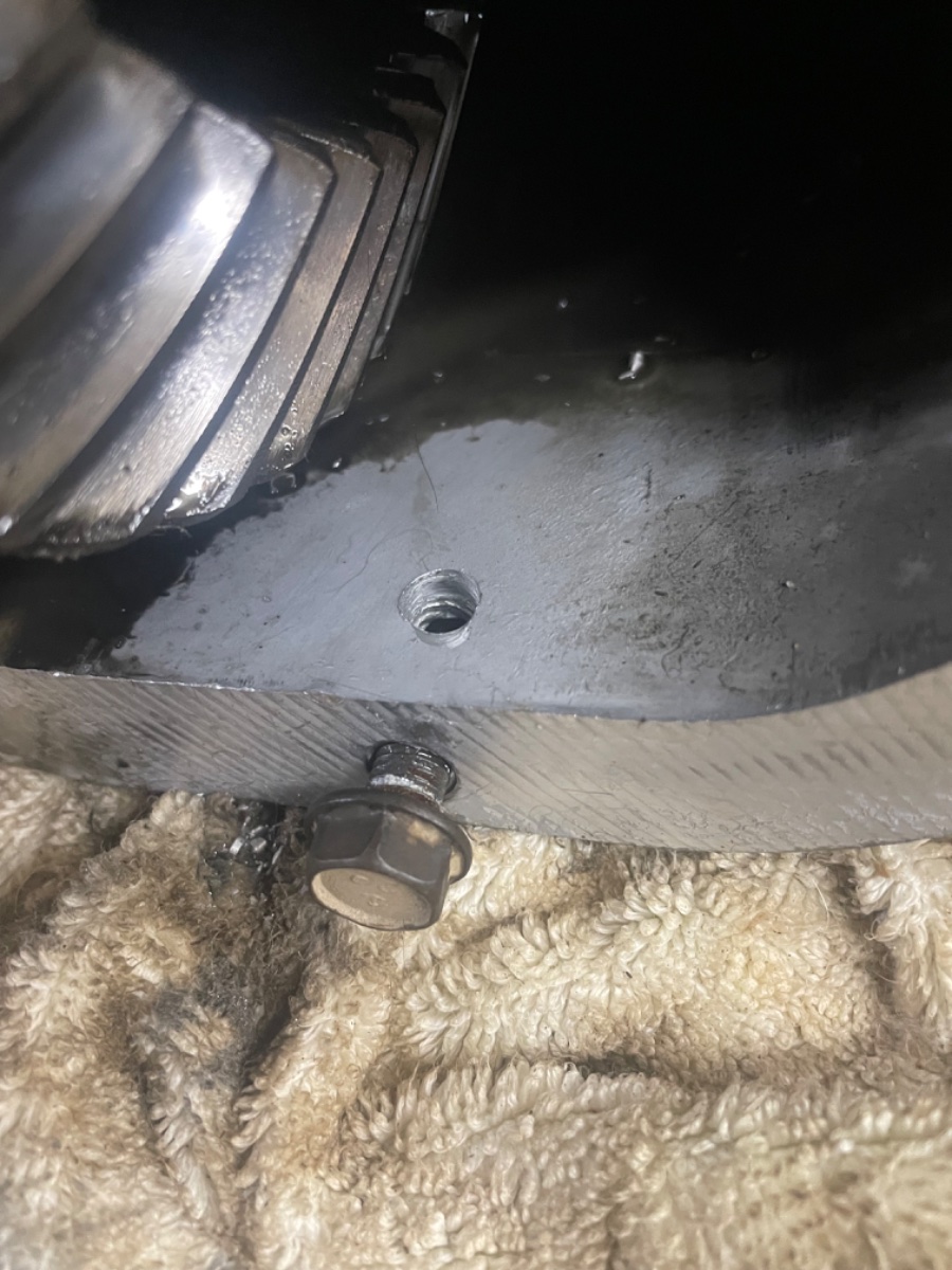

Drill 1/4” hole here and bottom most bolt becomes a drain
Very nice, just what I had in mind for the drain hole. That should be a standard modification of all front diffs.

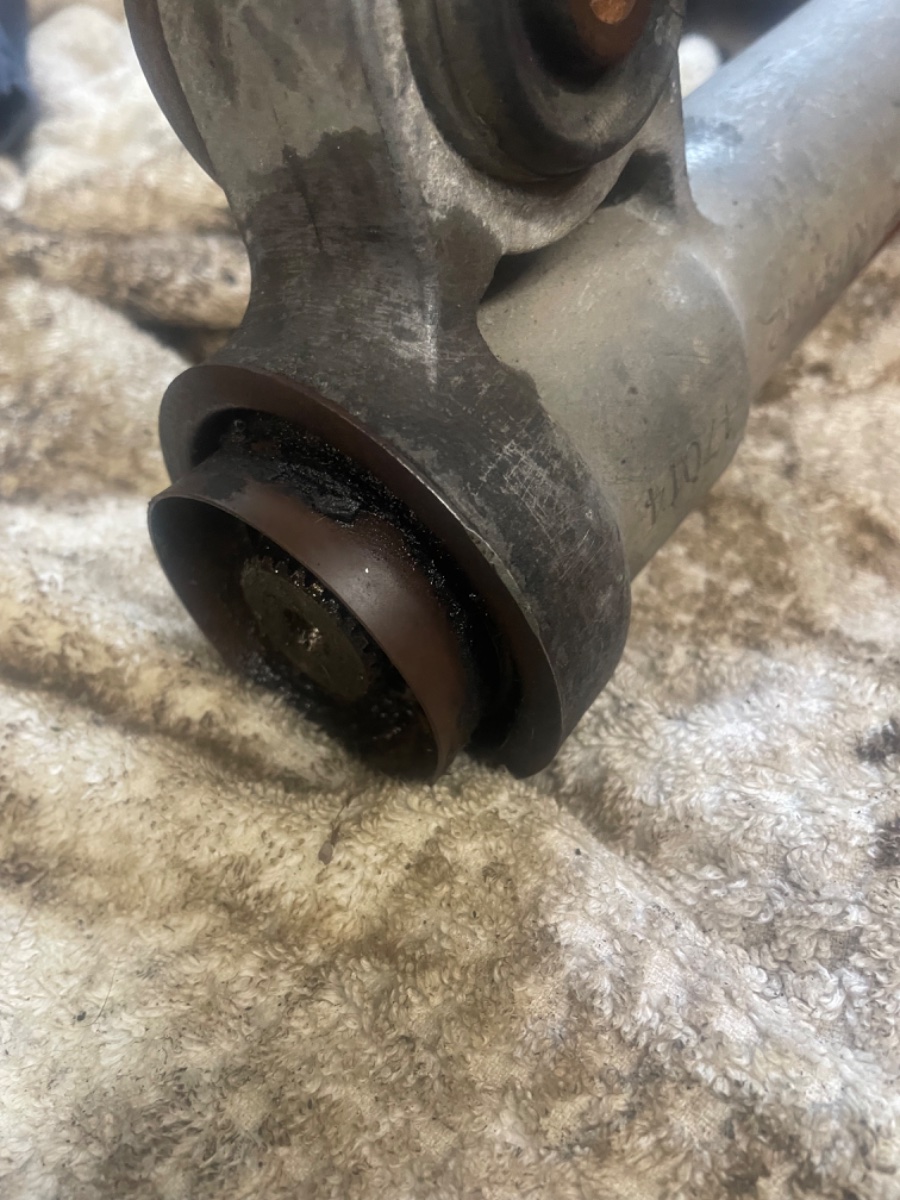

i dont know what locktight they use on those arms, but i almost swear i am going to break the bolts trying to loosen them
Seriously tight! I use my 20v dewalt
Impact that can rip over 1000 ft lbs and it still takes a second… but she gets them out

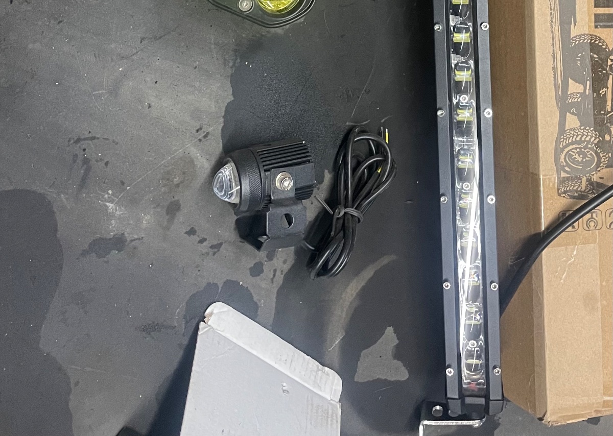

That’s what the yellow lower lights are for. I also have two tiny motorcycle headlights I was going to add… but they have fans in them for cooling, so I decided not to run them because I know those fans won’t last long. Down near the license plate off to either side I was going to add two small lights pointing straight forward… some driving spot lights. I also looked at mounting them in the grill, the little side vertical al grills… was going to cut a small round hole and have them poke through. But there is nothing to mount them to back there… so I abandoned that project for now

Here is where I was going to put these little halogen beams… until I saw the cooling fans. Not worth mounting those fans won’t last a season back here in the wet and wild
One of those two locations
I’ll be looking for a better spot/driving light that can go there
