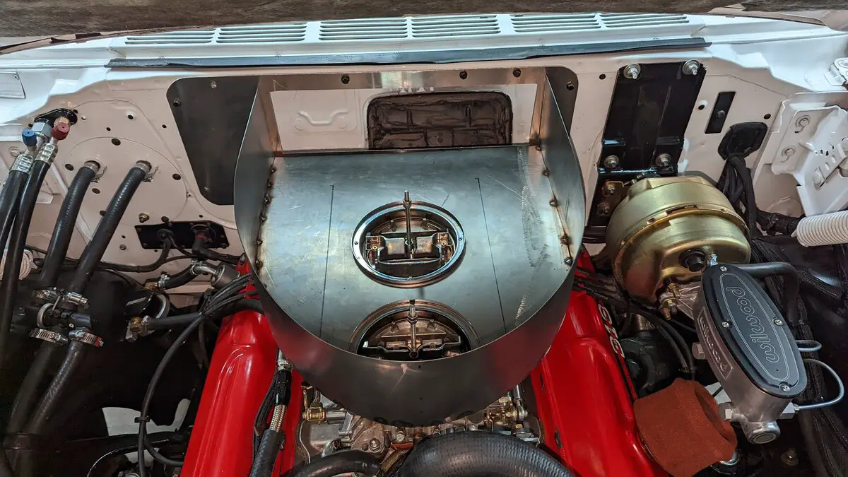

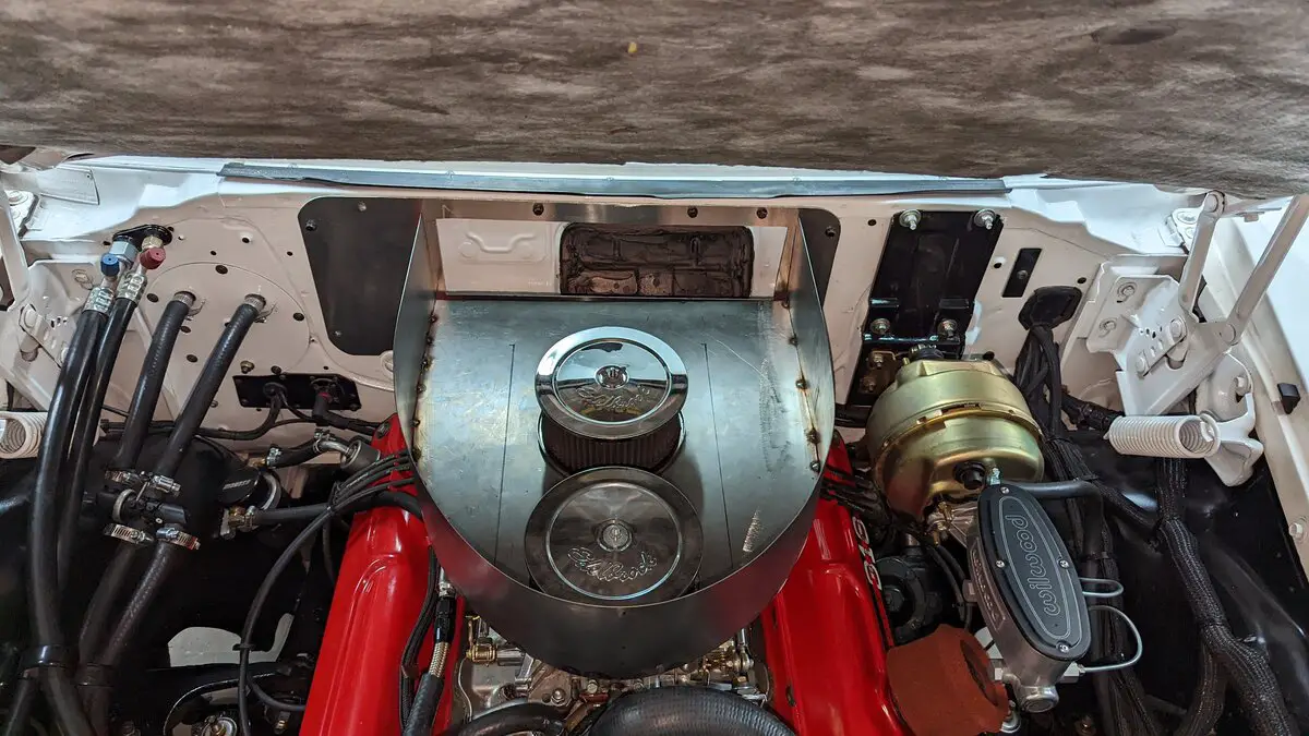

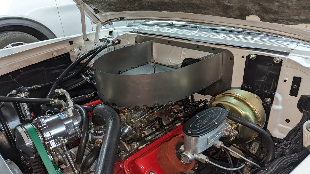

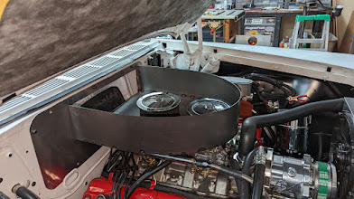

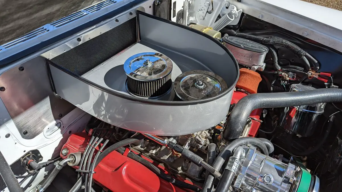

New plan. I'm ditching the VW air filter because the sidewalls of the air pan meets up with the hood insulation perfectly. I will keep the hole in the firewall open and use the two round filters that I have been using all along. The reason for that is to filter out any fiberglass that could be pulled out of the insulation. I'm going to see if I can find a

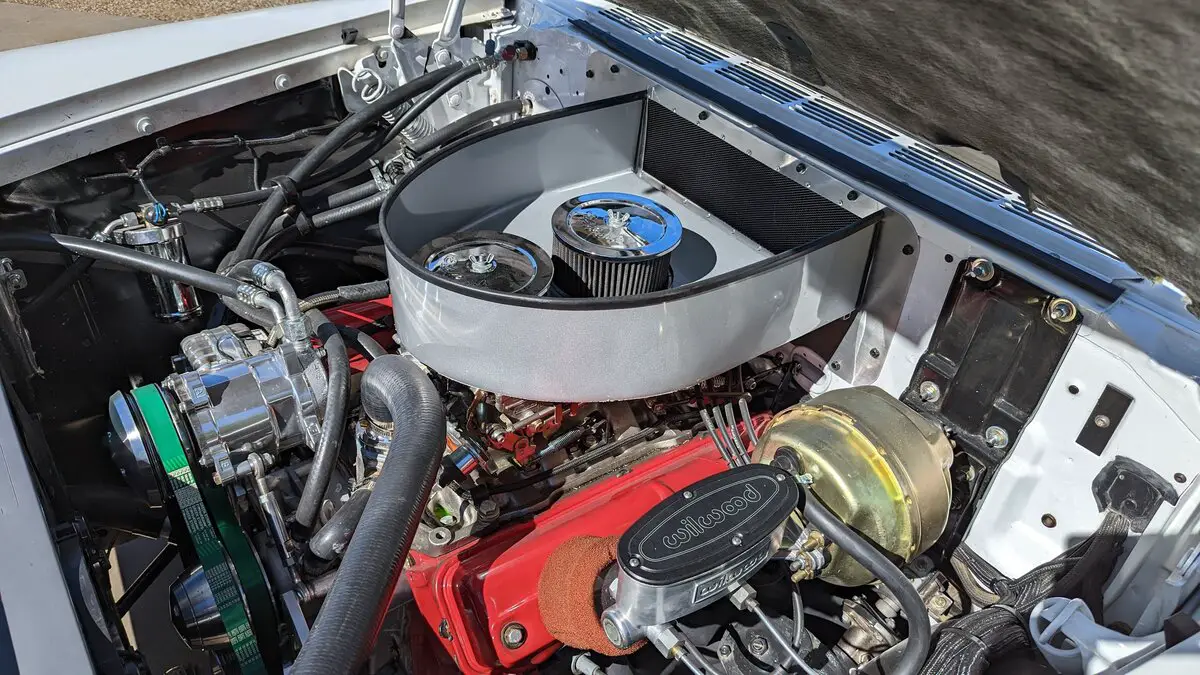

I think I am going to put a stainless steel mesh screen, something with like 1/4" holes in the opening in the firewall for appearance I will also have the air pan coated with a heat reflective powder.
View attachment 432919View attachment 432921
How solid is that mounted between the engine and firewall?
I assume you allowed for engine torque movement and vibration - just can't tell from the pictures.
how does that work when the engine shakes in its mounts? The seal between airbox and firewall is flexible? is there a seal?
just curious, in the pics it looks like you left them disconnected so the engine can move around a little but hard to tell
A top on the "turkey pan" would keep engine heat out of it.
no hood scoop needed the cowl area has a swirl of cool air which is why it is used for the fresh air intake of the HVAC system. In this car it is feeding his air filters...cowl induction is superior!!!!!!!!
No physical connection. I will use rubber Trimlock at the edges and that will be able to move, yet still seal.

It's mild steel. I would love for you to do the work as well, but I hate to think what shipping would cost. If the Cerakote is as good as they say it shouldn't transmit much heat.

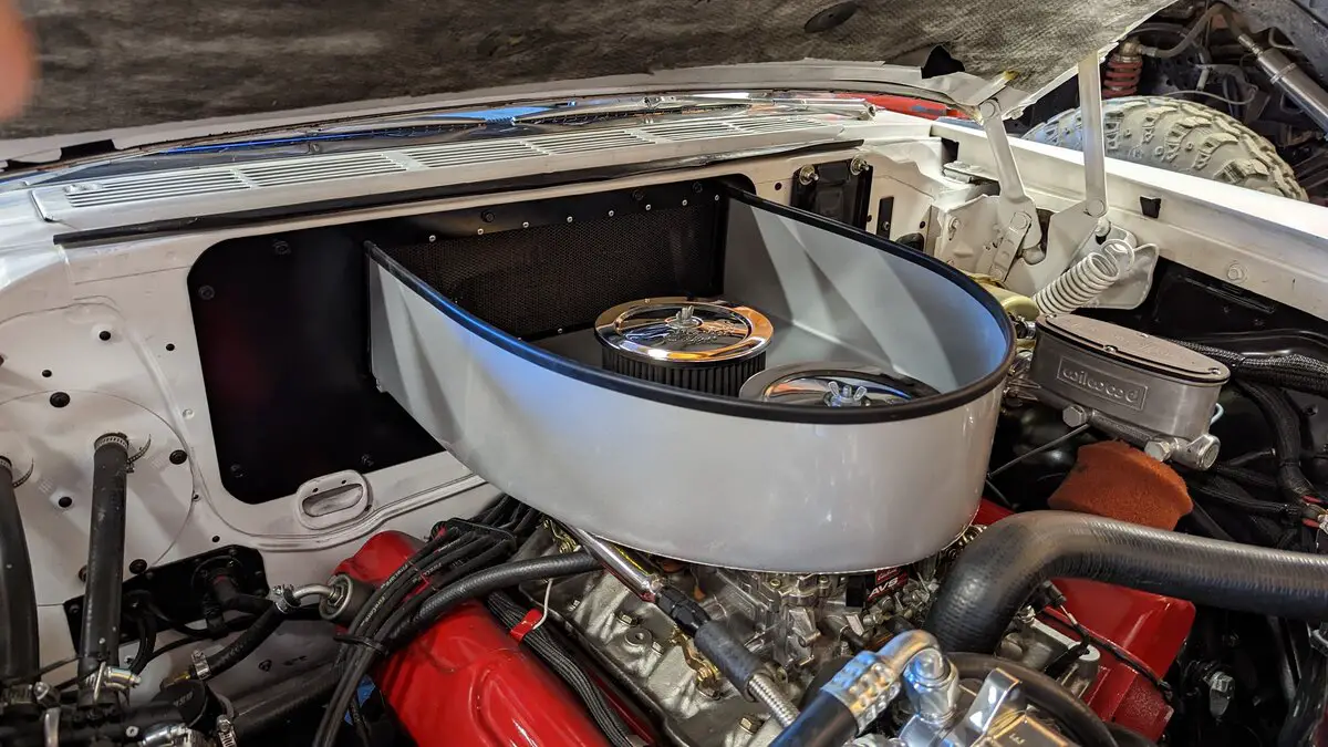

Just got back from a 30 minutes test drive. I opened the hood and heat poured out as usual. The sides of the air pan were hot, the floor was warm, and the chrome lids on the air filters were chilly!!! I will have to do a video with my laser thermometer to show the differences. It didn't take long for the whole mess to get hot from heat soak once the engine was turned off. The heat reflective coating will help with that.
I added a black aluminum screen in place of the air filter in the firewall. It's coarse so it won't be very restrictive. I finished the edges with Trimlock. All that's left is cleaning up the welds and painting everything. The original firewall cover was black so I am going to paint this one black as well. For the air pan I'm thinking silver with flake in it and then have it pinstriped.
The only thing left to do is to paint the aluminum panel on the firewall black.
