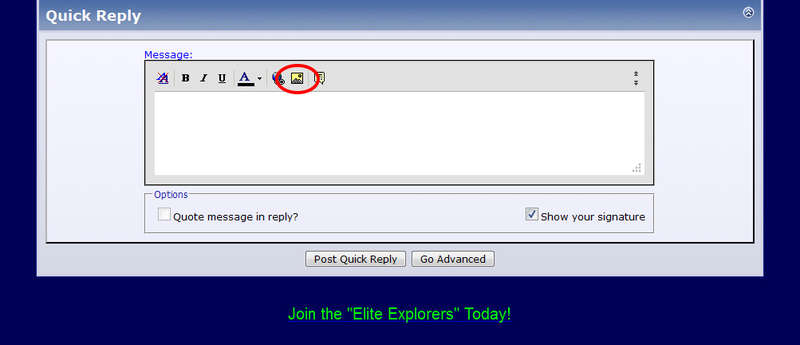

Is there an easier way to upload photos here on this site with Jpgs, and not with URLS/Http://?
..Access is denied to the links you posted..:dunno:
..Use the image tool at the top of the quick reply box..
..Click on it then paste your http/ pic/jpeg ..;)
