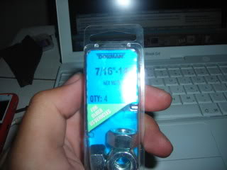

i tried the bushings, but they were too big, and i know i have to sand them down, or whatever, but i didnt have access to anything like that :) so what i used in place of the bushings were three (3) 7/16 hex nuts. fit in there perfect, and the window is working perfect. cost me nothing because i had them in my tool box :D
are these the ones you used?

I am going to do it using the 7/16" hex nuts witch i already have,i need to go back up there to buy a 1/2 inch drill bit anyways,ill ask them.Im really hoping that when i try all of this it works,i feel confident that i should be able to do it,ive just never really done anything like this.Ive been so tierd of having to pull up or push my windows just to get them to go up or down,its very time consuming when you have to do it to all four lol
...I wouldn't use the 7/16 nuts...Within the last few months someone else did this and as commonly occurs, had to buy new motors shortly after...;)

I did my drivers side last sat. It was not bad at all, took me 30 mins from start to finish! The plugs from the parts store are only around $8. They will fit! you just have to make sure they are completly in the rounded corners, line up the cover, and push straight down! It would help to tip one edge of the bushing away from cover as you push down. Also you can cut them with a utility razor knife, the are pliable. Those 7/16 nuts look real big compared to the plugs! :)
