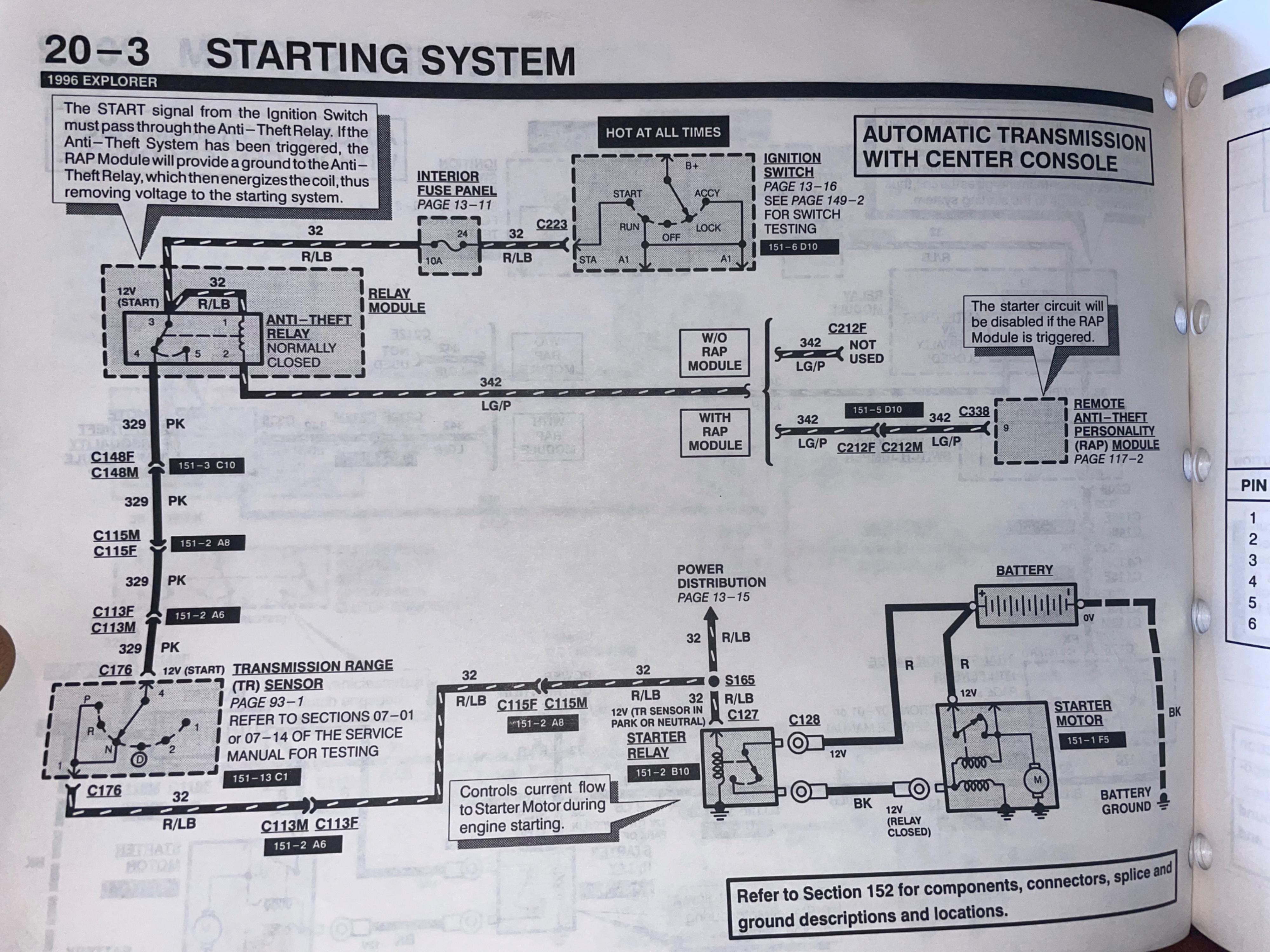

Since we're going back to step 1
You might catch something if you follow that
So basically the little red with blue wire is the ignition switch to starter feed.
With your multimeter you simply need to see if battery power (12v+) makes it to that little red/ blue wire when the key is turned to “start”
My guess,
From what you have said, is that no power is making it to that small post
If it starts easily when you jumper the two large posts then it’s not a wiring issue with the pcm or engine etc

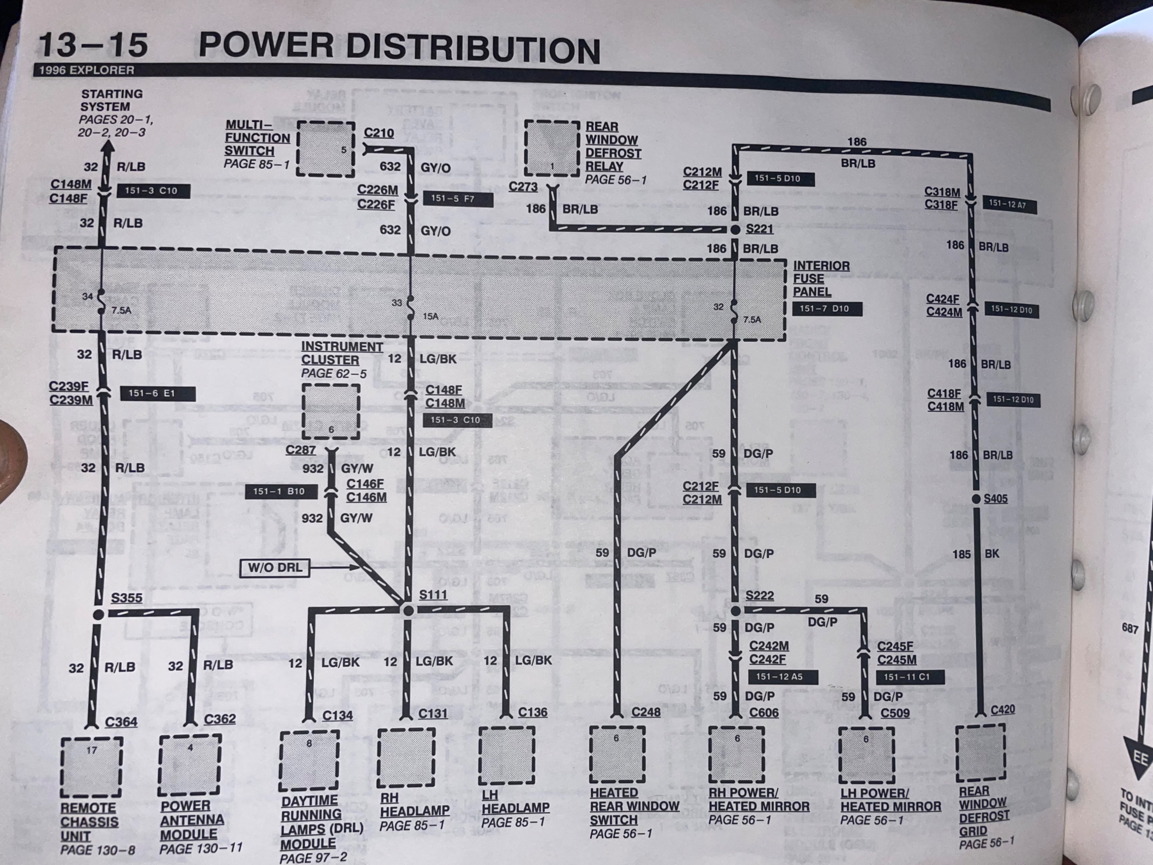

Here is the start system diagram for a 96 explorer
Check fuses 24 and 34 in the interior fuse panel

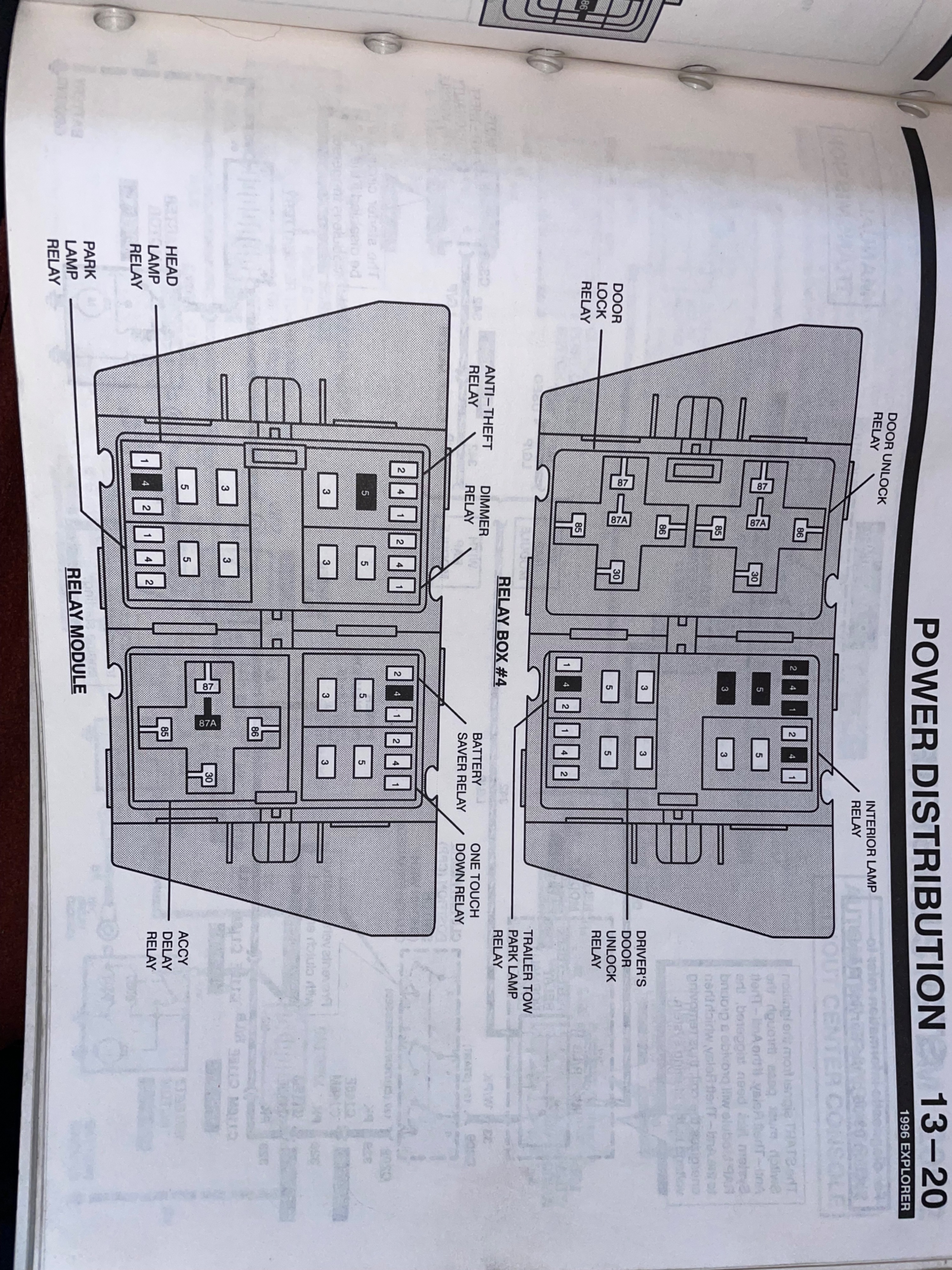

The anti theft relay is also suspect (if your truck has one)
The relay would be located in the auxiliary relay box which is mounted above gas pedal
I just got it, thanks to your wiring diagram 410Fortune. The wire was lose behind the interior fuse 24.
