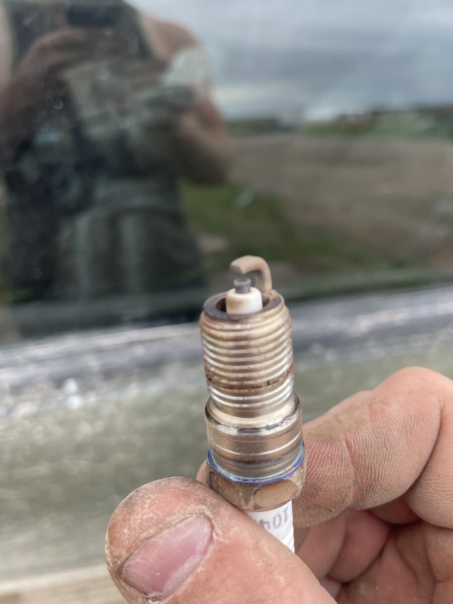

How do the spark plugs look? With the engine running so badly with the many things done, I wonder how they are now. If any of the plugs look rough, wet or black etc, there may be something wrong with the gaps, coil packs, or the plug wires themselves. The plug wires are easy to damage when pulling them off, old or new.
If one or a few of the plugs look bad, you may have to replace them, or the wires, or all of them, depending on how they are. I'd pull the plugs and carefully inspect each one, and the wires, documenting the condition, don't mix them up, and consider why any would be fouled etc.

I think I've checked both of those a couple times. I pulled all the plugs and gapped them yesterday. 6 of them looked exactly like this, 2 on the passenger side looked different. One was more brownish like it's supposed to be and one them was black 1/3 of the way around looked partially oil fouled.
After messing with the plugs it now was a tick and misses really bad at idle so I'm gonna order a set of motor craft wires not these crappy densos. I have a new maf coming to rule that out although I already tested the voltage output on this one and it looked normal.
Messing with the plugs and wires the miss got worse!
One plug is black with oil, this points to possible valve seal problem which these engines are known for at higher

New wires did not help. The rain came and I had a chance to look at it today. The 2nd spark plug back on the drivers side had a broken ceramic (the one that's kinda hard to reach behind the shock tower.). I replaced it with a similar plug I had on hand, added some fresh gas (tank was almost empty and I had put some howes diesel conditioner (??) in the gas thinking (and still do) that I might have a sticky or stick injector. (Both plugs I pulled looked way more oil fouled and the howes + low gas level is likely why).
